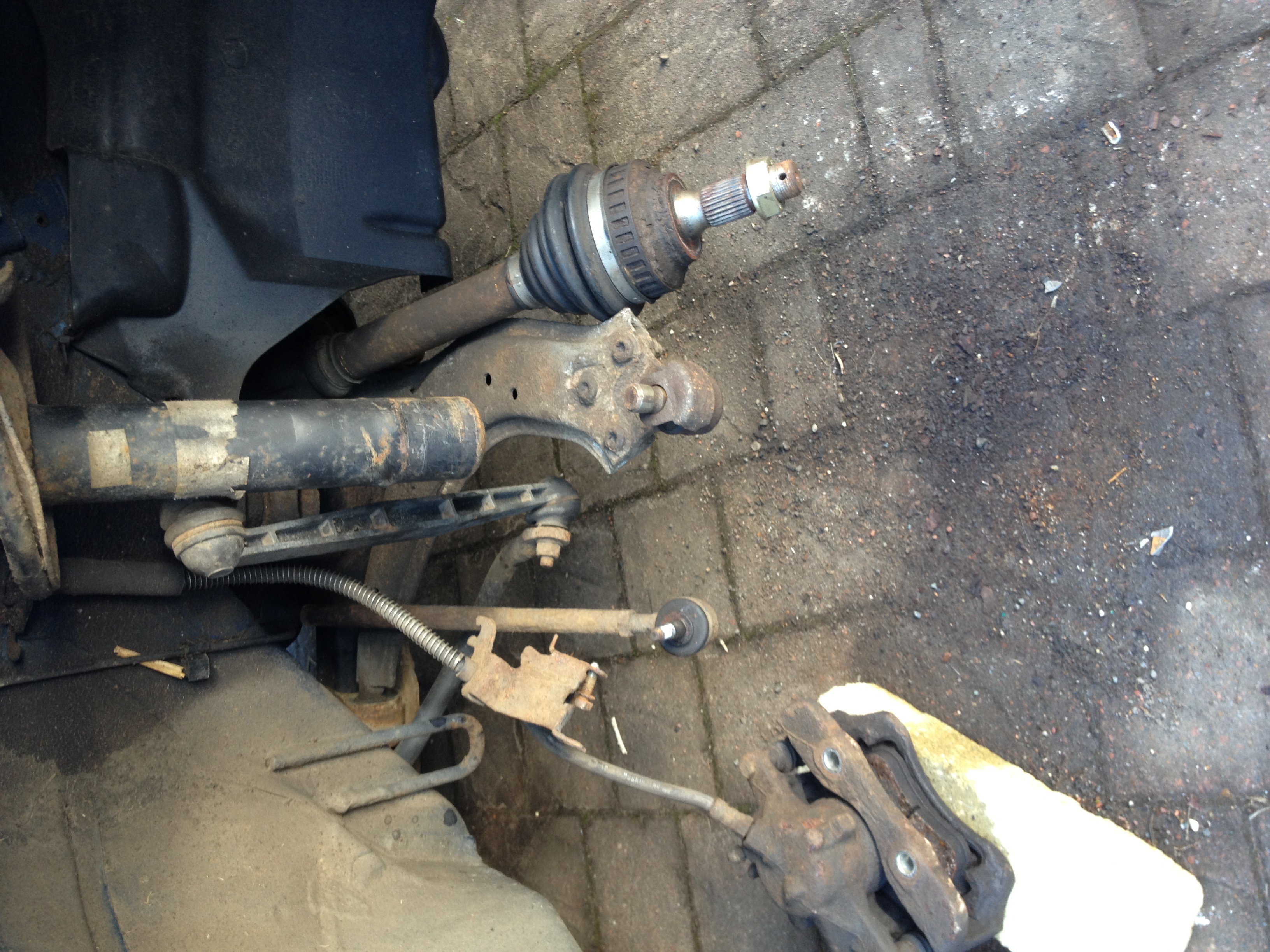

Asked for a hub for my hdi glx and they give me the 16mm hub so my car is left on the drive like this!
Go back and get the 18mm then Tongue

I'm not sure if I should replace the bearing adsembly in the old hub? Think this would be cheaper?
Could well work out to be, depends how much you paid for that hub?
(17-02-2013, 12:38 PM)Matt Wrote: Could well work out to be, depends how much you paid for that hub?
Haven't paid for it yet Wink told the boy he's not getting the money till its on

In all honesty by eye it looks the same, but the vernier callipers tell a different story. But I did say I need one for a HDI. I'm guessing they have just given me any diesel one with abs. Pain in the arse. Do you have a HDI also ?

It's difficult when trying to get a Hub.
Been down to GSF before now where they told us a GTi6 (looking on the database using the reg), Had 18mm balljoints when in fact it had 16mm.
Best thing to do guys is check it in a scrapyard by taking your existing balljoint and seeing if it fits into the hub.
