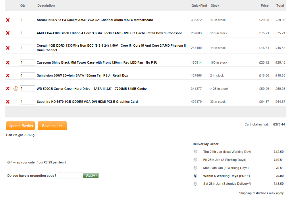

Below is something I threw together quick, it should blitz cad in 2d/3d
You could cut costs on the cpu and graphics card though, since my lesser spec machine does autocad 2013 in 3d with not much problem.
My cpu is a Althon II x3 415e overclocked to 3.2ghz
Same graphics card
If you want to go cheaper cpu let me know and I'll give you the link to the ebay guy I got my cpu from , was £30 posted from china.
[Image: mcetg0.png]

Thats more what I was looking for, cheers Sean. Big Grin
