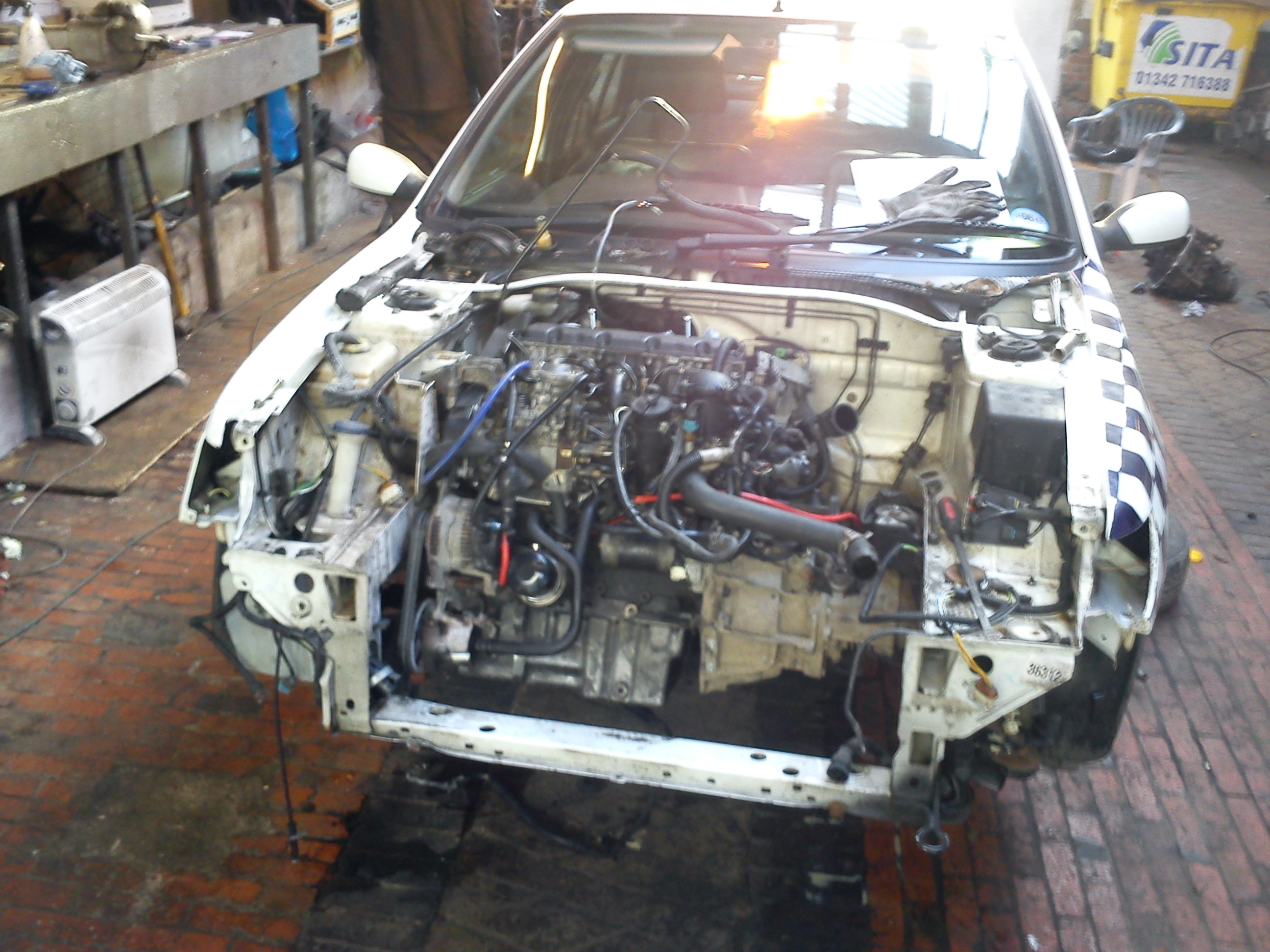

Engine is in, we have clearance at the back, downpipe is on order, praying that a 605 de cat might be a straight fit.

(29-11-2012, 10:47 AM)Dum-Dum Wrote: Engine is in, we have clearance at the back, downpipe is on order, praying that a 605 de cat might be a straight fit. well done chaps...so clearance at the back with no bulkead 'tapping' and standard turbo? very curious about this as my engine has just arrived and I was thinking and wondering what downpipe would work!! also...how are you routing the turbo...still going under the engine from turbo to intercooler? piggy (29-11-2012, 10:14 AM)CJ_Derv Wrote: ^^^ Exactly this PIGGY dude has got muchos to learn....... but that massively tuned tdi wont do the mpg like you want a tdi to do anymore... something like a 335i with the twin scroll turbos, that produces more torque than an evo8 at full chat from only 1500rpm and then right across the range all the way to 7500rpm! and they do 45mpg+ AND I wont be working for the army in the process creating smoke screens! Wishes for more power...

List of jobs for tomorrow; Sort bottom rad hose coolant leak. Make rest of exhaust system. Bleed cooling system Refit drive shafts. Fill gear oil. Finish mounting fmic Finish making boost hoses Bleed fuel system Refit bonnet, bumper and wheels Probably a few other niggles. Not a big list lol

getting there...update us on that downpipe when you sorted?!
30-11-2012, 10:07 AM
Hopefully have it back tonight. Will update then.
