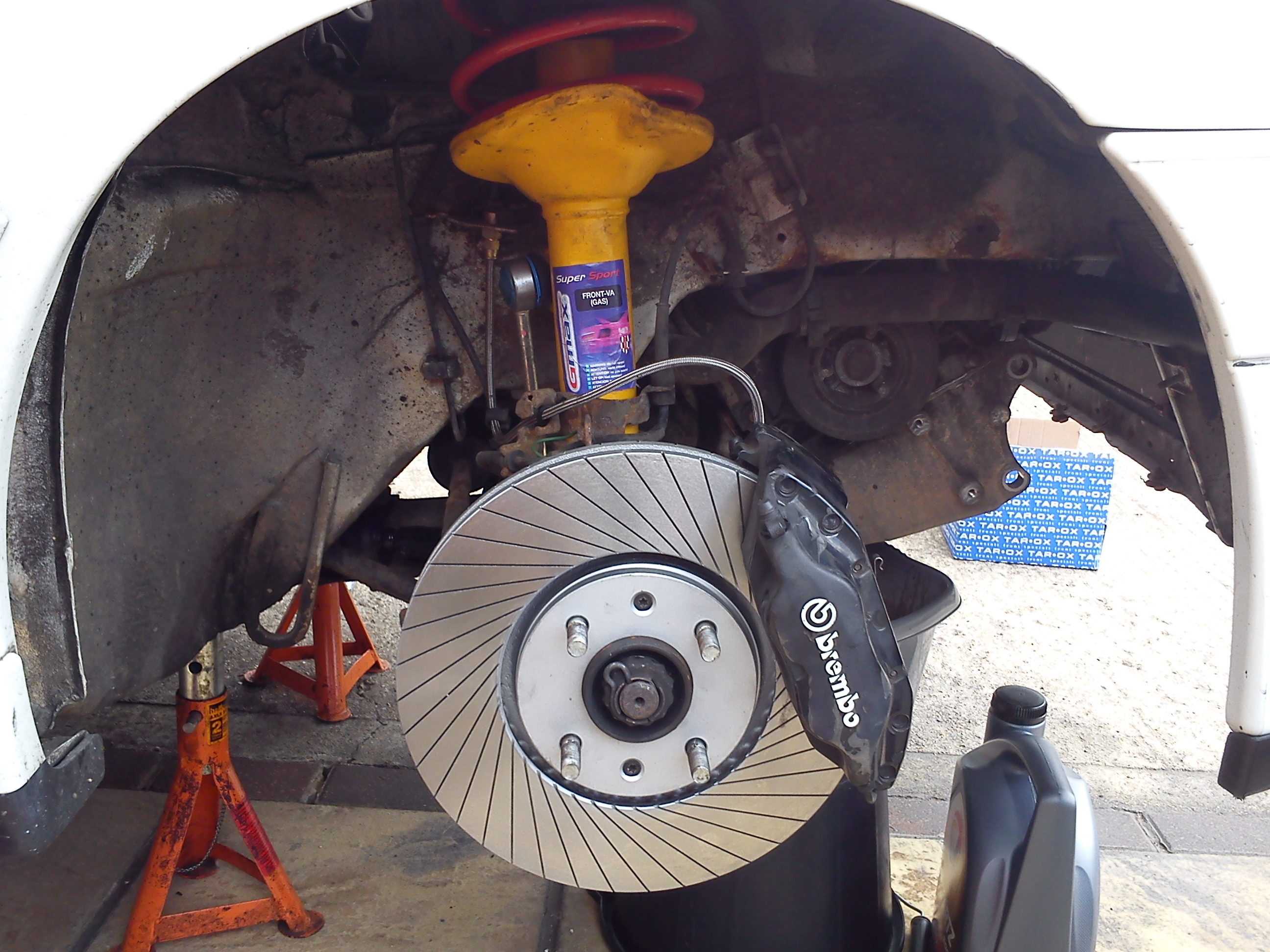

You say one brembo sounds worse then the other....Is it the left by any chance??
Yes it is.

i wonder why they do that then??

I do too, I did think it was because I have the 406 TX55 bolts on the passenger side and the 306 17mm bolts on the driver side but I guess you used the same bolts all round?

Yeah i got the same bolts all the way round. strange eh?

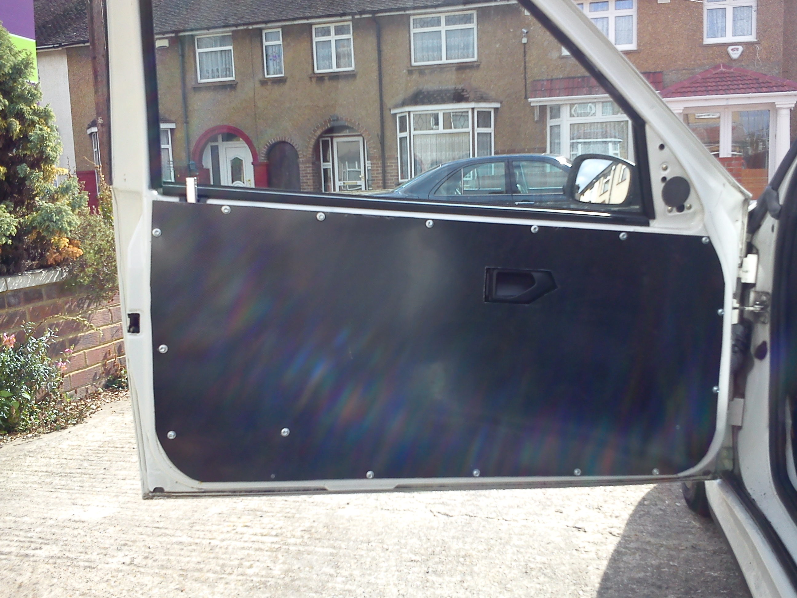

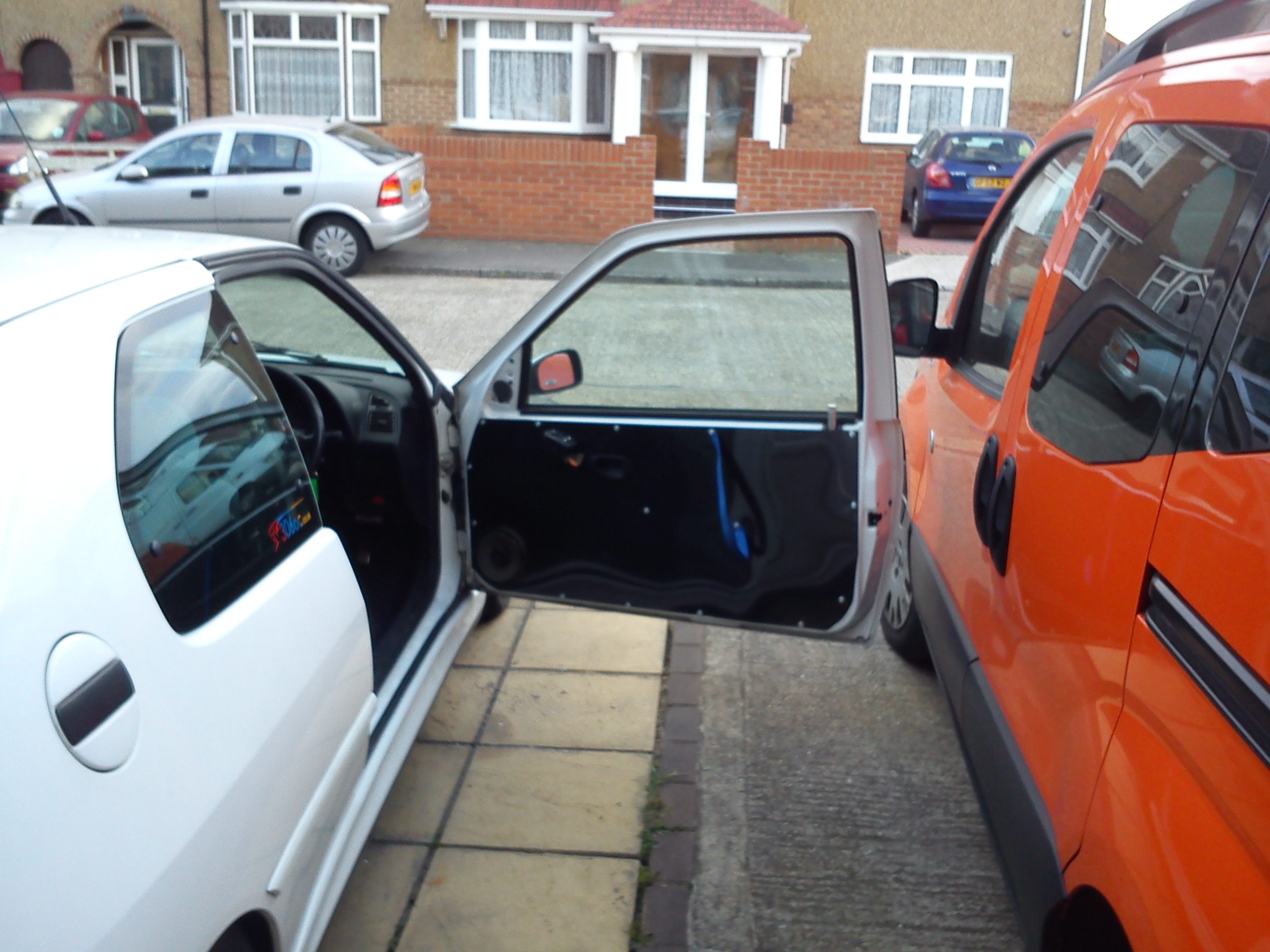

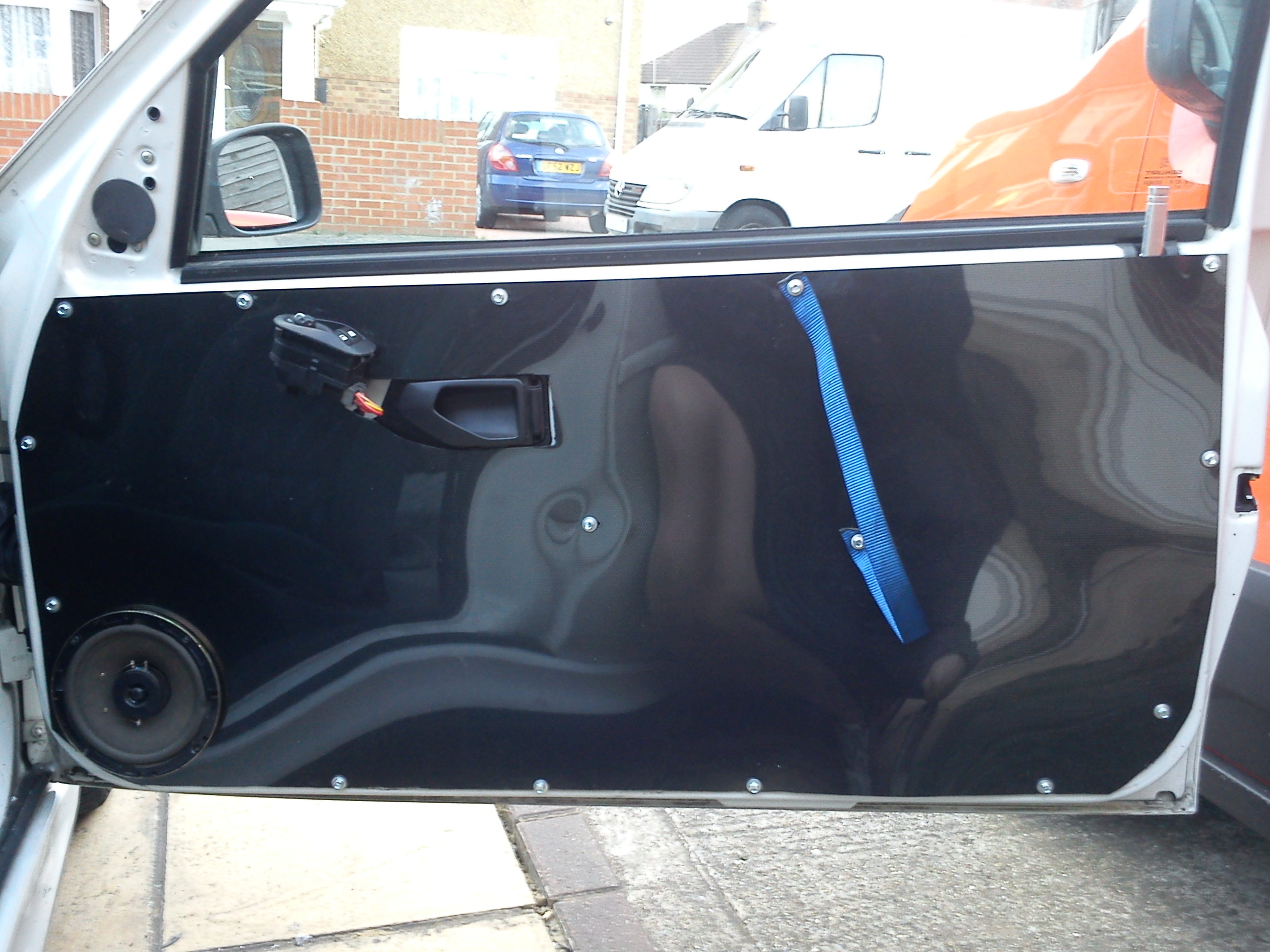

So my carbon fiber ABS sheet turned up yesterday and I made the first door card. I tried the measure twice cut once and still failed at the door handle hole (realised i should of used the handle surround as a template).
Its not a bad material to work with apart from the fact if you cut it with a jigsaw the blade gets hot and so melts the edges of the 2 cut pieces and they melt back together after the blade has passed. Fortunately it is only 2mm so i can put a sheet on the bench and cut it with a knife.
Its held on with self tapping sheet metal screws as a pack of 100 was about £4 from screwfix and they come with a 8mm bolt head and a large metal/rubber washer.
I think it looks really good, just gotta do the other one but I couldnt be bothered today. also gotta do the windows as the polycarb turned up today.

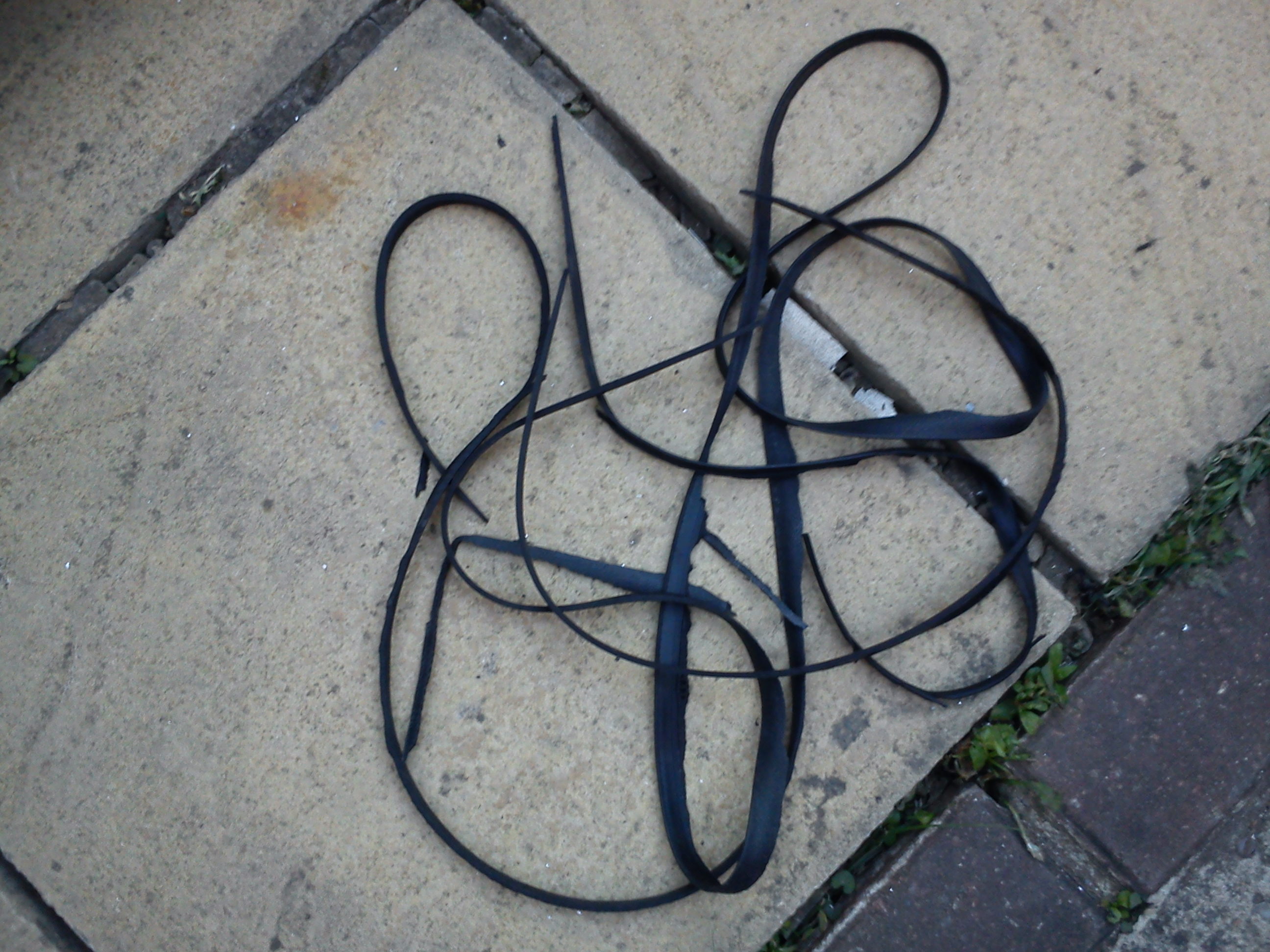

Also trimmed the drivers door seal as the bit that goes over the carpet/trim as its no longer needed. Weighed 150g if anyone cares but with 2 doors and the boot (and the rear windows if the entire seals werent going) would be over half a kilo

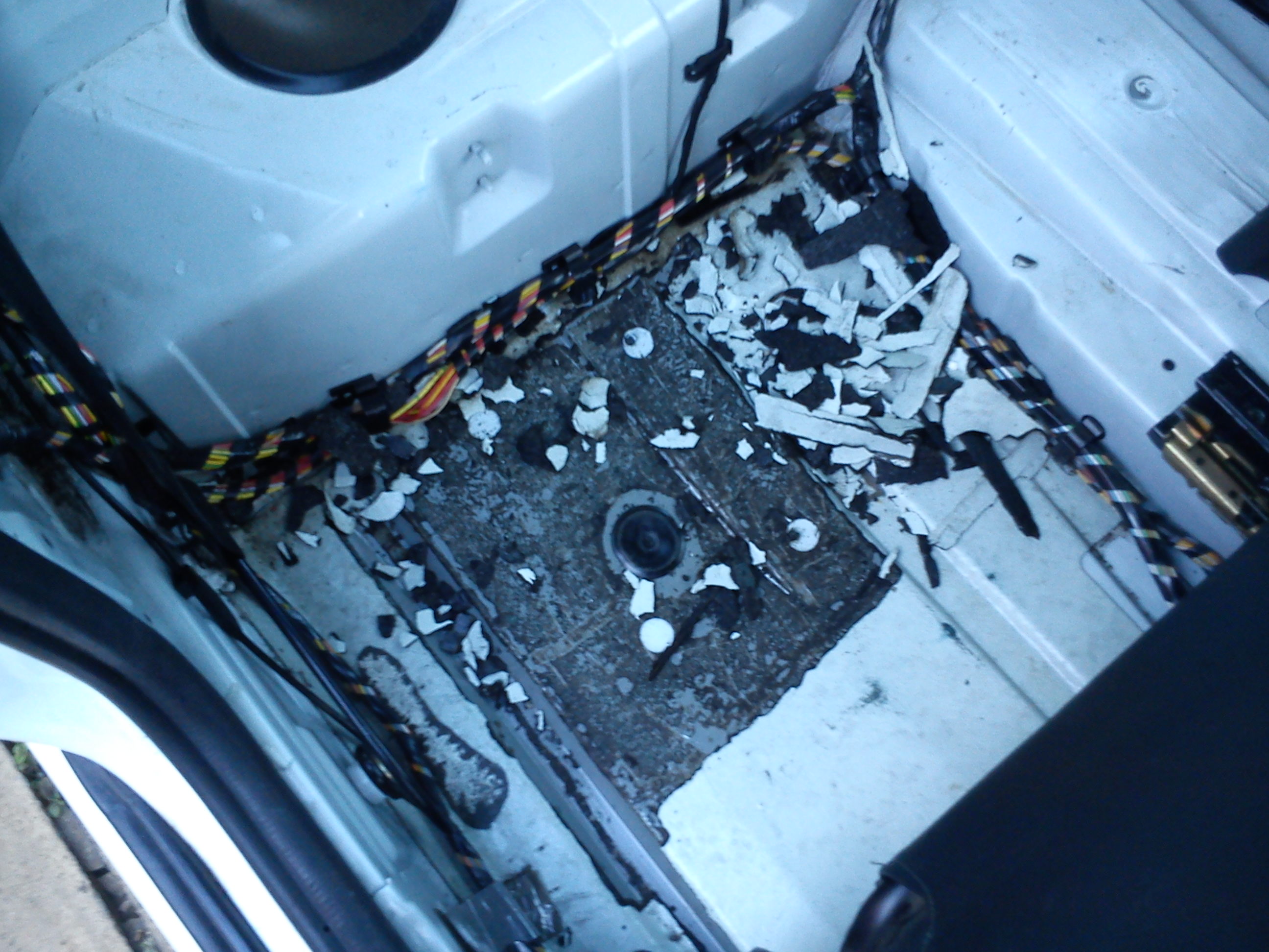

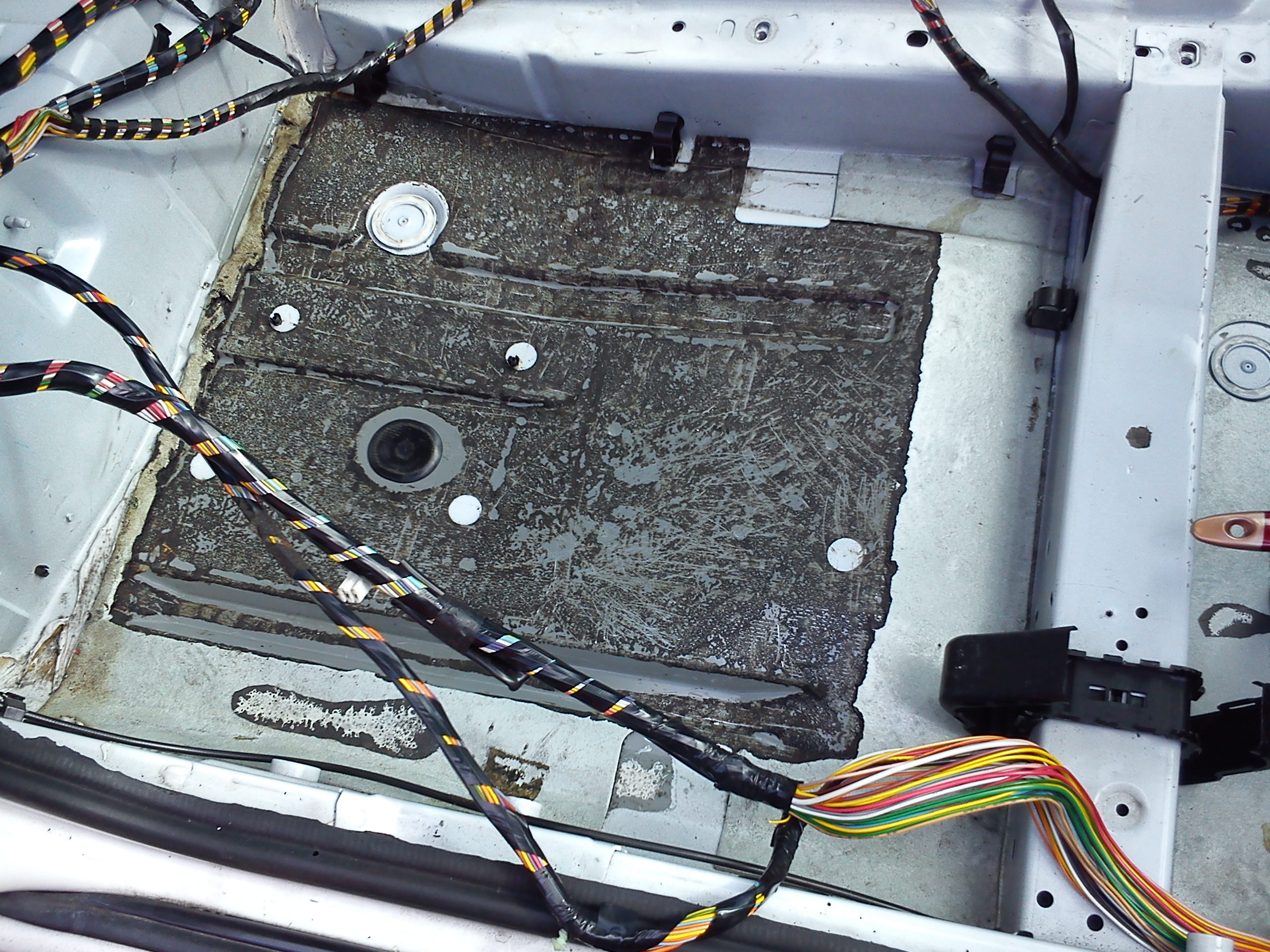

Had a little bit of a bash at removing some tar from the floor, hoping itll be alot easier with some heat.
Really Ive been far too lazy today and done nothing. Im gonna really smash on with it over the next few days as Im off work. Ill get it weighed afterwards and see how light it is.
dont do it with heat wait till the colder weather it will chip off in bigger flakes

(12-09-2012, 06:27 PM)cully Wrote: dont do it with heat wait till the colder weather it will chip off in bigger flakes
even better if its frosty
I might get some freezer spray then (or a bag of ice cubes)

Not weighed this one but should be about a kilo, a std one is about 3kg

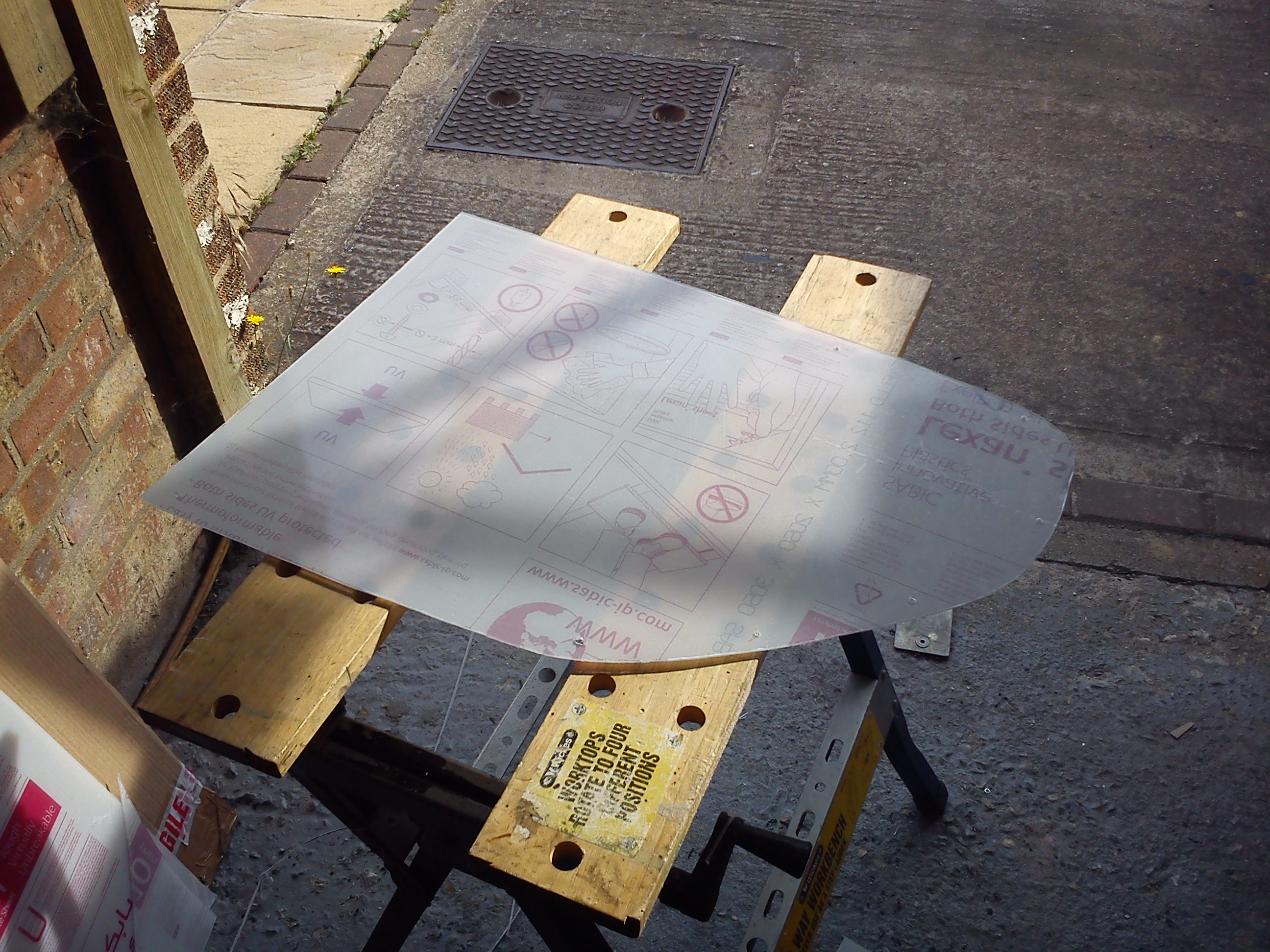

Cheers mate, the polycarbonate was off ebay, theres a company that sells 1000mm x 1000mm x 2or3or4mm sheets, I got the 2mm as its only the rears. Even got them to cut it into 4 peices for me so I only have to shave the corners (hopefully) think it was about £20 plus £8 postage or summat

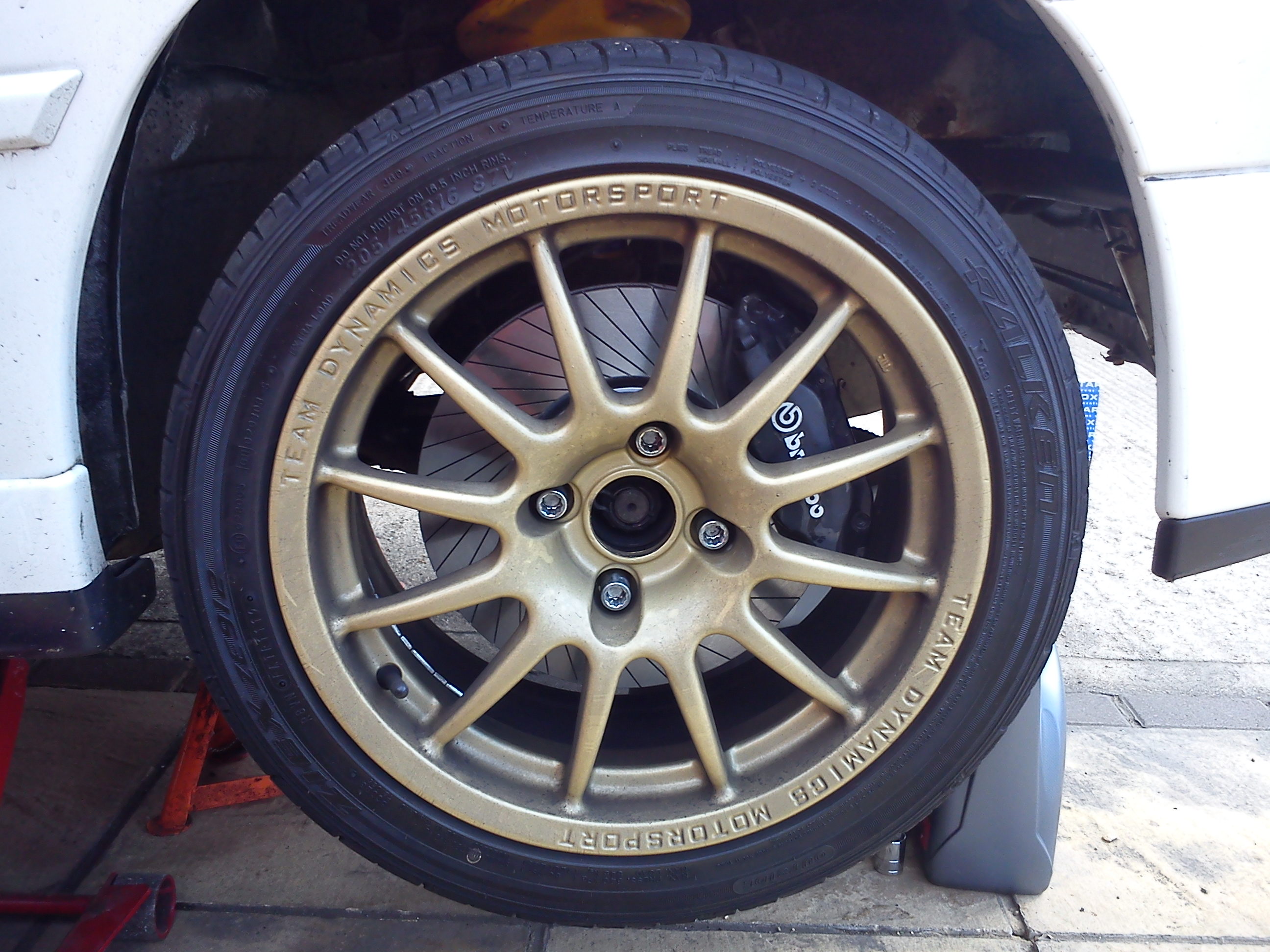

Got my G88s on, the brakes still squeal just as bad under anything but heavy braking, hoping theyll shut up once theyer bedded in.

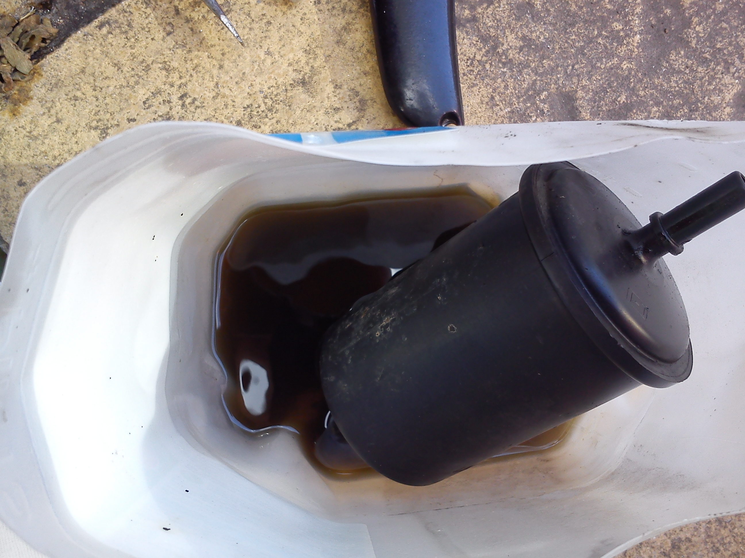

Changed the oil and oil filter (total quartz 9000 5w40 fully synth). Also did the fuel filter which it desperately needed, the fuel that came out the tank side was almost black. this is it mixed with what came out the "clean" side. All the grit in there is out the filter.

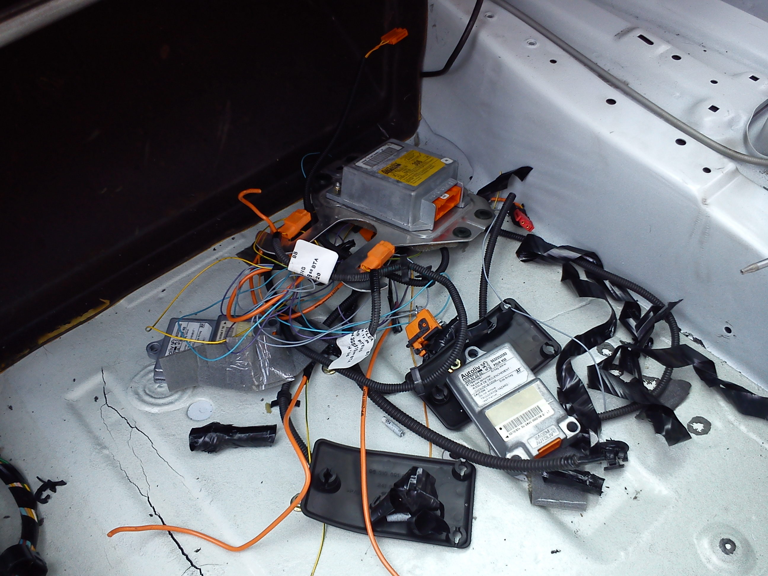

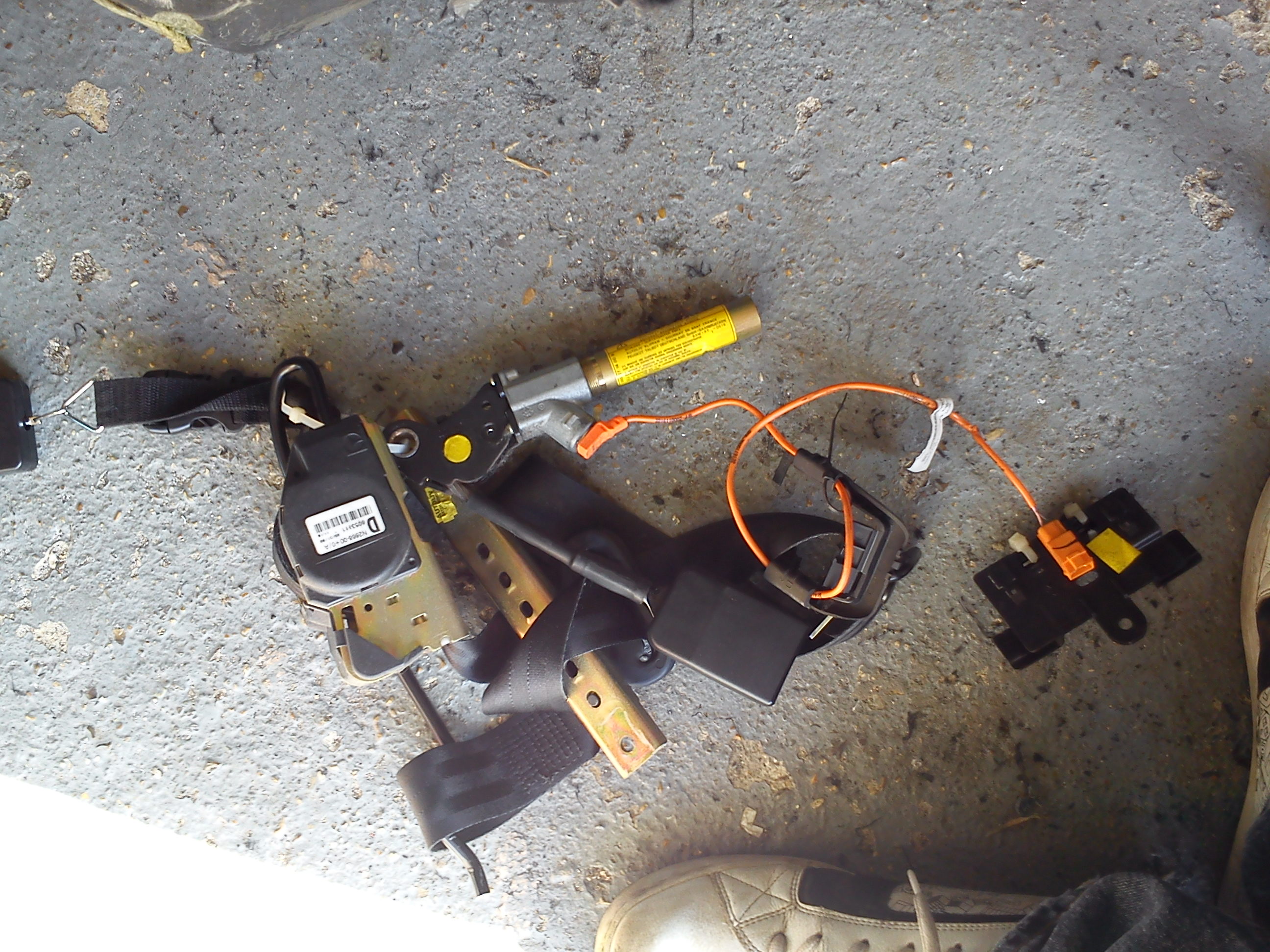

Ripped out all the airbag ECUS and all the wiring that wasnt burried inside the dash.

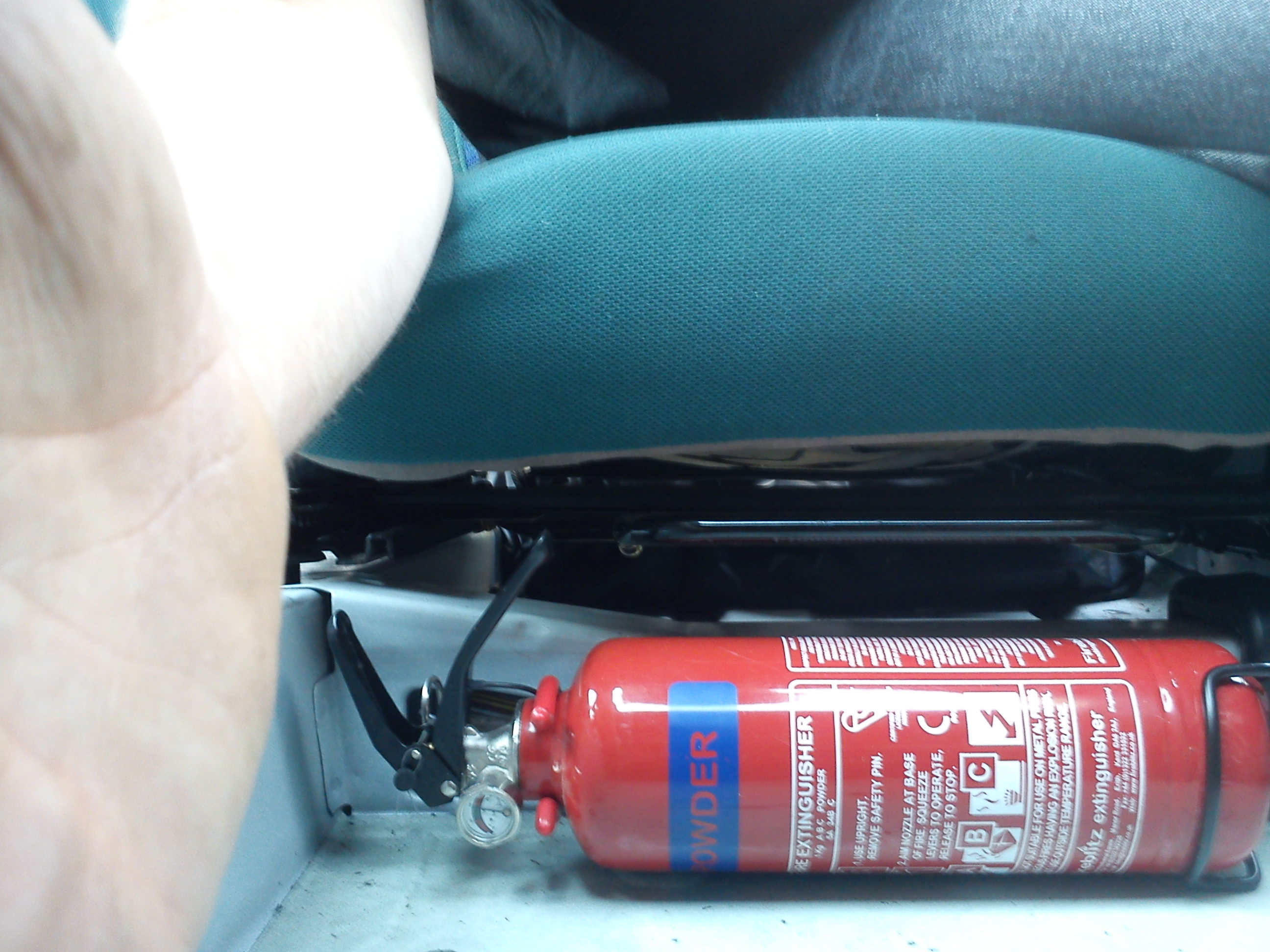

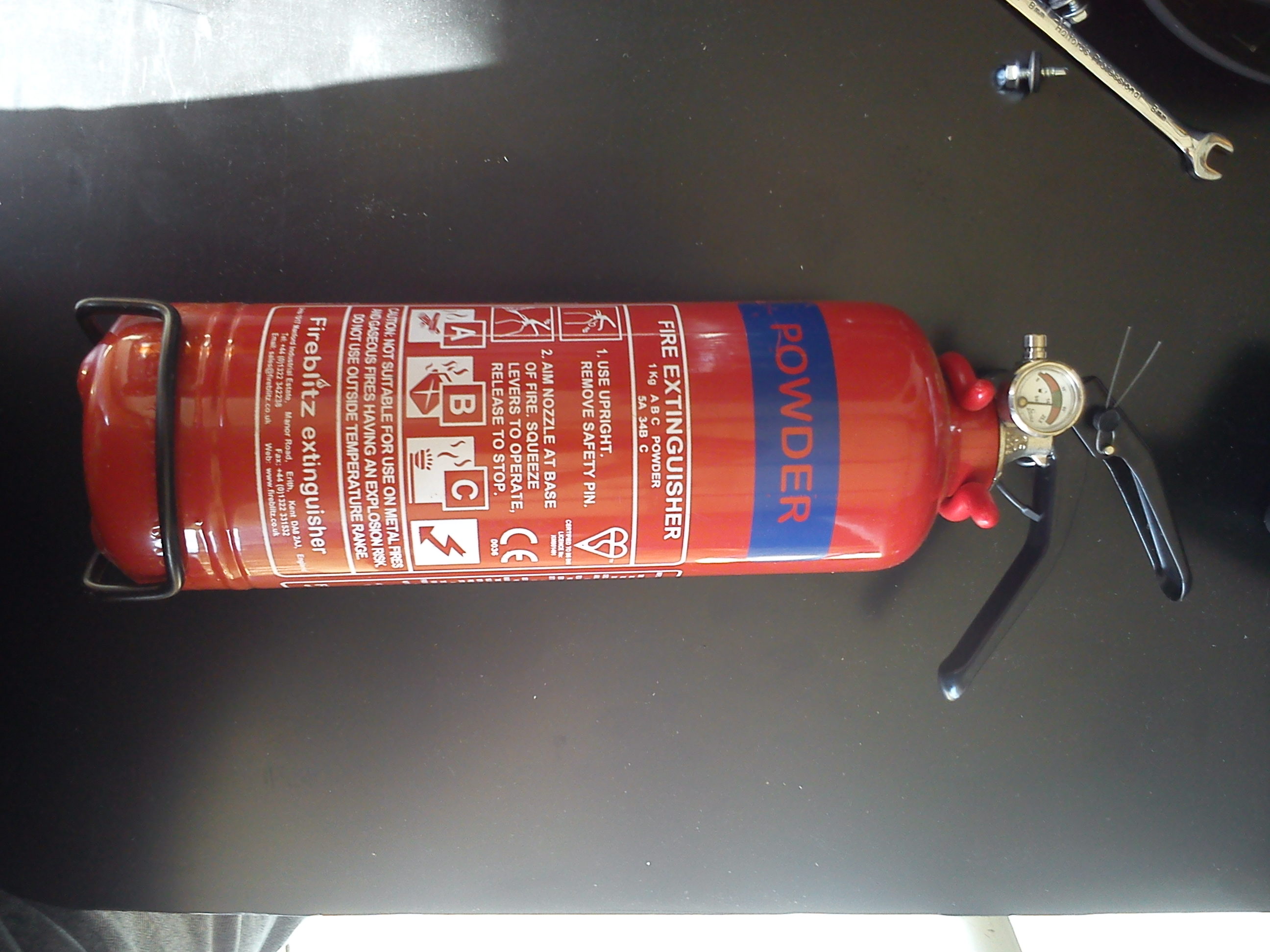

Fitted a fire extinguisher. its bolted to the cross member at the front of the passenger seat.

Also removed a load of the tar from the driver side, stopped when I got bored/f*cked off with it. Wasnt even a kilos worth that I removed.
Oh and finished the passenger door card, this is it looking sex without the handle, speaker or window control.

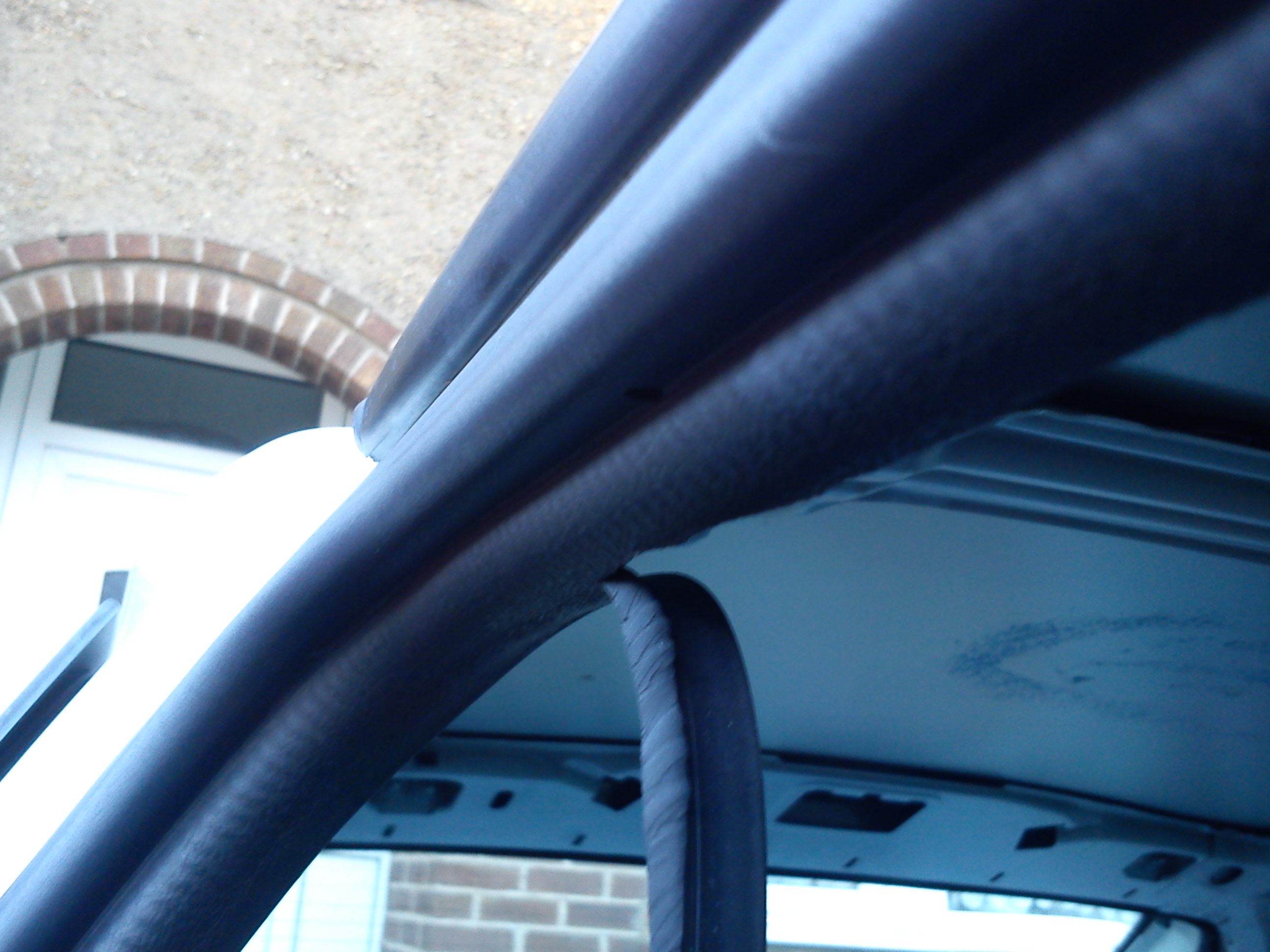

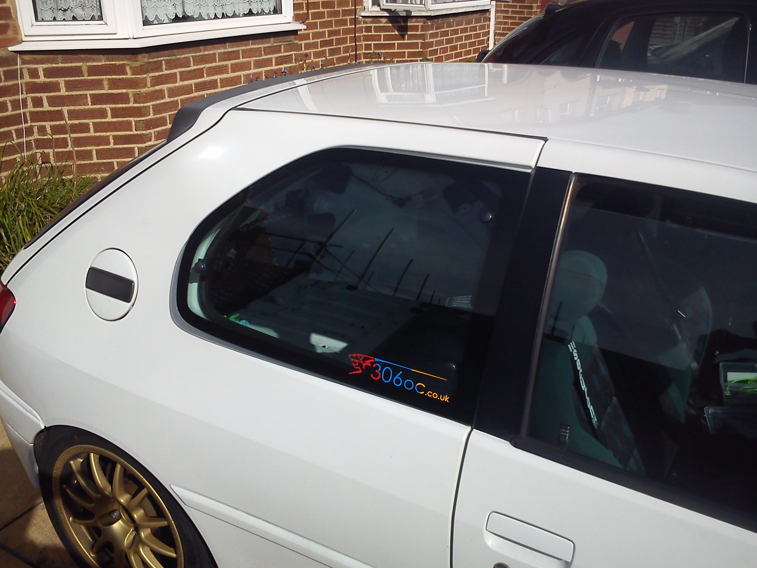

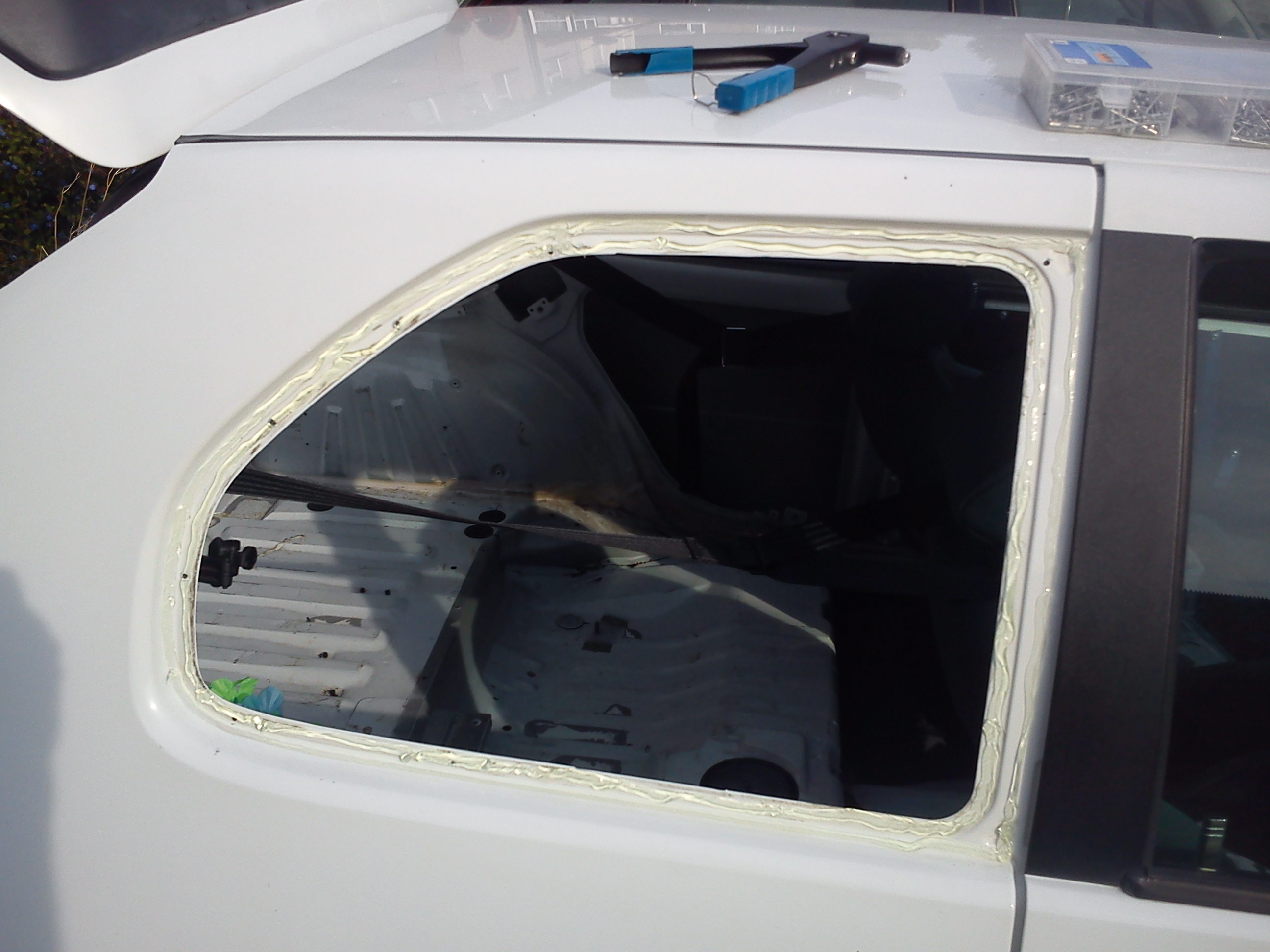

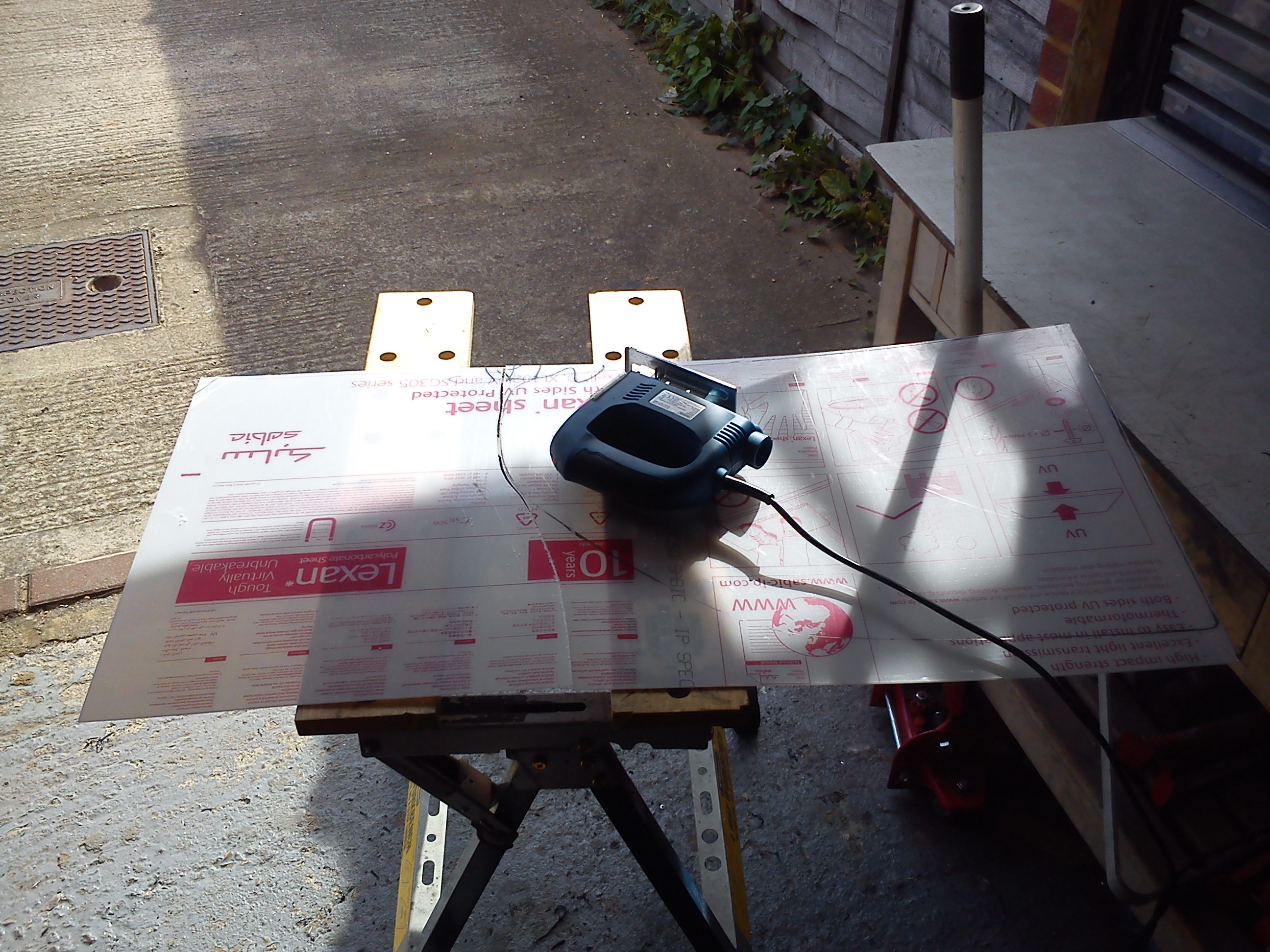

Polycarbonate windows are in. The polycarbonate is lighter than the window seal and plastic clips of a standard window.
Pics later/tomorrow, they dont look great, gonna try and put some black tape round the edge to make them look a little bit more oem.

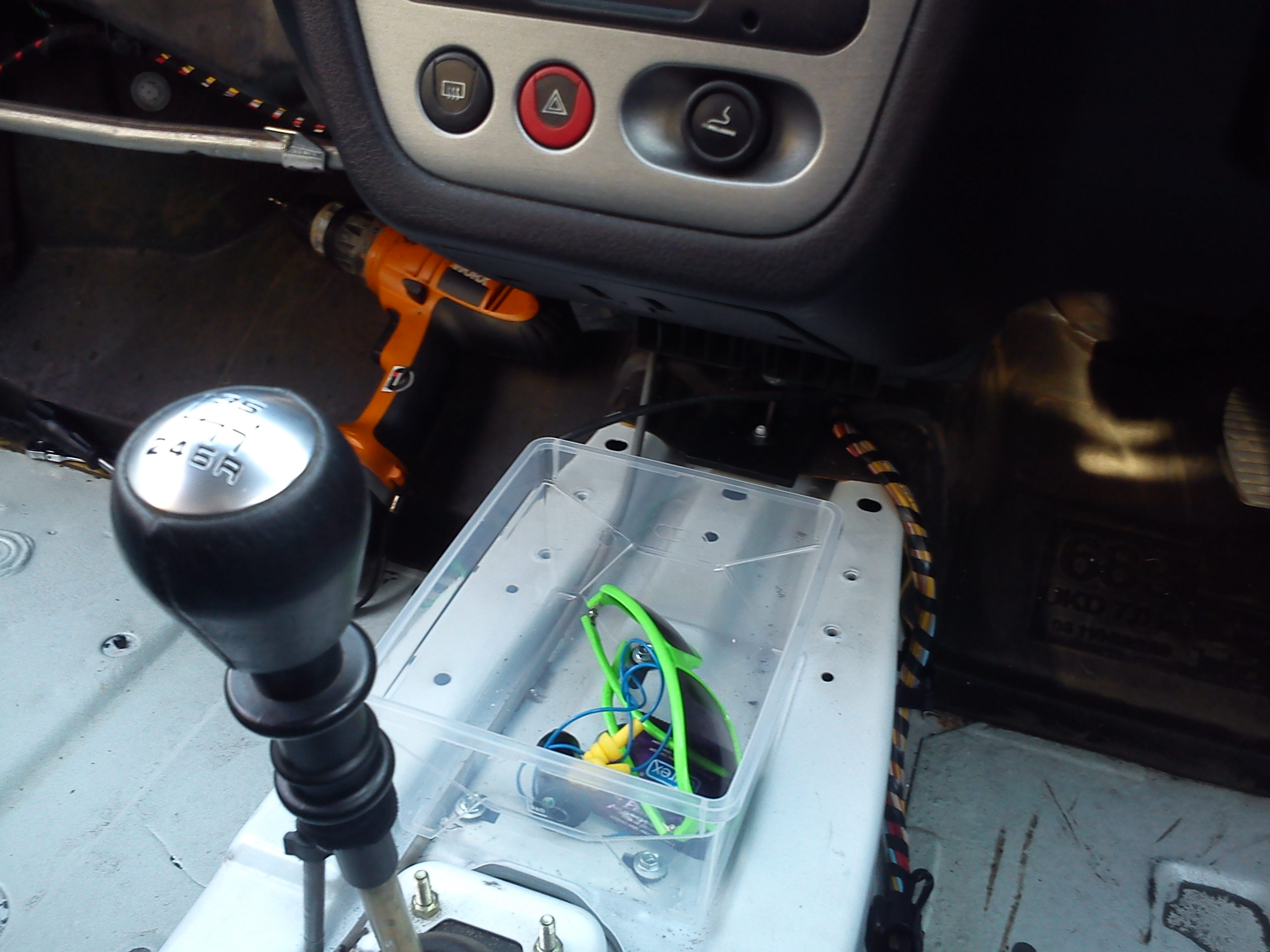

So Because I have no door pockets and no glove boxes I needed some storage for them all important essentials. You wouldnt believe how much difference the ear plugs make, made me realise quite how loud my car is.

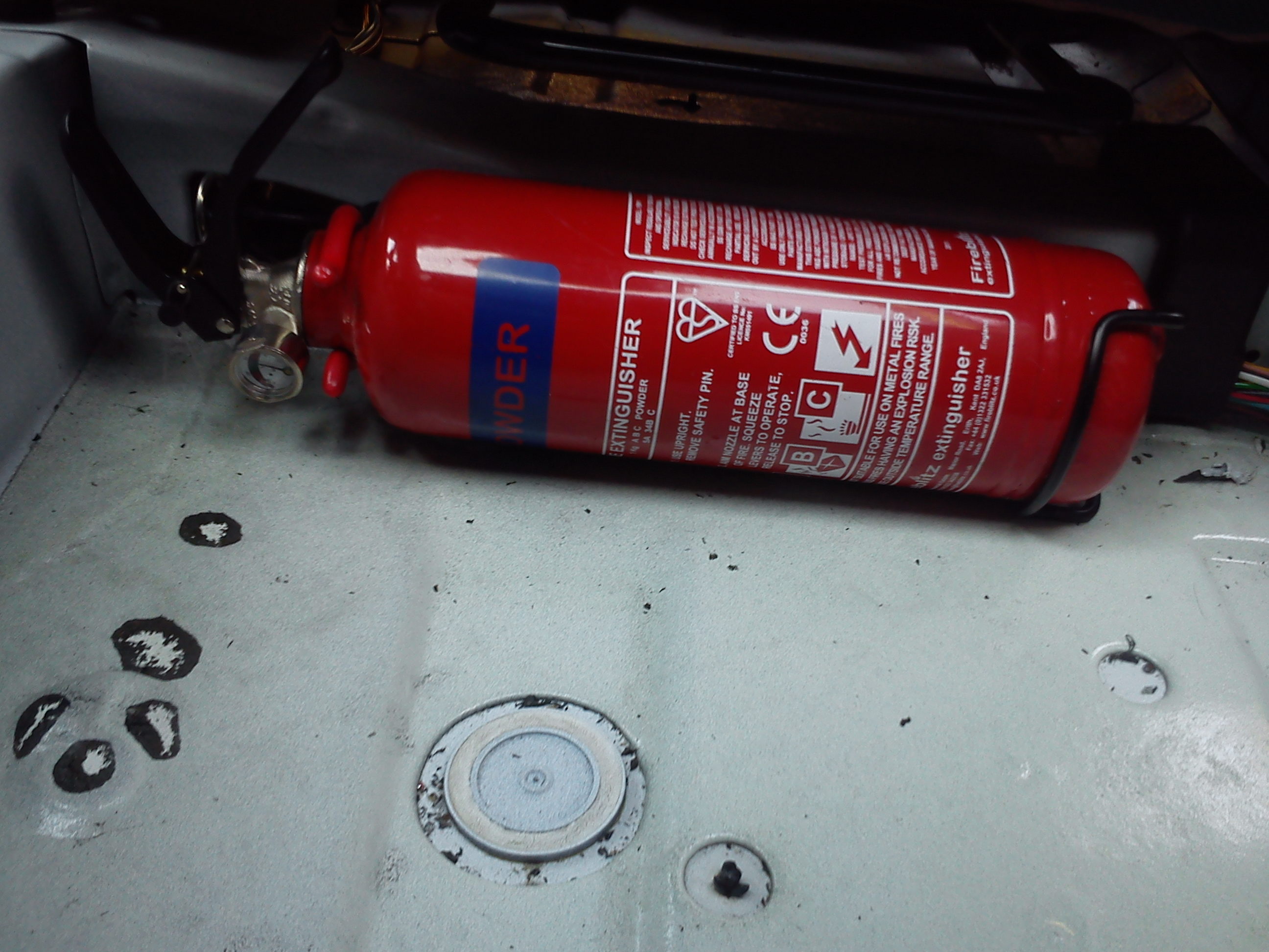

Heres the fire extinguisher fitted

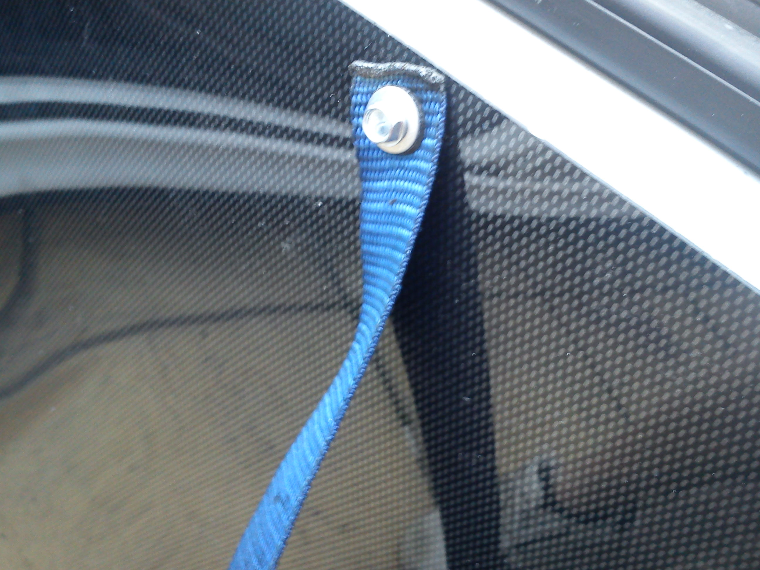

And the polycarbonate windows. Photo 3 shows just how tough polycarb is compared to perspex, thats an off cut tied into a knot, I bent a bit of it 180 degrees back onto itself and it didnt snap, amazing stuff.
