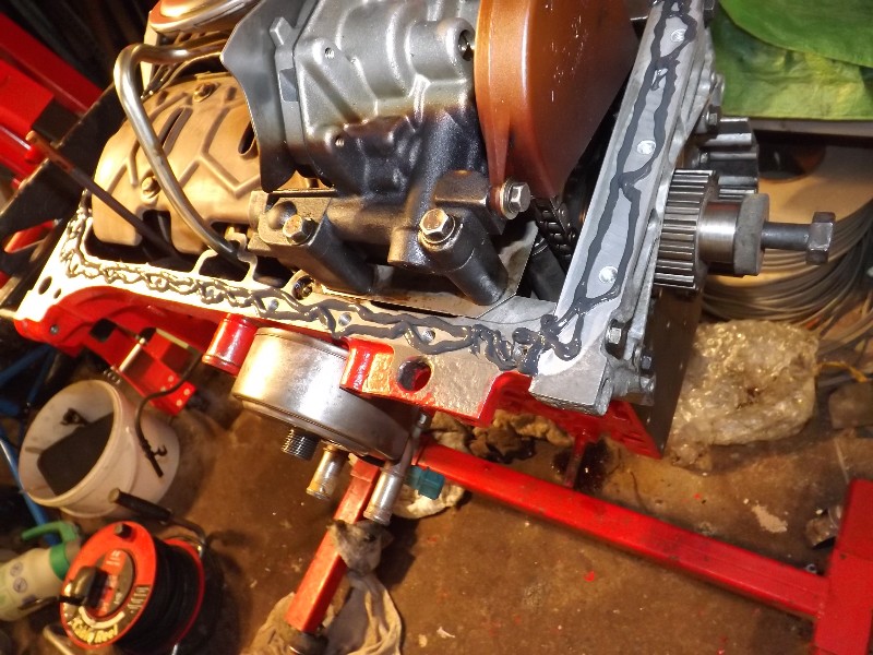

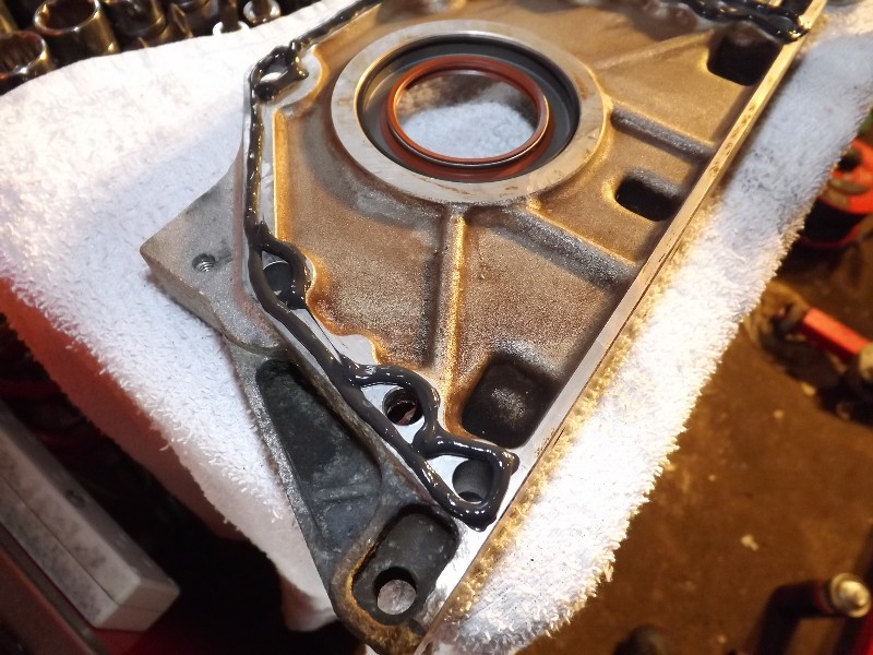

done some icing of the cake today
liquid gasket Smile
geting better at the icing Wink
sump is on all torqued down
