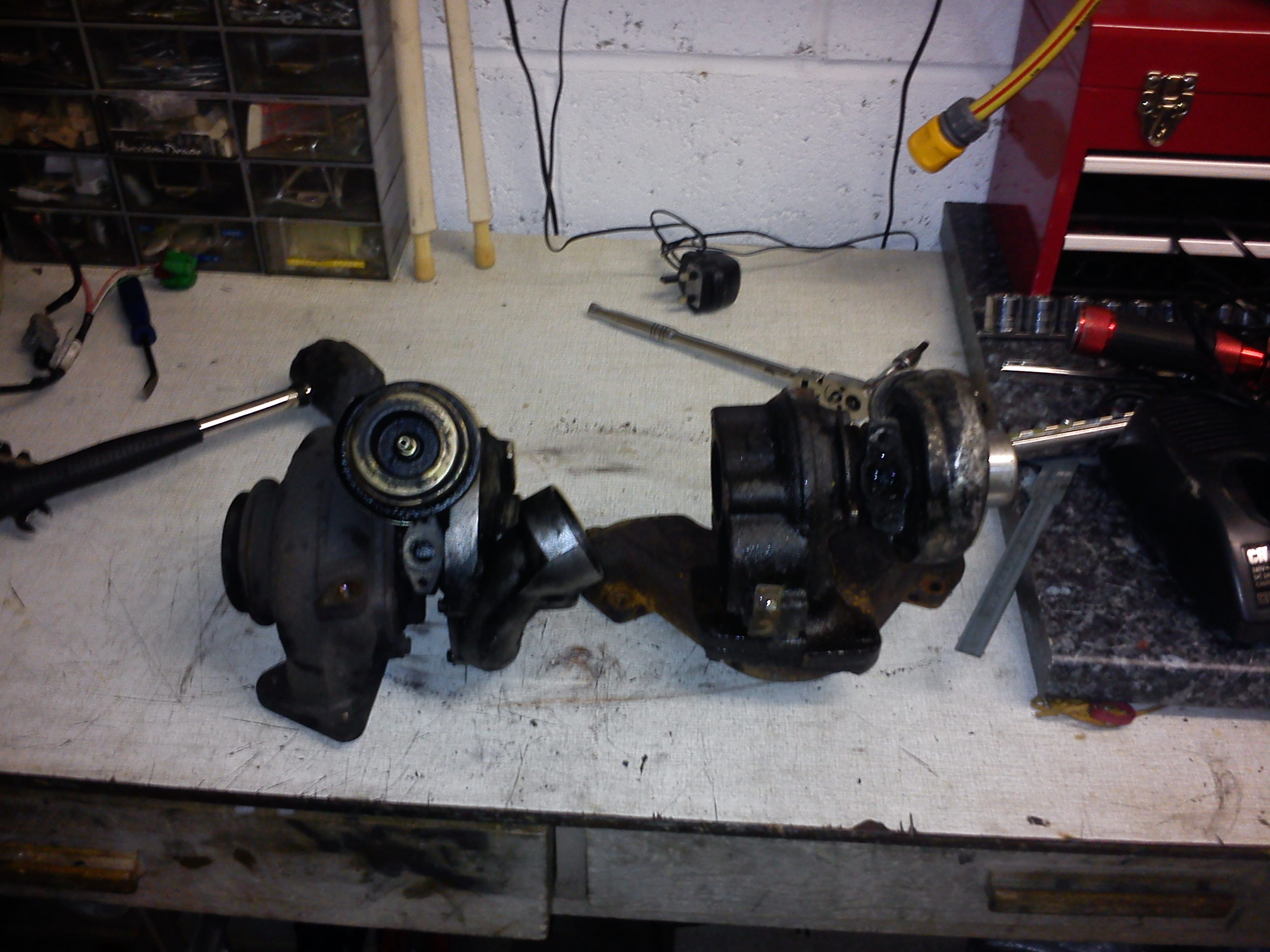

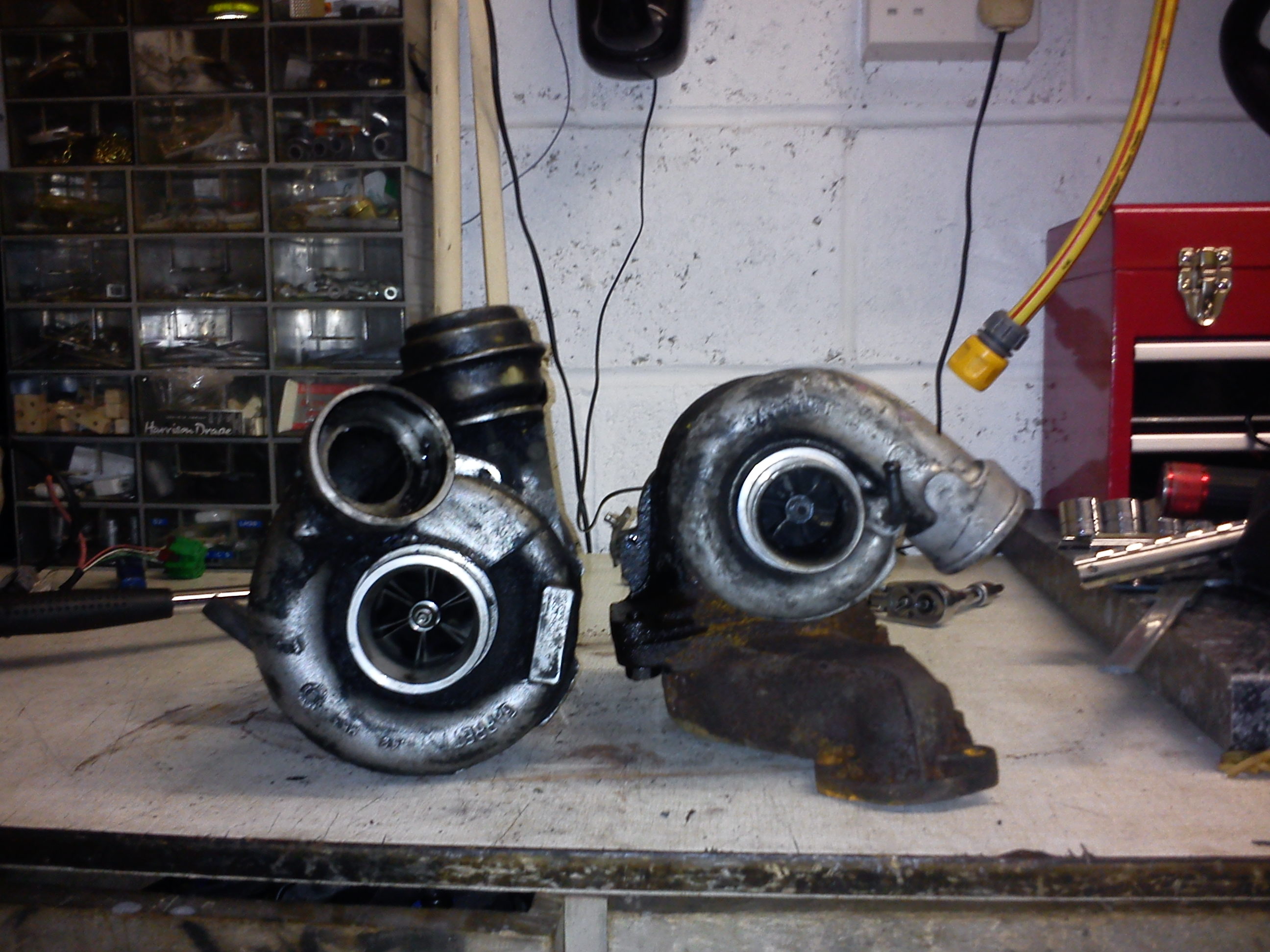

Got a scrap T2 out and the GT2359V to start trying to fit the T2s boost actuator, turns out it didnt come with one so that puts that idea to bed. The front of the GT23 was absolutely shit high. Measured it up, its a M10x1.0 oil feed and a 38mm bolt spacing drain.
Pics, T2 on the right.

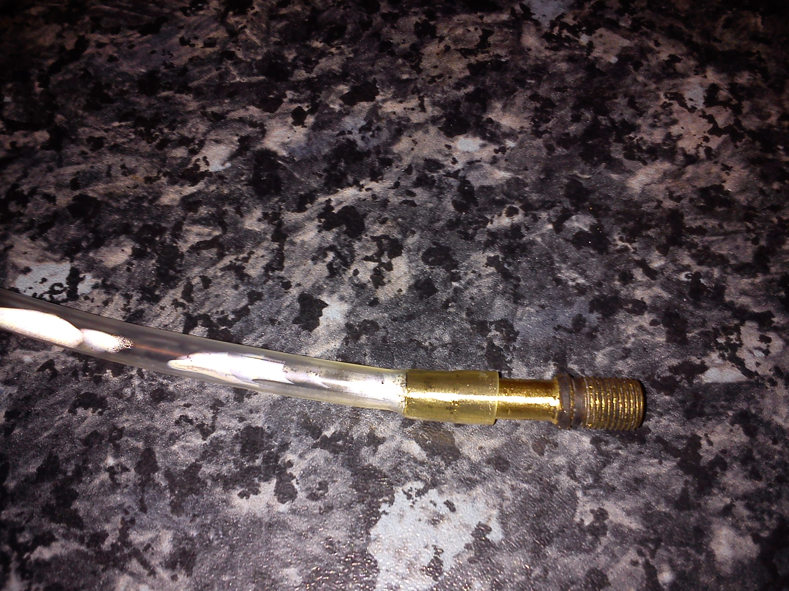

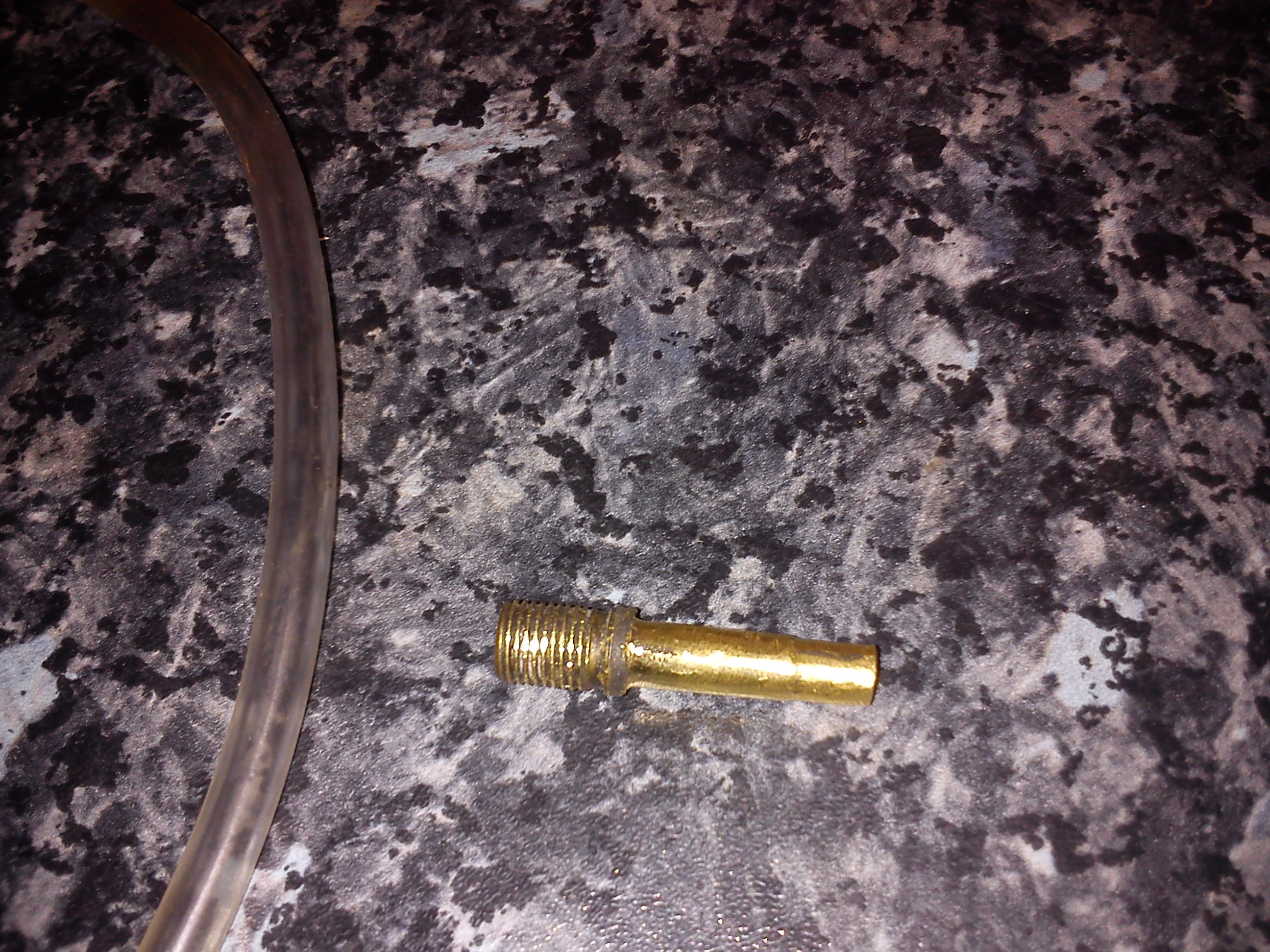

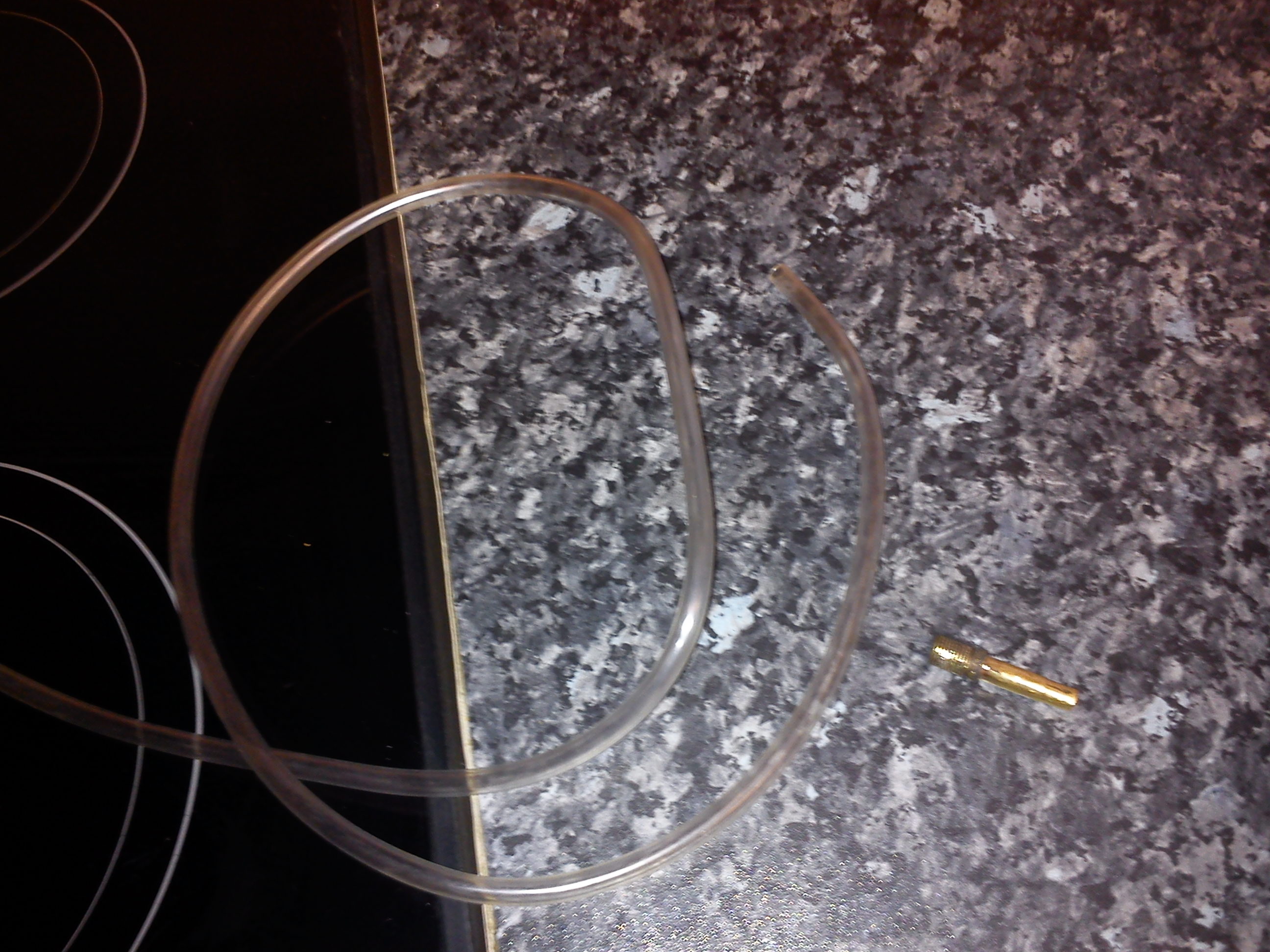

So although I have no actuator to test Ive "built" up my actuator test rig.
Basically its an old tyre valve jammed inside a length of poly pipe that I can then connect up to a hand pump and Ive got a good one as I used to race at a national level so I trust its gauge.
It is boost tight now (needed superglue on the brass) and holds pressure so if I pump it up to 30psi it stays at 30psi.
Ive used it to test my boost gauge that alot of us (myself included) thought was under reading as was only peaking at 18psi and after testing it would appear to actually possibly be over reading. The boost gauge shows 32psi with the pump sat spot on 30psi
Nice simple idea there, good thinking!

Yeah it's making me consider a similar setup to test the GT before it goes on. Presume it can be used to test MBC's too? Like to check the trigger PSI?

Could probably also use it to test for boost leaks if you plugged the inlet to the turbo and the top of the manifold.
(06-01-2013, 04:49 PM)cwspellowe Wrote: Yeah it's making me consider a similar setup to test the GT before it goes on. Presume it can be used to test MBC's too? Like to check the trigger PSI?
Yeah could be mate, thats one of my plans for it is to set my MBC precisely.
So ridiculously easy to make.

You just stripped the rubber off an old tyre valve then aye?

(06-01-2013, 04:57 PM)cwspellowe Wrote: You just stripped the rubber off an old tyre valve then aye?
That's the main thing i'm uneasy about with the new setup, not knowing what the trigger psi's are and having to set it really conservative for first run. I predict epic coal for the first few runs lol
MBC is located up by the top engine mount so not too much of a fiddle thankfully, f*ck tuning it off the wastegate though in this cold and damp weather
Yeah I used one off the bike as they use a thinner rubber by the looks of it.
Cut most of the rubber off with an Irwin knife then finished it off with a file.
Softened the end of the poly in a cup of boiling water, had to expand it with a bradle then push it over the end of the valve.

I think the shaft of the valve is 5mm or 6mm (the screw thread is about 8mm but appears to be an imperial thread) I dont know if Ive got 3.2mm or 4mm but it was a tight fit.
Tbh I think the PVC tube I can get is 4.5mm? Either way, 3.2 is FAR too small.
(06-01-2013, 05:44 PM)cwspellowe Wrote: Tbh I think the PVC tube I can get is 4.5mm? Either way, 3.2 is FAR too small.
Wont matter if you superglue/araldite/epoxy it on to the valve.
It's more for fitting the MBC i'm concerned. Don't want it popping off under boostz. Cable tie should do it, the joiners are barbed anyway
or a mini jubilee clip, had to use them on the beemer as it was blowing them off. Poly pipe pops at about 35psi though. Got a piece with a massive hole blown in it sitting pinned to the wall in front of me.

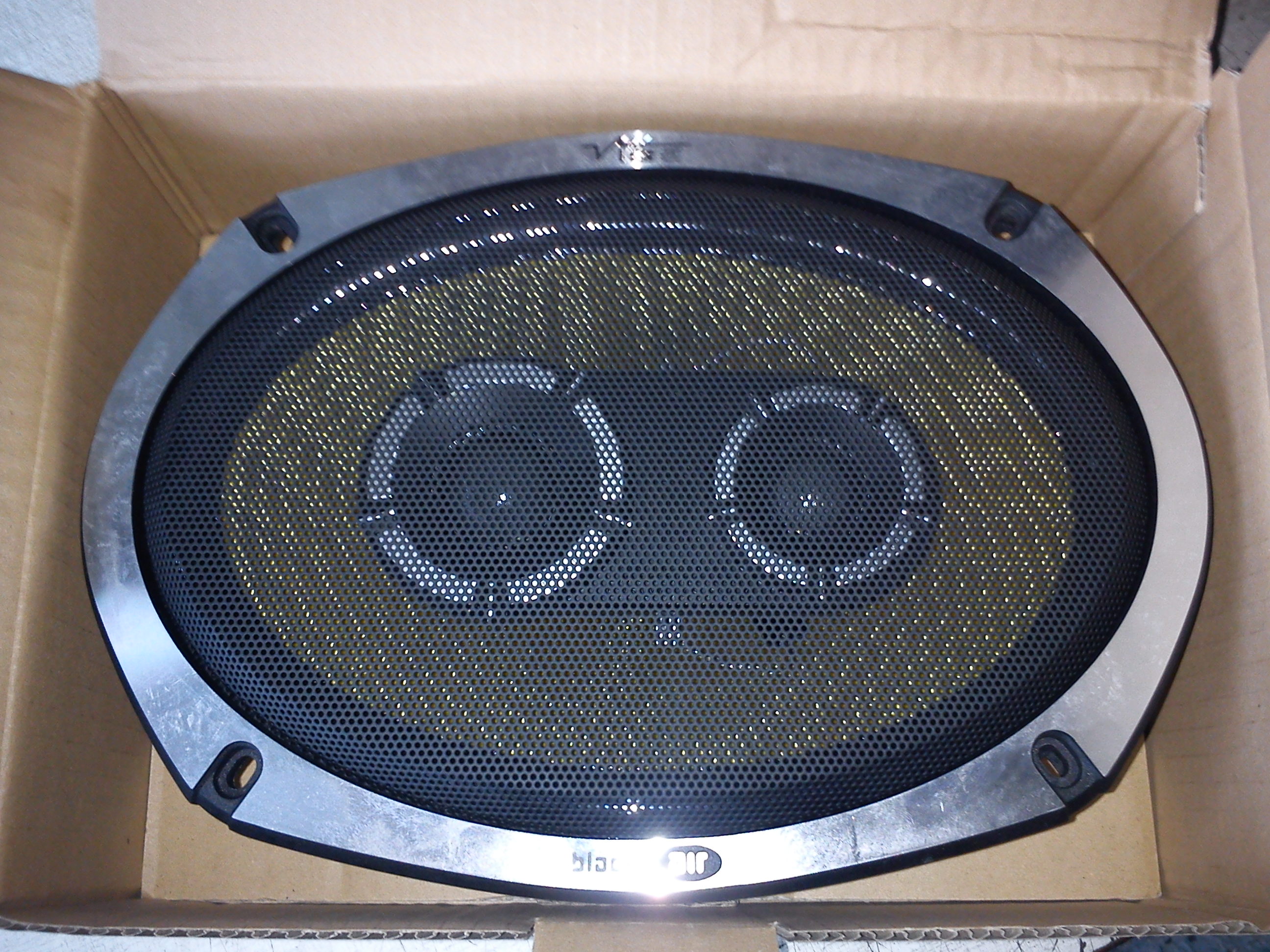

Firstly, Ive got alot of parts needing or gonna be needing paint soon, what do you all think to matte white? (the same paint as pompey marks first spray job he did himself). Does anyone have a workshop/garage/marquee that i could use for painting.
Secondly Ive started on the ICE. These arent getting fitted till Ive got the rear windows tinted cos otherwise theyll go missing. Think Im gonna get the fronts to match.
Can use my garage bud, will need to make some space first though lol. I've already got sheets and a stand and stuff.
carnt go wrong with the vibe stuff. middle of the road. might be worth spending a little more on some components up front . all depends on your prefrence.
dum sack of the 6x9's your better then that lol.
Focal's is the way forward you heard mine and nialls why you slacking hard?
And round speakers sound better then ovals fact...........
