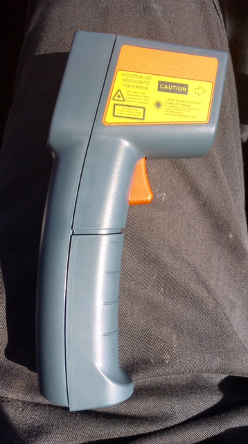

Try to set my Fan via my DTA last night but dash readings are 10 degrees lower than DTA software reading ...so I've borrowed one of these below to see which is correct & then I'm 100% sure it's safe to set the fan correct temp to come on & off .....these are not 100% I'm aware
