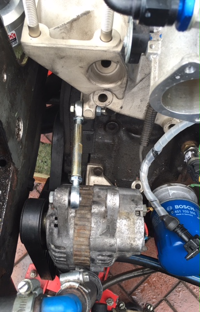

40amp Mitsubishi alternator second hand given to me more more half the weight of standard six one ...

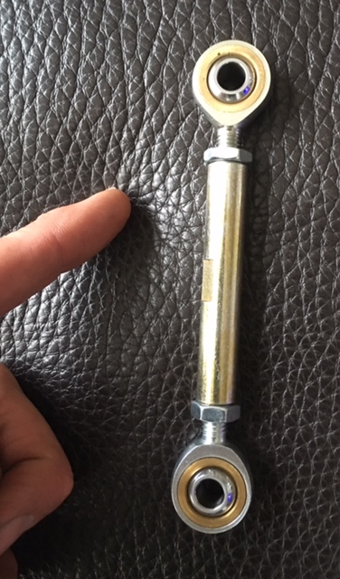

£13 McGill motorsport ajustable 110mm rose jointed lever used which allows me to fine tune & use my pile of assorted size belts & still have the correct gap from alternator pulley to Standard 6 auto tensioner .
Similar to Denso with 15mm shaft instead of 17mm standard .
Loads of extra space as a bonus also

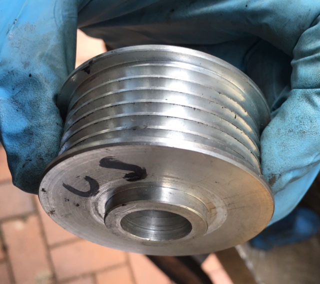

Had to buy a 15mm alloy pulley from Fleabay £25 = 53mm by 10mm offset & 15mm centre
