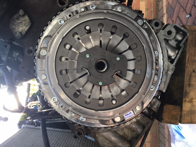

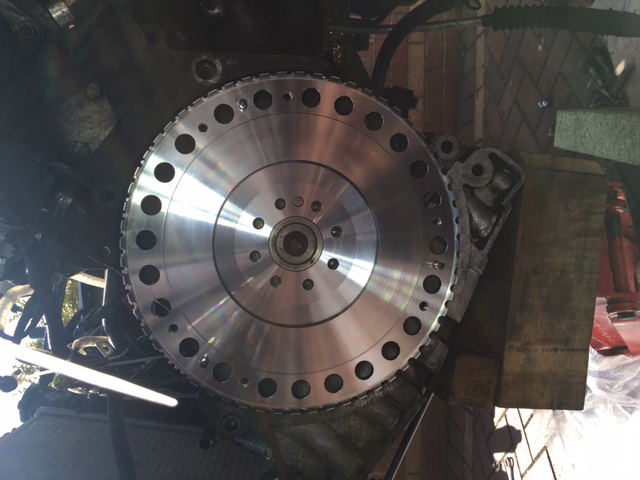

Well yesterday my mechanic m8 Martin came to help me fit my new (Miles) refurbed 6speed box with New 4.75 Bacci gear-set
Had to remove 3j plate diff & replace Crownwheel for the one in my box that matches ...
Then fit new Crank seal & RichW Lighened flywheel with new GEN bolts all torqued up
Helix Sprung 4paddle clutch & Helix Pressure plate

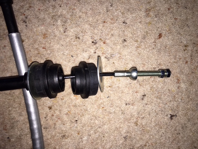

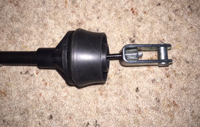

Fitted new (non) ajustable clutch cable ...made by Speedy cables in wales ..it has self ajustable end & all plastic ends are metal
Pedal end

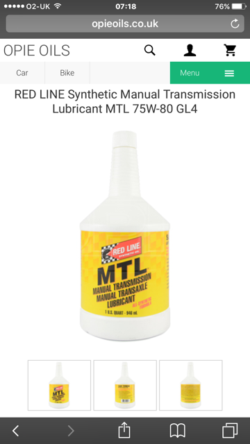

Redline 75/80 MTL gearbox oil used ...bloody Royal Purple prices as needed 2 as sold in US measures short of litres ..

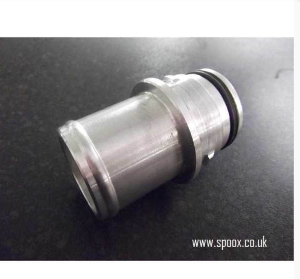

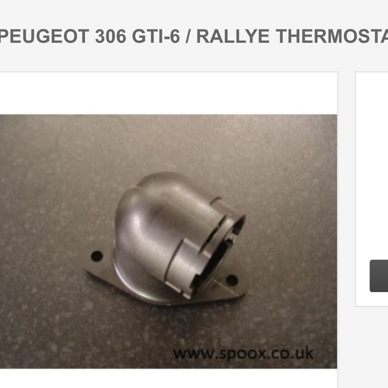

A slightly bigger issue is my Spoox Oring thermostat conversion water pipe is leaking water when moved at all ...not happy about this so I'm going to get rid & rethink
Picture of item leaking below ...
Goes into this
Going to see if this fits ?
