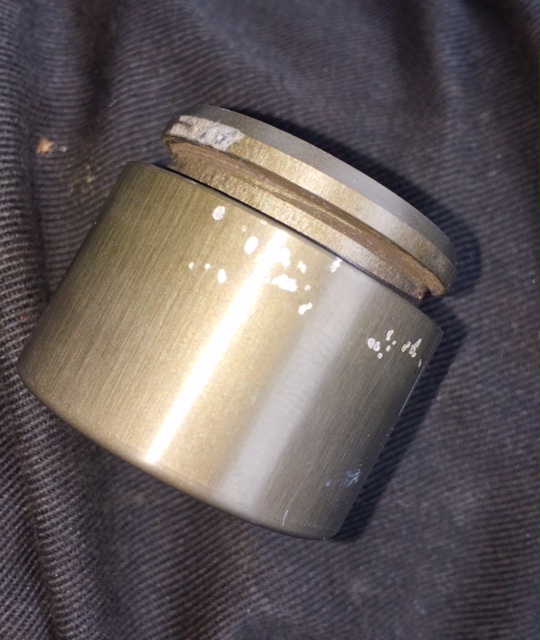

Little update ...Brembos totally refurbed & both back from Godspeed who do amazing brake work ...big thank you to Ben & his dad Ian...
Had one of the hard Alloy Anodized Pistons replaced as it was lazy & turned out to be pitted....
Pitted

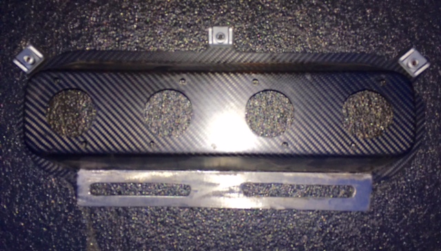

Carbon fibre Airfilter housing mended with 1.2mm Stainless & bonded & clamped onto the Carbon Fibre

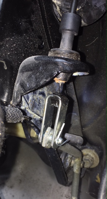

Throttle cable linkage to pedal now has metal end ...getting rid of those plastic breakable things ...

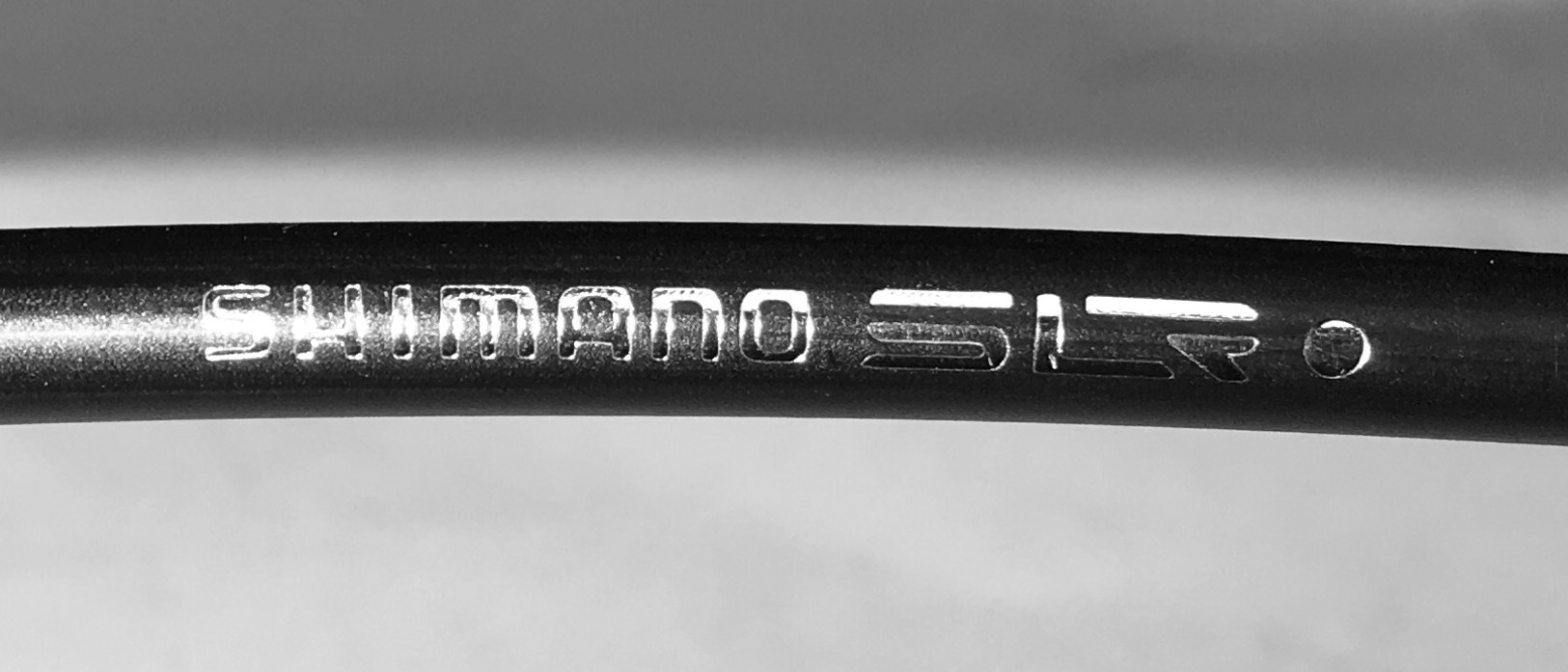

Also used a MTB top end Brake cable with PTFE liner & used stupid price Nano Polymer white cable grease to make extra smooth.
Feels Soo light & frictionless now ....shortened the cable also by 18inch & turned the Jenvey linkage around to correct side
