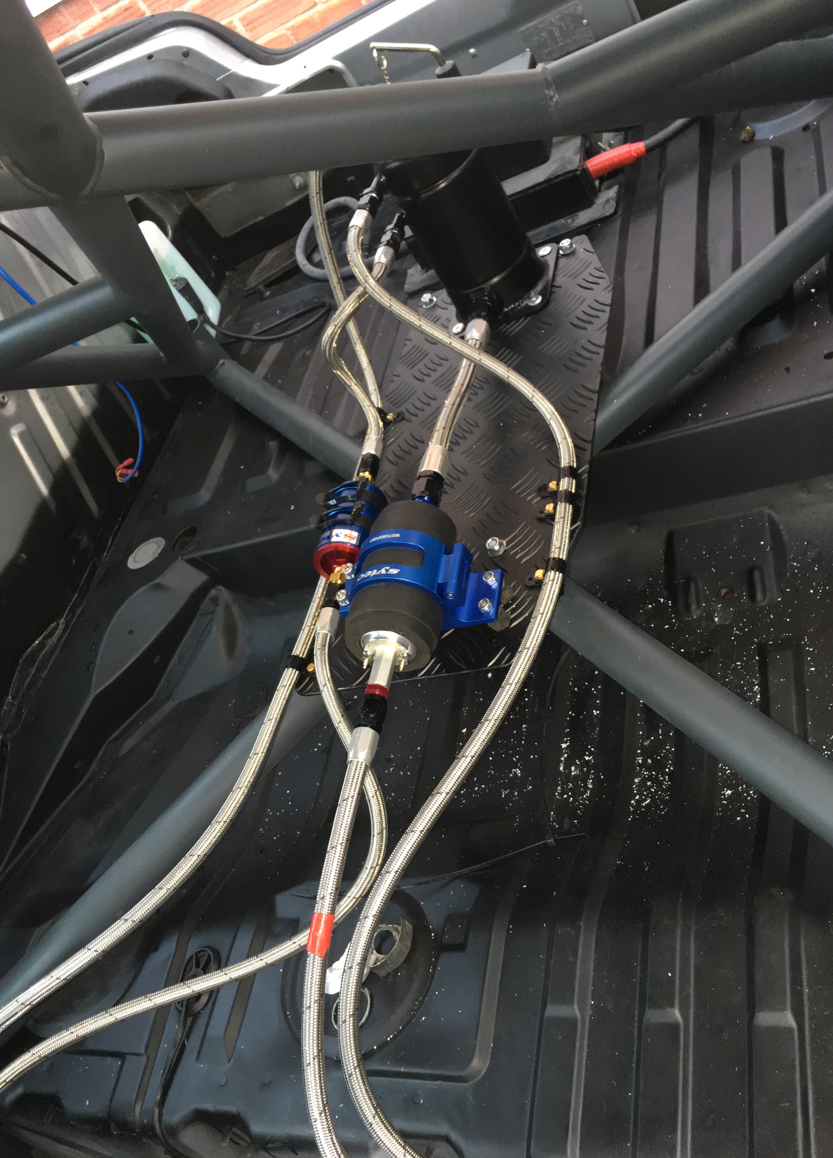

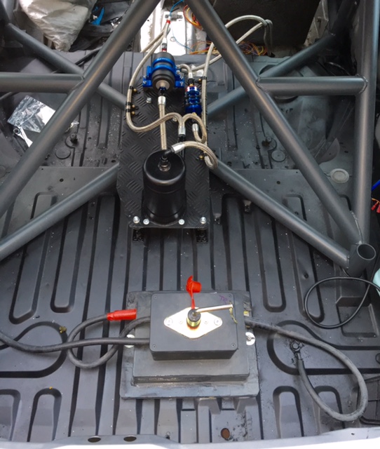

Jenvey throttle Cables now needs to be reversed & shortened by 18 inchs ..
All Full pipes fitted

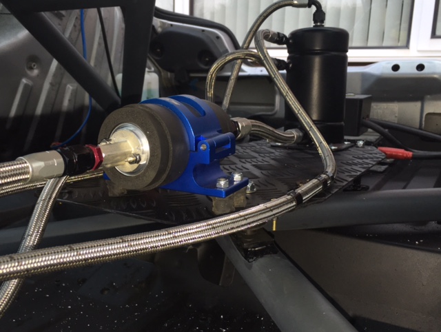

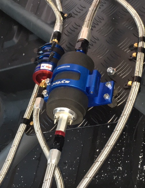

Swirl / pump / filter now finished & all fuel pipes fitted but need P Clipping down ....
Battery cables need extra covering & P clipping / tiding up
Alloy checker plate rubber mounted on floor
Fuel pump rubber Bobbin mounted also
Getting there after my Fire setback
Just need to vac up mess & connect power to my relay with 30amp cable & fuse Rofl
