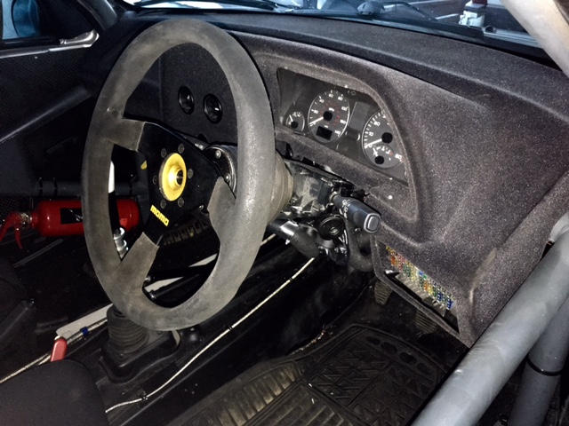

Been asked about fitted pictures of Ryan's Fibreglass dashes ...he's on Facebook & mainly The 6 forum ....

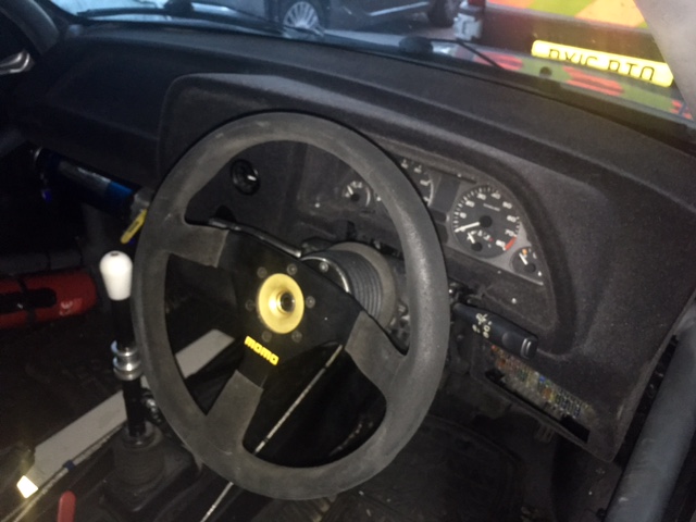

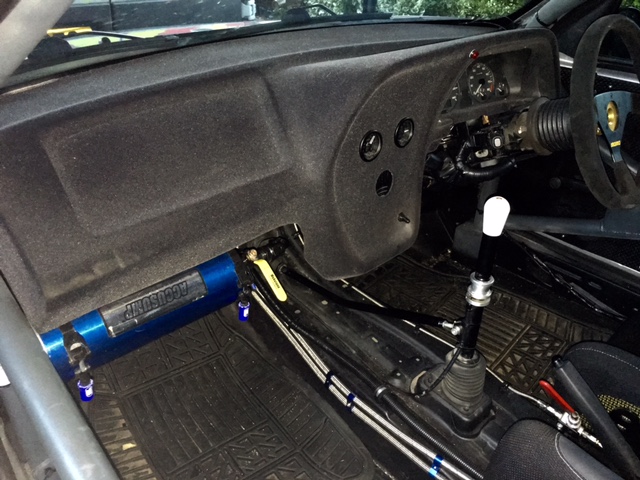

love the look of that dash!

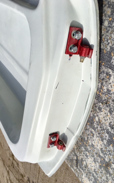

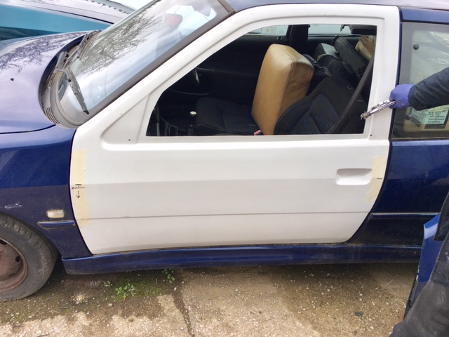

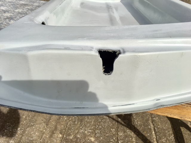

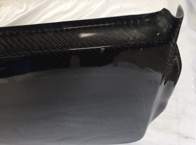

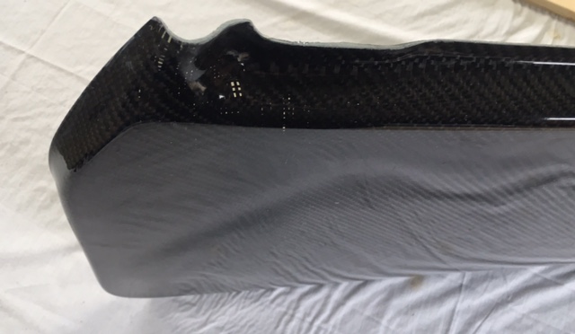

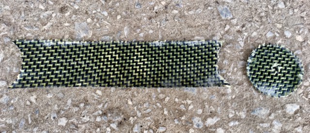

Kevlar/ carbon composite doors & Carbon Fibre door panels have arrived & ive been working on Passenger side first ... They have alloy 8mm plates I've had to drill through that are sandwiched between Kevlar where hinges bolt for extra strength... It was a ballach getting the hinges located in 95% correct height as no real template from original doors matched ...I got them just out height wise by 5mm meaning I had to drill x4 more holes again ...no big issue ....amazingly & im shocked the doors fit as good originals & are even stiffer at the top where the thieves normally bend them out... I'm going to be running Polycarb AR windows with 210mm square sliders bonded & bolted to the front doors & the size is much smaller than standard Polycarbonate standard door windows so I've made a template without opener just to make sure they are 100% made right all pics below (15-03-2017, 09:14 AM)Day666 Wrote: Not posted for a while .... Hinges Door side view Lock cut out Trial fitted on my m8s scrap 306 ...fits so well 100% Kevlar / carbon mix ...good to know Each door weighs 6.3kgs instead of 27kgs each standard ones so 40kgs ish saving
15-03-2017, 08:53 PM
Door cards look pimp mate
306 Rallye giving people a surprise because they think shes a 1.6 ;-) Silly people
Thank you
They has built in ashtray closers as handles ![]() Completely shaped to fit around the sides of the doors
