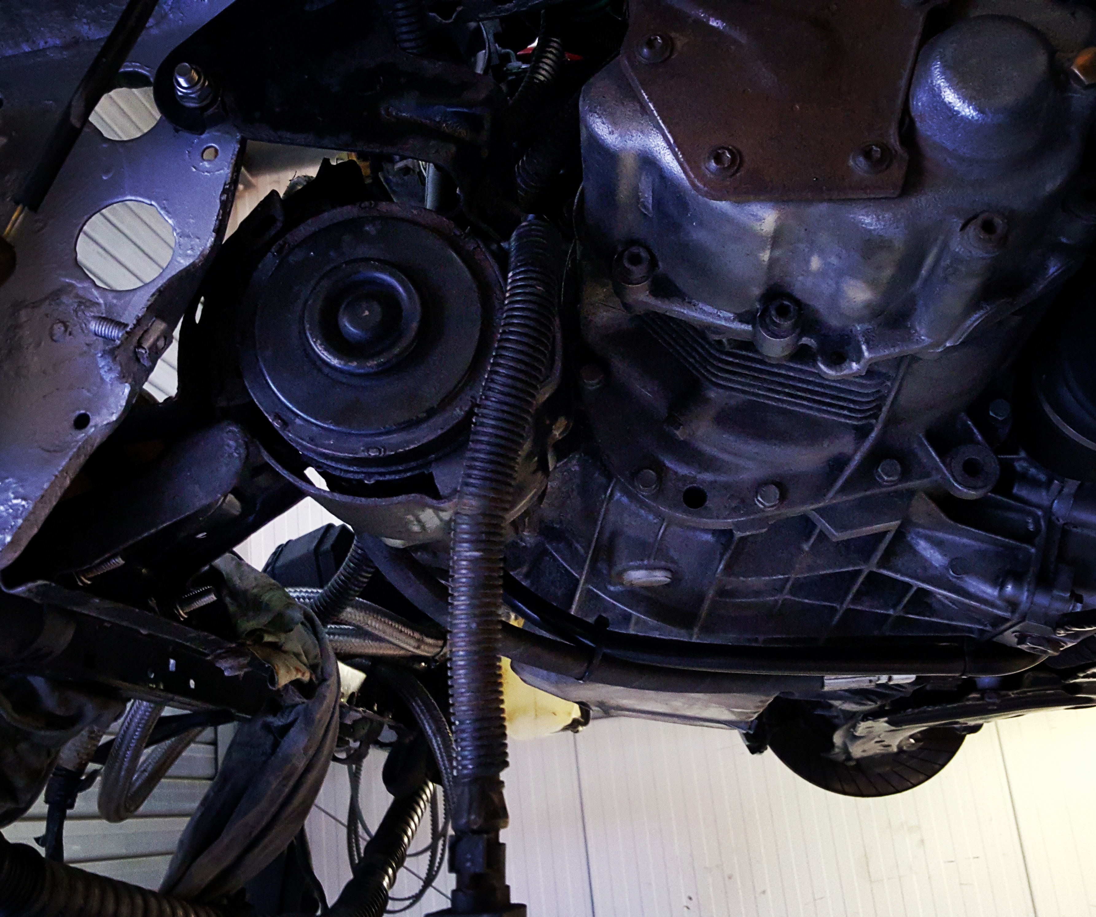

Collected my subframe earlier and set about refitting everything. Finally got everything ready to get the car on the road! (some assembly required)
Seen this on Facebook. Looks lovely.
Got a lot done today, inspired to get it on the road quicker than ever now I know how cheap it is to insure this year
Anyway, subframe fitted, interesting job by yourself involving balancing it on my shoulder while putting the bolts through with my free hand lol
Really glad I got it coated as it instantly makes everything underneath look 10x better
While the exhaust and gear linkages are off i finally got around to fitting the quickshift I've had for around 2 years lmao
Took about an hour of fiddling with the length of the shaft (giggedy)  to get it right, be interested to see how it is whilst driving, but just from changing gear sat in the car it feels a million times better than the knackered nylon ball did
I'll carry on tomorrow, hoping to get the struts and remaining front end back together and as much else as there's time for

Electric power steering pump mounted and connected, fits quite nicely in the same location as it would be on the 106 it was liberated from originally
