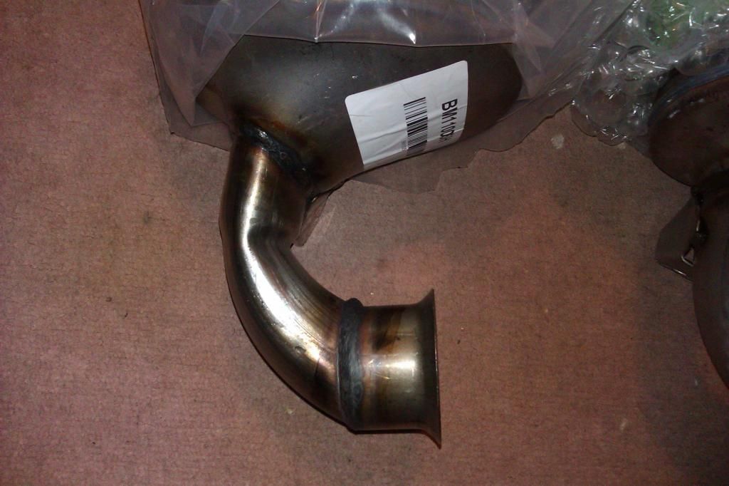

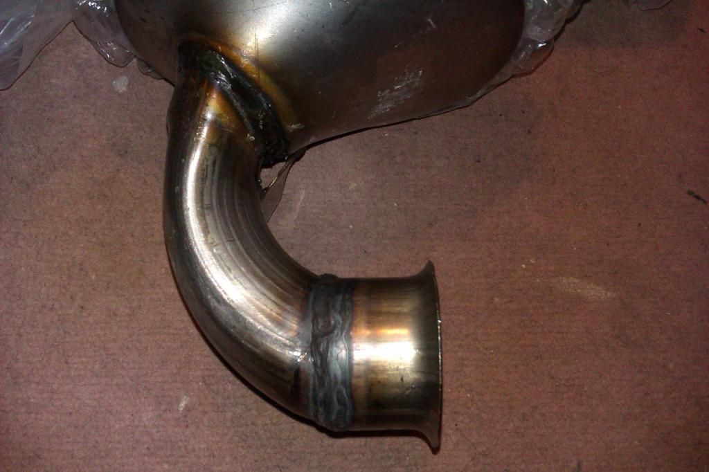

[Image: IMAG4196_zpsb99729a4.jpg]
[Image: IMAG4195_zpsfc7aeaf2.jpg]
[Image: IMAG4194_zpsbc6f2a5f.jpg]
Even without the kink that looks like quite a restriction!
Get that dpf gone and that 90bend done proper must open one of these up so much!
Its not a racecar lol...
I'd be interested to know if there is a noticeable difference though, but I'd guess not tbh. Don't forget the intake and turbo are tiny anyway lol!
I'd say thats much less of a restriction than the 306 HDi TIP tbh...always amazed how anything flows through there but they push 135bhp on std pipes...
