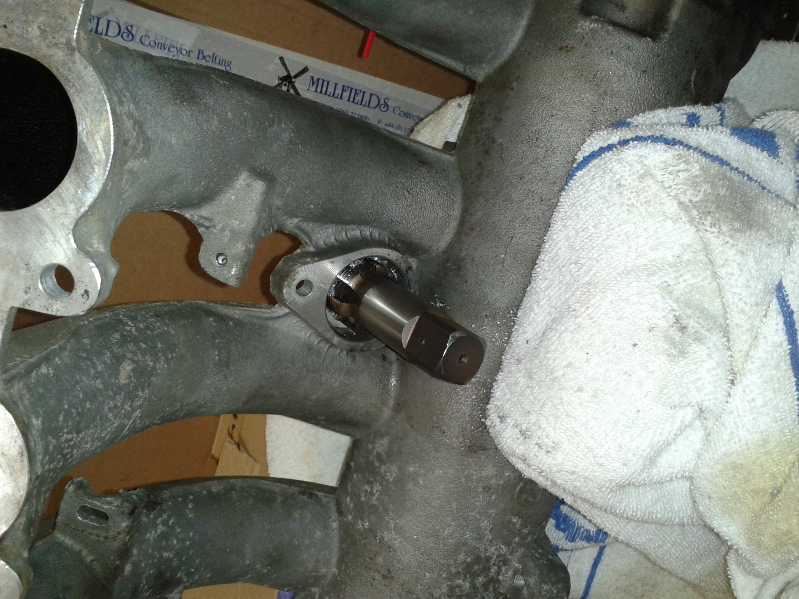

i might have found an inlet manifold under my pillow last night
it would be roude not to get it looking nice before its fitted Smile
tapped out the resinator hole to 1"bsp
pressure washed the manifold off washing out all the swarf before
fitting a 1" bsp plug sealed it with hydrolic threadlock
