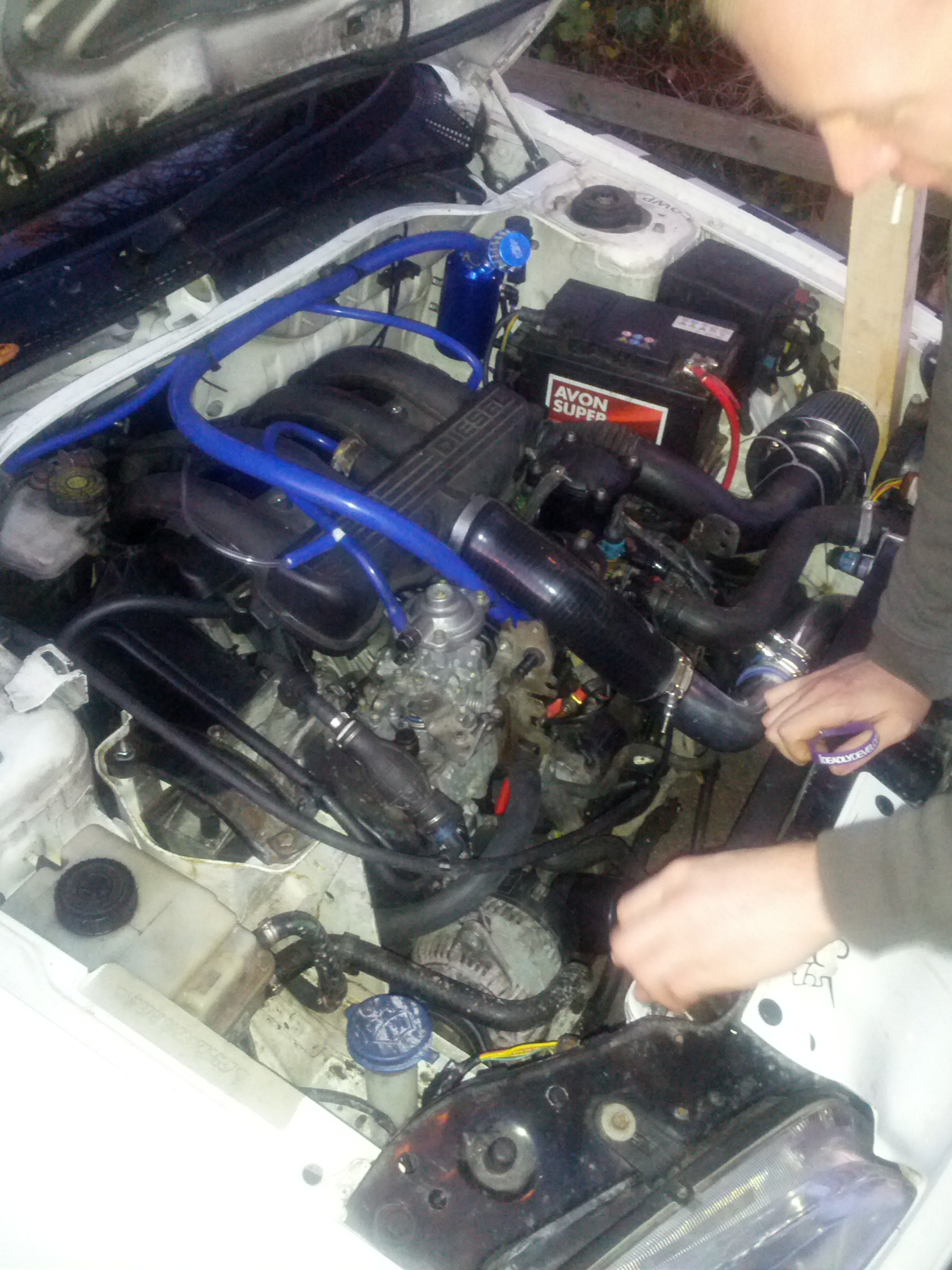

Your official photographer has a few cheeky pics for you.
Hope the axle were strong enough Tongue

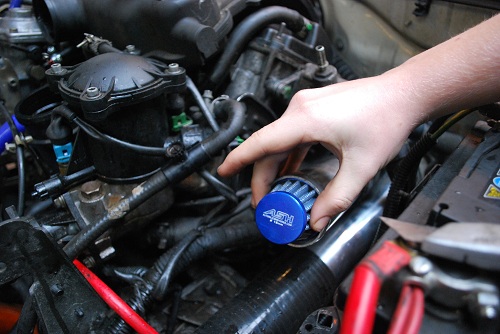

Revilutionary new air filter set up
Muppets....
The finished article Big Grin
