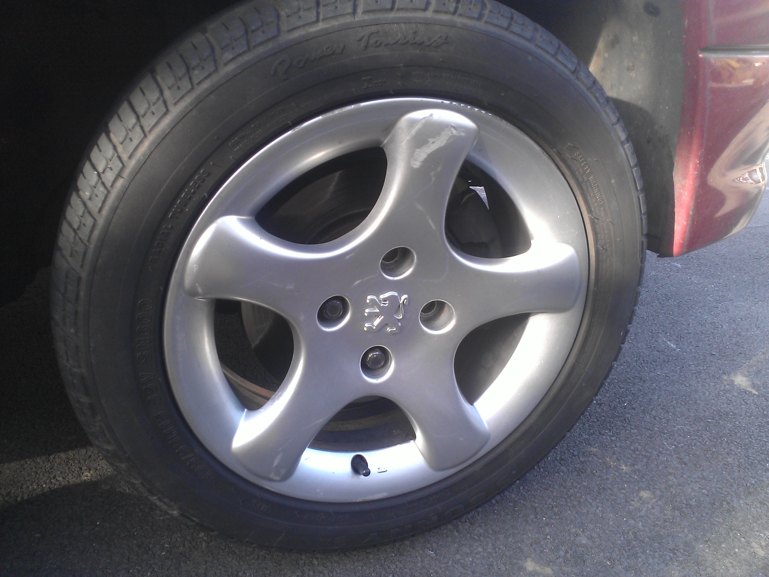

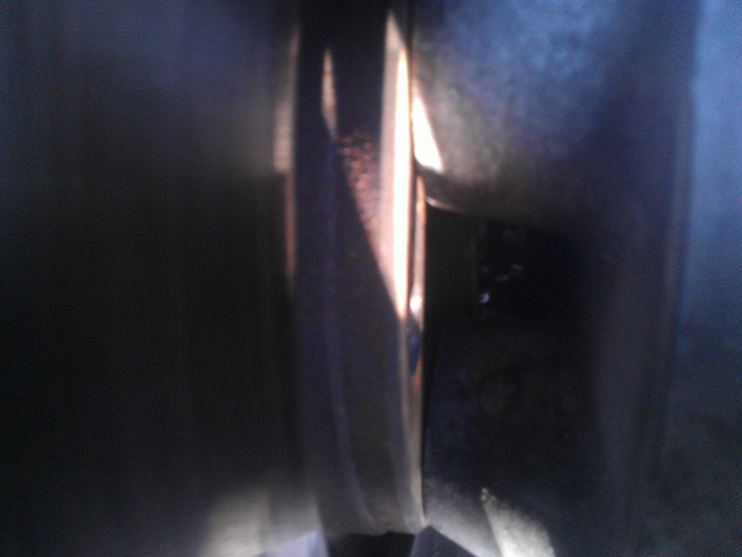

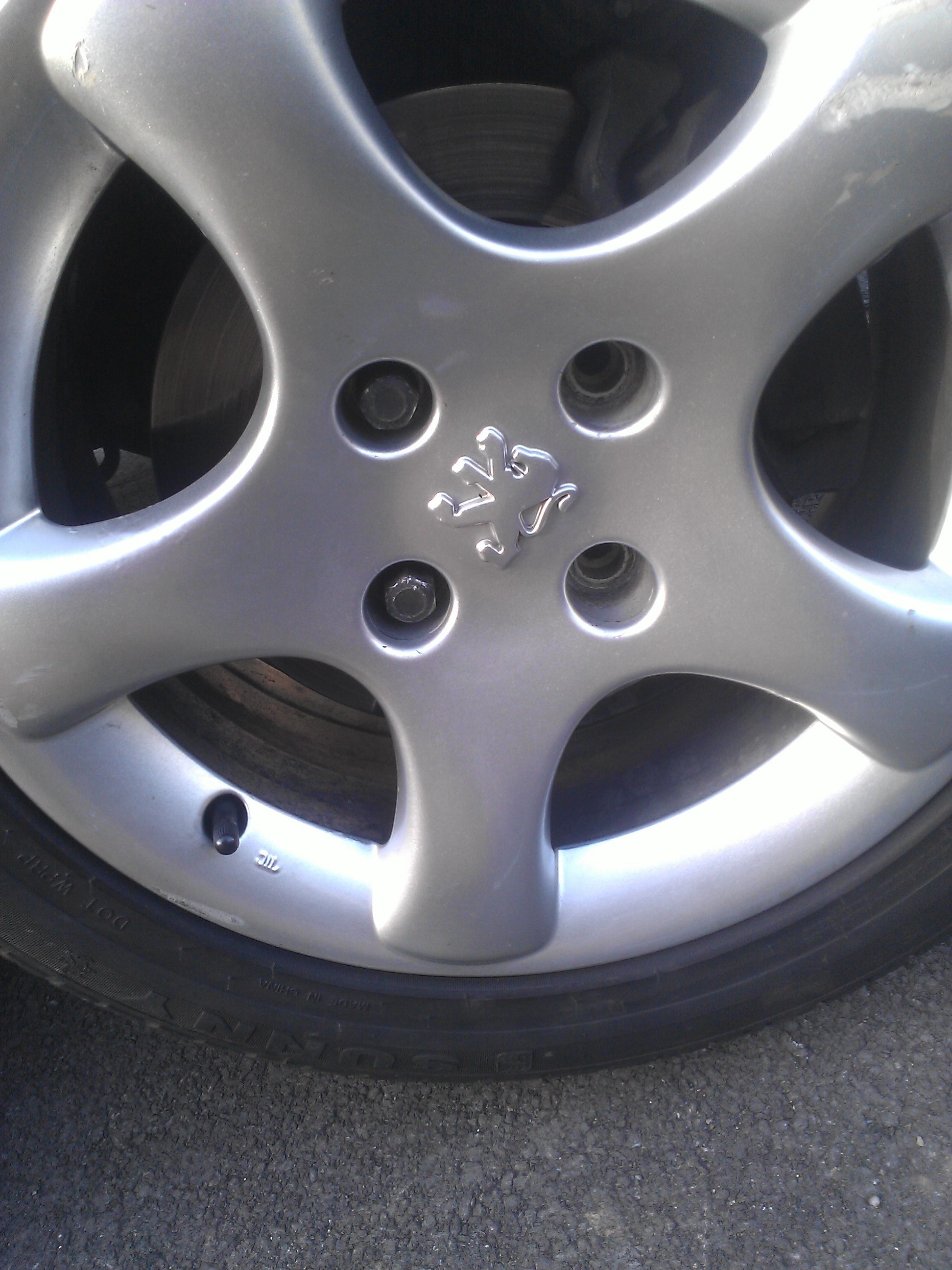

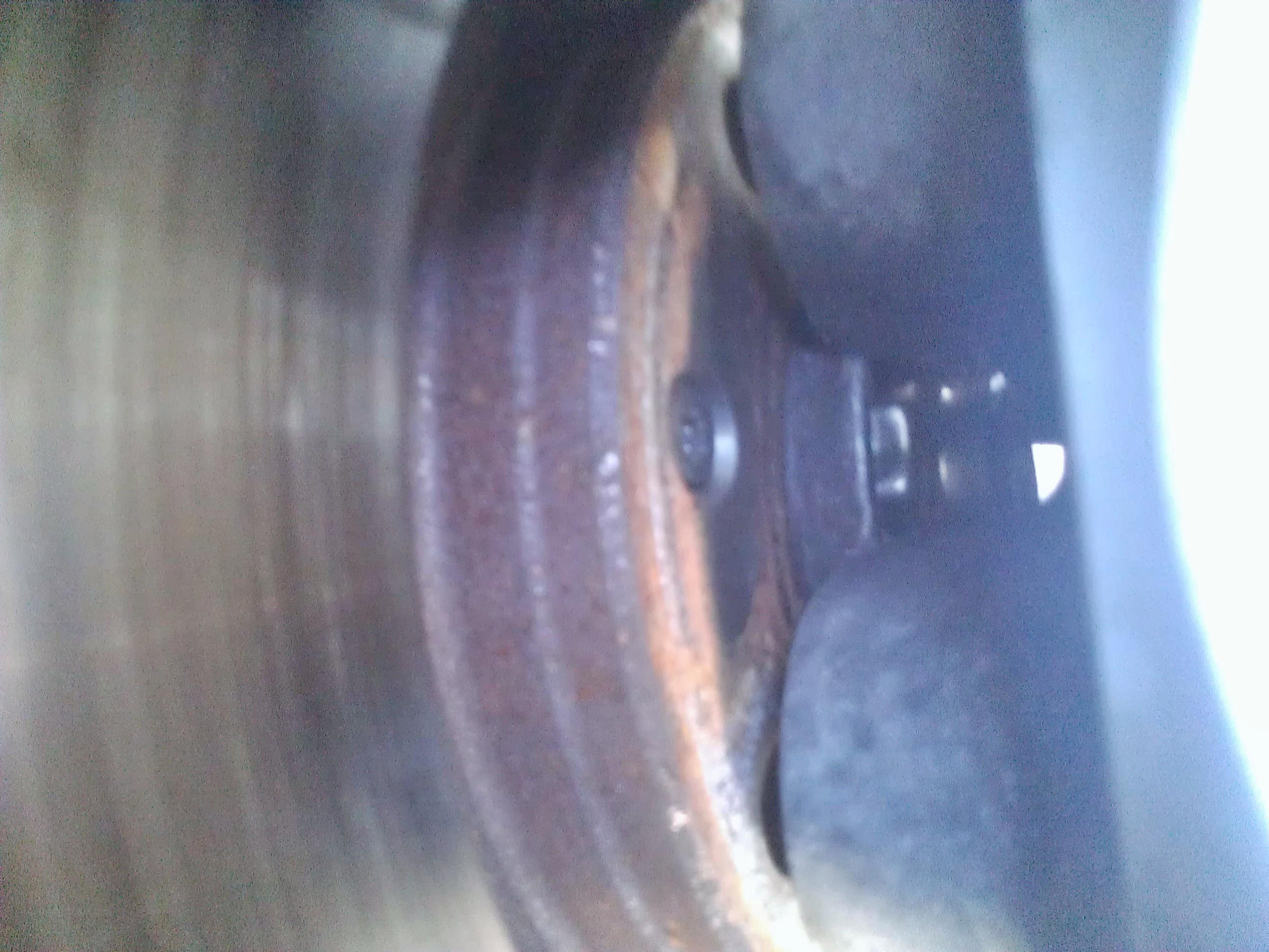

Got any pictures? Wheels inner bore, hub, and wheel bolts. Could help us abit

I would just clean up the hub lip and the center of the wheel, with some sandpaper, bit Of copper slip and push them badboys on
[Image: SDC10442-1.jpg]
Yeah but a bit of sandpaper on it. Had steelies on before? Will be a build up on crap on the centre from where the steelies have no middle. I had it on mine
