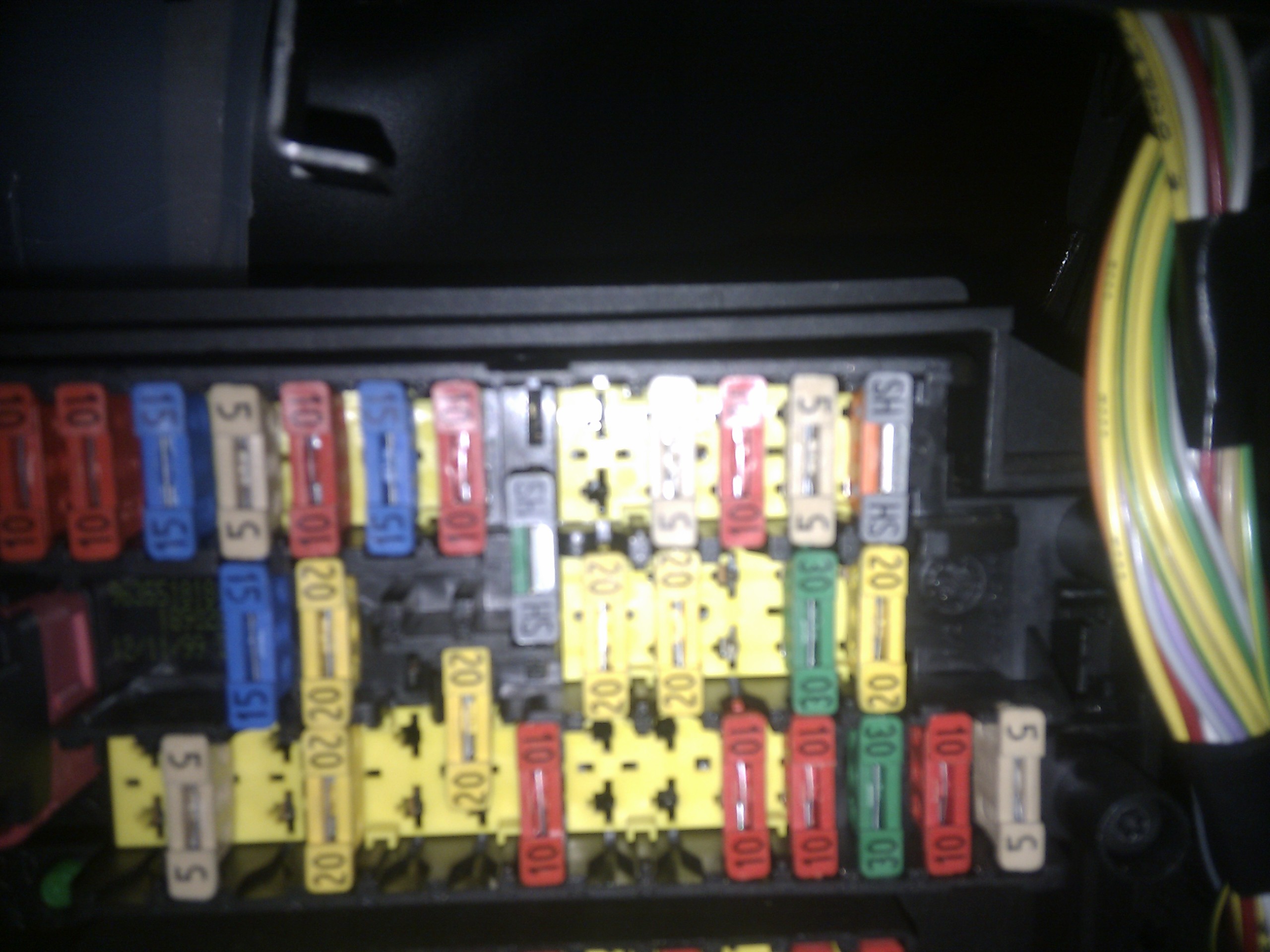

focus the camera better ad i will read the numbers check this photo the numbers are on the black edges by the fuses
[Image: DSCF7924.jpg]
Hmmm well I honestly couldn't see them yesterday when I was looking but if they are there, I guess I'll have to just FMyC lol
There isn't a numbered diagram of the fuse locations on the back of the cover is there Scott? Just an idea!

this one look right ?
your picture may be upside down
also the fuse numbers 29-40 are on a seperate fuse board numbered BH12

Thanks Cully, the second board in that pdf looks like mine.
And no, my camera was definitely the right way up lol
