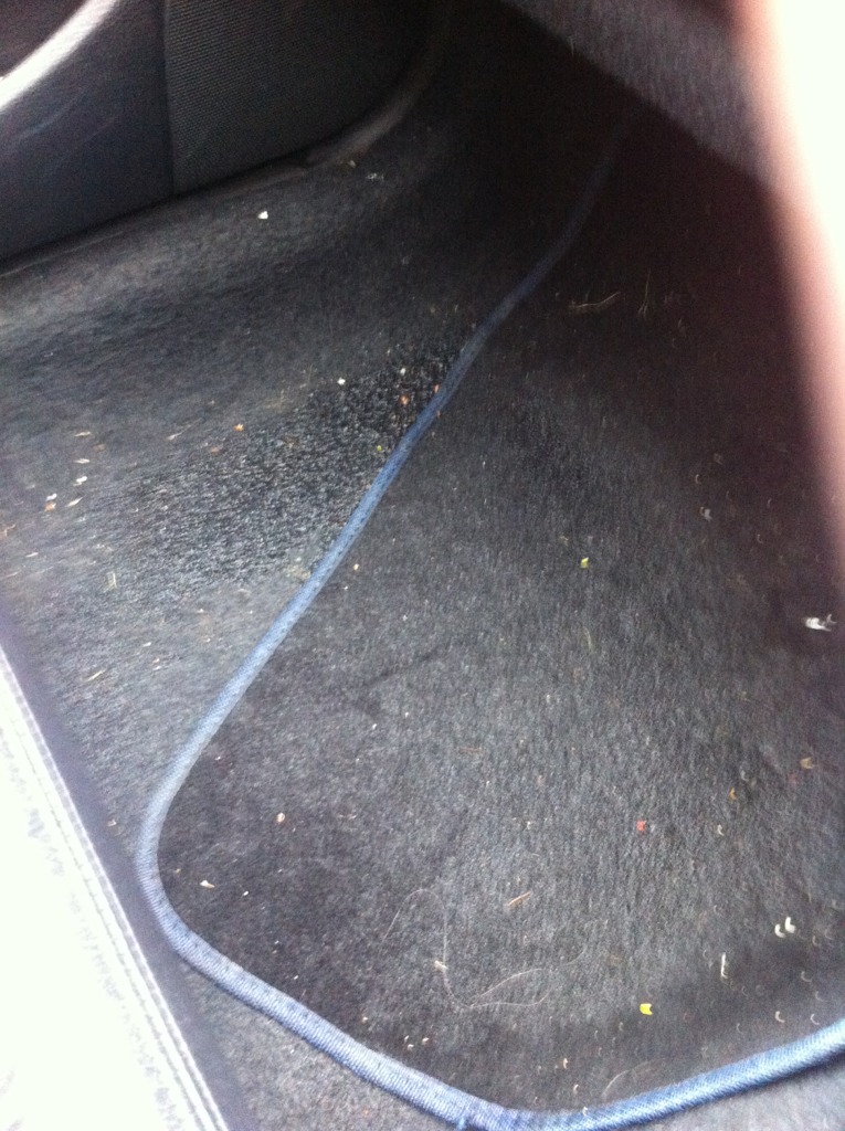

Got in the car today and saw this

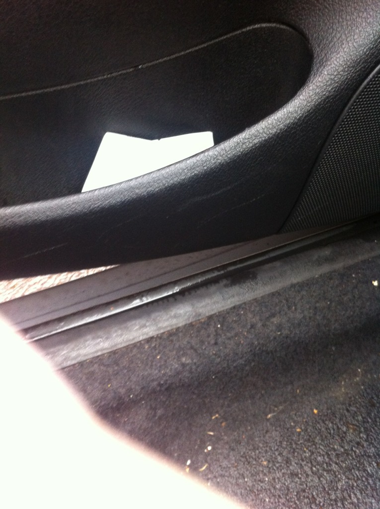

Any ideas? Automatically assumed seals but all along the top and sides are fine. As you can see in second pic the bottom of the door seal has filled up. Really confused

All 3 of mine have done this from time to time. Dry it out, and park facing uphill....
Its the seals, they're stupid, the drain hole is on the top side, just cut some holes on the bottom side and it can drain out the door instead of into the car
Just cut a hole in the bottom of the seal along the bottom of the door?
I'm having this problem too, huge puddle in the passenger footwell and I can see it running out of the bottom corner of the door when it's raining. Cut a hole on the outside edge of the deal then?
Yeah, that's all. It gets into the car because there's a hole in the top of the seal, if you run you finger along the seal you can squeeze the water out and see it happening
