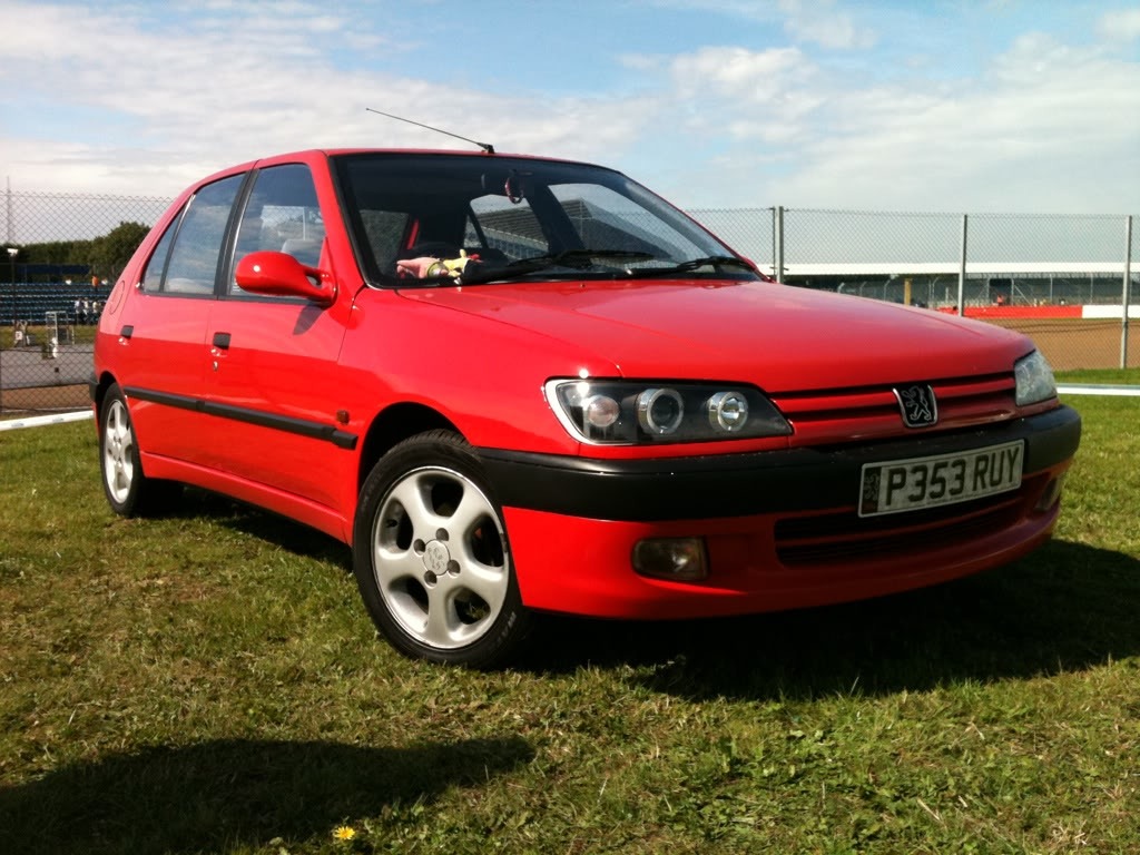

I'm thinking of changing my 3door DT phase 1 front bumper to a phase 3 one but was wondering if they are just a straight change or if there a pain in the arse any help would be great

should just be a straight swap
It'll fit fine but IIRC there will be a gap between the bumper and the grill and it won't really look right, unless you do the whole lot...
Plus unless you're doing a full on conversion I think it'll just look out of place, only car I can think of is Darren's... But his pulls it off as he didn't do it for looks and his car is full of awesome.

Bonnet, slam panel, headights, bumper and grille. All a straight swap
Are the wings the same?
Official Team Go-NAD fan club
Yeah wings are the same
As curt says it looks silly if you only do the bumper
It only looks right if you put a massive cooler behinde it lol
I think it looks kinda weird just sticking a ph3 bumper on a ph1.
So unless your changing the lot then don't. Lol
Look for a pic of my miami dturbo and you'll see how they don't fit Tongue
Notice the gap under the grill Smile
[Image: 100_5075.jpg]
I think if you going to do it looks much better with phase 2 bumper.
But either way you have the gap.
