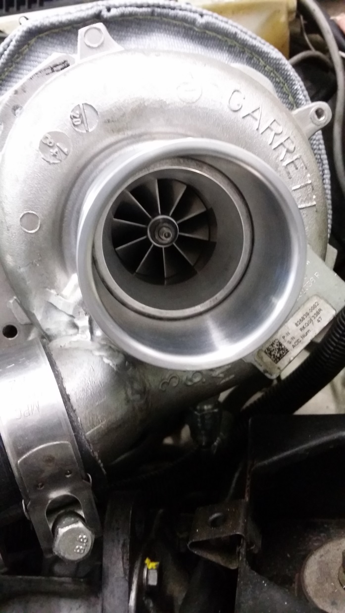

Hi Piggy
In fact, it's a GTB2060VKLR with a MFS 62MM
I changed the angle of the outlet compressor
For the fitting of the KN filter, i made an adaptator
