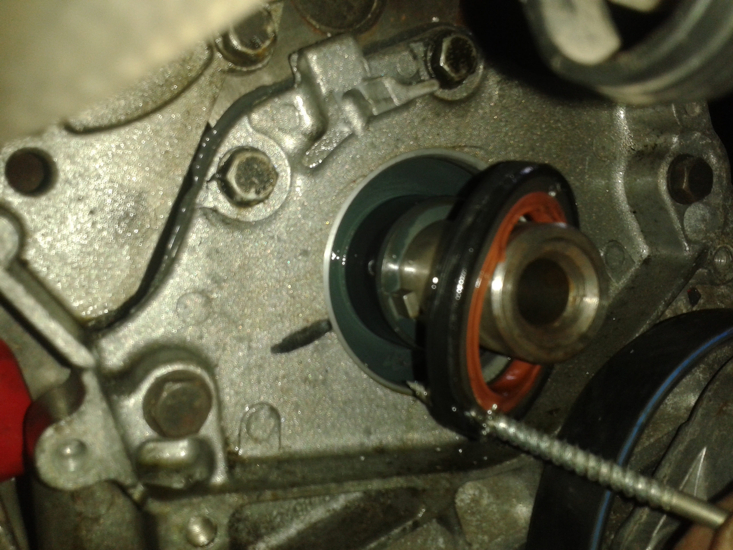

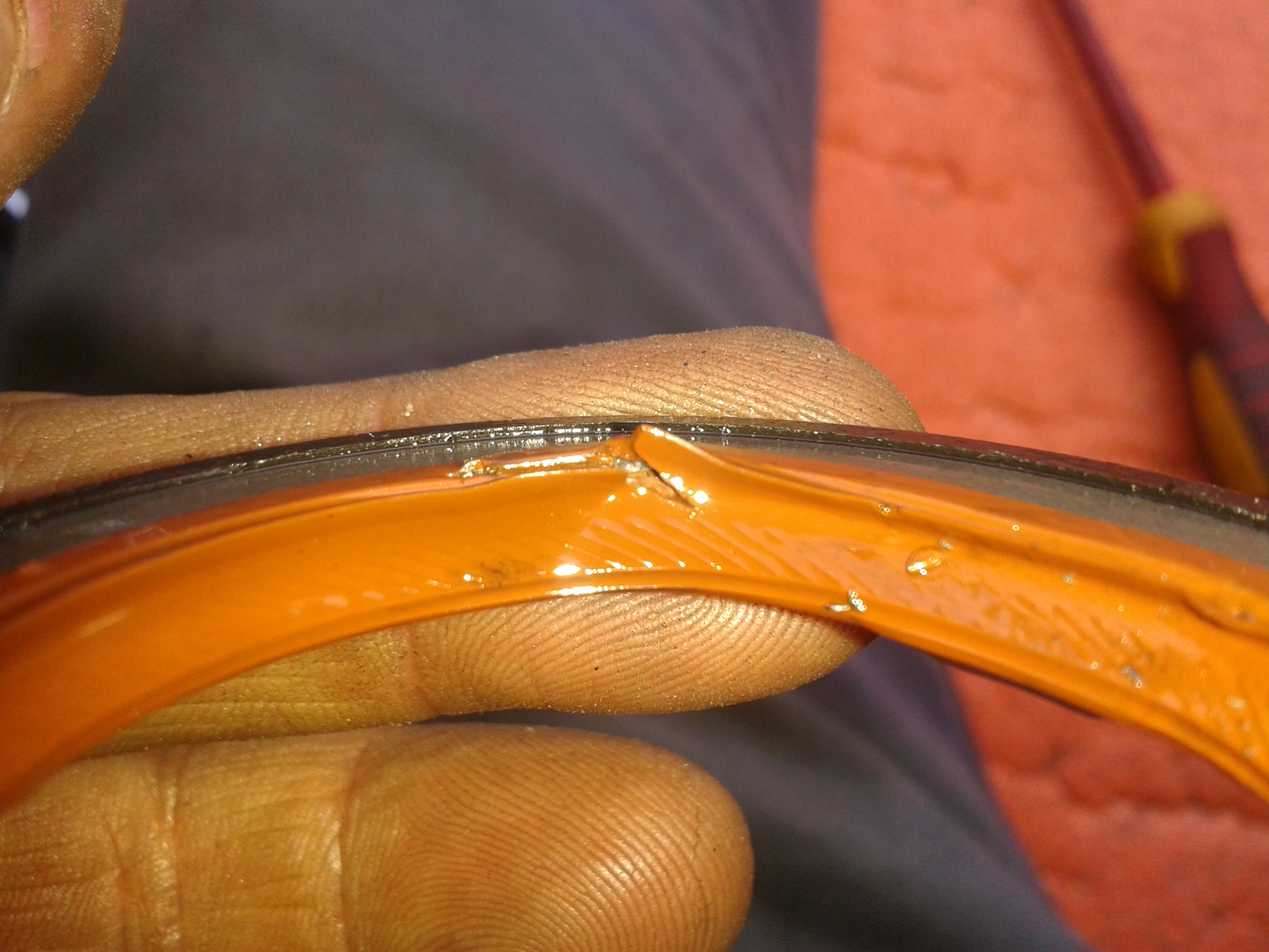

quick guide on how to get out and replacing a oil seal on a crank
locate oil leak strip down to expose damaged seal
drill small hole in seal casing maybe 2 at 180degs
insert screw and slowly screw into the seal which should start to press the seal out of the housing if this dont work add a second screw at 180 degrees and use both to press seal out
refit new seal buy tapping into position
check all faces and reasemble
