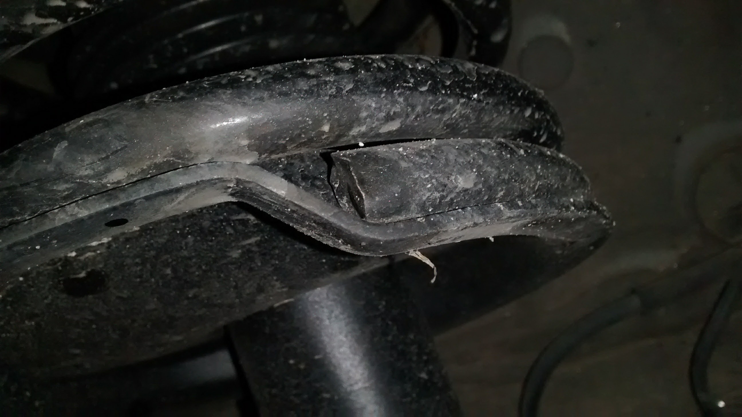

Rcently I put a pair of B4 with Eibach pro kit 30mm springs and I'm not happy at all.
Springs, shocks, rubber mounts are new.
I had to cut 3cm from the bump stops because it was sitting on them. Even like this, the car crashes hard even on small bumps, especially with two larger blokes on the front seats.
It looks like the first two coils are binding. The picture is taken on an empty car.
Eibach reference is correct. Unfortunately for xsara there is only one reference in Eibach catalogue, regardless of engine.
Is this normal behavior?

What engine were those springs designed for? What's the part number?
Sounds to me like they are the springs from a smaller engined car, or a different car entirely. They should not be very low at all, around -15-30mm from standard height from memory.

sounds like you've been sent completely the wrong springs
no way should they sit low enough to bind or be on the bump stops regardless of engine?
must be off something much smaller and lighter - 106 or similar?

how odd
im running same springs with b8 on a zx with xud engine
drop is around -30mm from standard - nowhere near bumpstops, and not coilbound.

thats normal, standard springs do that too.
ccheck the numbers on the springs

(10-10-2016, 04:47 PM)welshpug Wrote: thats normal, standard springs do that too.
Standard springs bind their first coils too? Never knew that.
Numbers on the springs are correct.
Yes, it's the way the seats are designed to take stress off the last coil, helps stop springs snapping. That's why cut springs don't fit right.
Thanks given by: wld
Thanks. So the problem is somewhere else, bilsteins or strut tops. I'll have to investigate further.
Check the strut hasnt gone too far into the hub...cant see how but maybe.
Also perhaps check the strut top bearings are right way round and correct.
Damper itself wont lower a vehicle. Could still be wrong springs...like saxo springs
Problem solved. The bump stops were still too long. Cut another cm or so from them and now everything is OK, even when the car is laden. The stops were new and are shorter by ~40mm now. By comparing with a similar car, mine is lowered by ~35mm.
