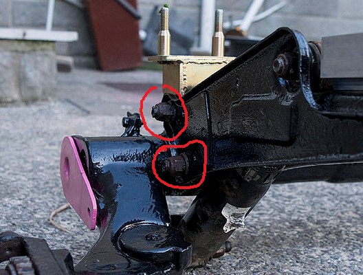

I did notice a couple of things in your build.  The bolts fixing the mounts to the beam were the wrong way around in one of the pictures with the beam off the car (left side).  With the nuts on the outside they will foul the swing arm.  I think you may have spotted that though as you've got them the right way around on a later picture with the beam on the car (but that pic shows the RHS).

Quote:I did notice a couple of things in your build.  The bolts fixing the mounts to the beam were the wrong way around in one of the pictures with the beam off the car (left side).  With the nuts on the outside they will foul the swing arm.  I think you may have spotted that though as you've got them the right way around on a later picture with the beam on the car (but that pic shows the RHS).
Yeah we swapped the bolts round dad noticed that too, I put them on that way round because it was easier than trying to pry the sway arm down to get the bolt in. Doesn;t pay to cut corners though Wink
