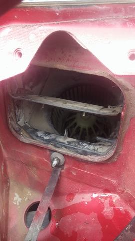

So I took out the scuttle panel and i didn't find the resistor, i found this:
Mine is a ph1, any thoughts were the resistor at ?
On haynes manual says that is in that spot i belive, but i didnt find anyting

I tried looking for the resistor pack, but its not under the scuttle panel (see pic above).
The blower it's only working at fully speed or speed 4, mine as an auto funtion to. If i click the AC or the recycling button, nothing happens. I see no light at them.

resistor on ac models are on the body of the blower motor iirc
(04-06-2016, 06:15 AM)welshpug Wrote: resistor on ac models are on the body of the blower motor iirc
Alright ! Many thanks !!
I replaced the motor and test it on my estate and the motor it's okay. Maybe its an wire loom issue?
