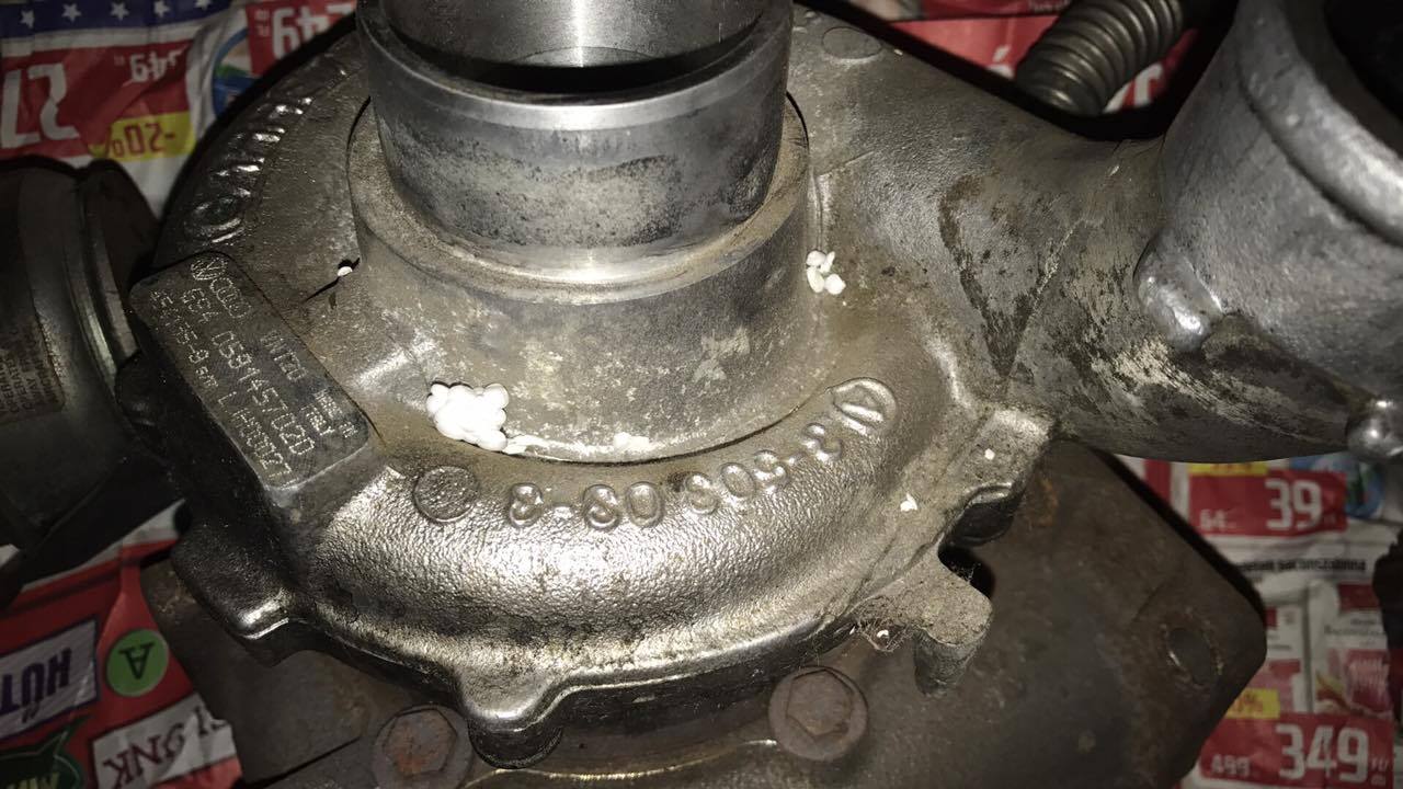

Hi Guys,
Does anyone know, if the Garrett VNT20 turbo (off of an Audi 2,5V6 TDI) is the same as the Gt2052V? Will the VNT20 be good for my XUD?
Thanks!
http://www.dieselevante.it/turbochargers.asp
looks like its a gt2052vnt off 155bhp version. should probably be ok for 170ish i reckon with correct fuelling etc
(26-06-2017, 05:48 PM)bashbarnard Wrote: http://www.dieselevante.it/turbochargers.asp
Thanks a lot! Very useful link.
No worries man. Someone on here sent me this site once. Cant remember who though, point is i cant take credit for it
