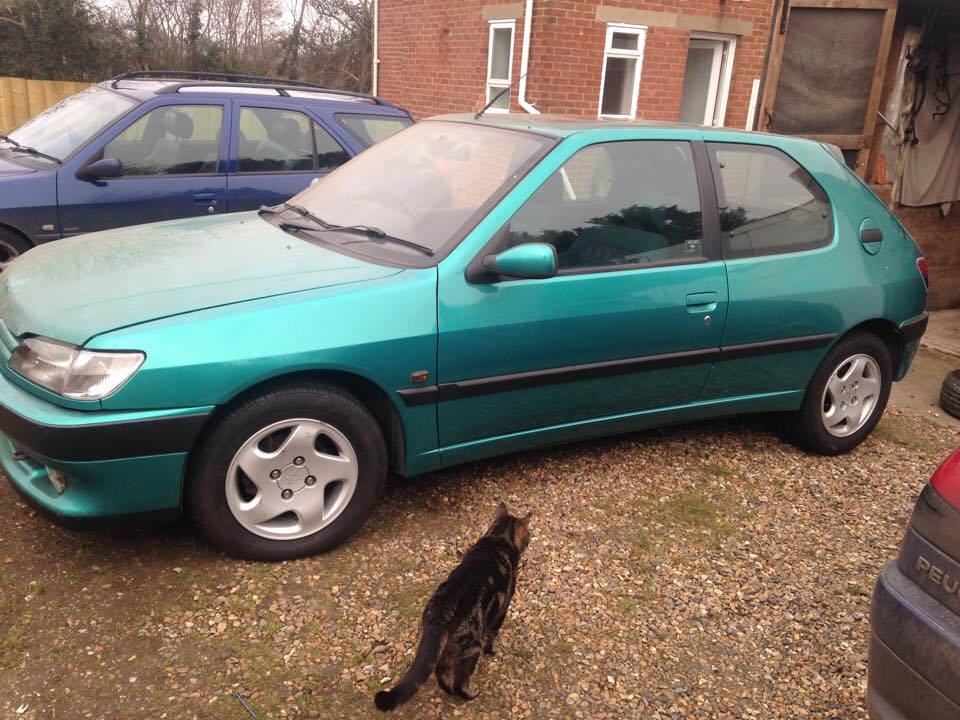

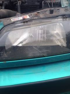

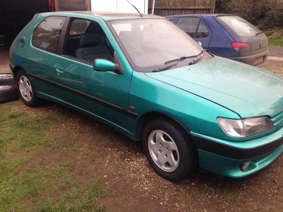

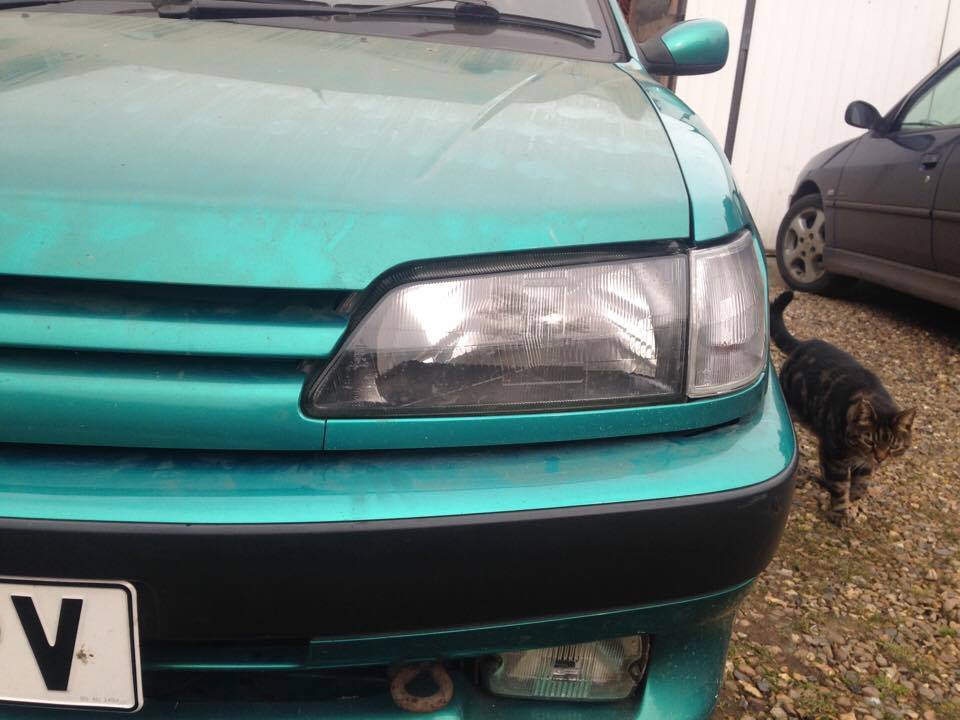

We spent sometime the other week doing a few little cosmetic bits to the car using some bits salvaged from the other phase 1 we scrapped. Changed one of my headlights as the old one had a massive crack in it (photo doesn't do it justice and apologies for the photo bombing cat haha) and also changed the battery tray as mine was a bit rusty and old looking.
The biggest change was I got rid of the cyclones (!) and put the original d turbo wheels on. I know they're not lookers but as I'm going standard the clones had to go. The cat just had to make an appearance again but as he's named Blaze after the 306 colour I feel he deserves his 2 seconds of fame on here Big Grin

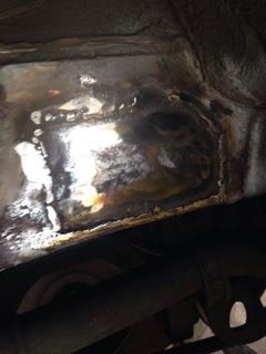

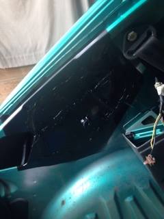

We (and this is the royal 'we' as I cannot weld so all the hard work is down to my personal mechanic/husband Bash!) started in the usual rear wheel arch section and found the first bit which is now all welded up.

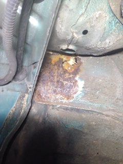

Then we moved to the front of the car and found some more on the offside front chassis leg near the bottom pully

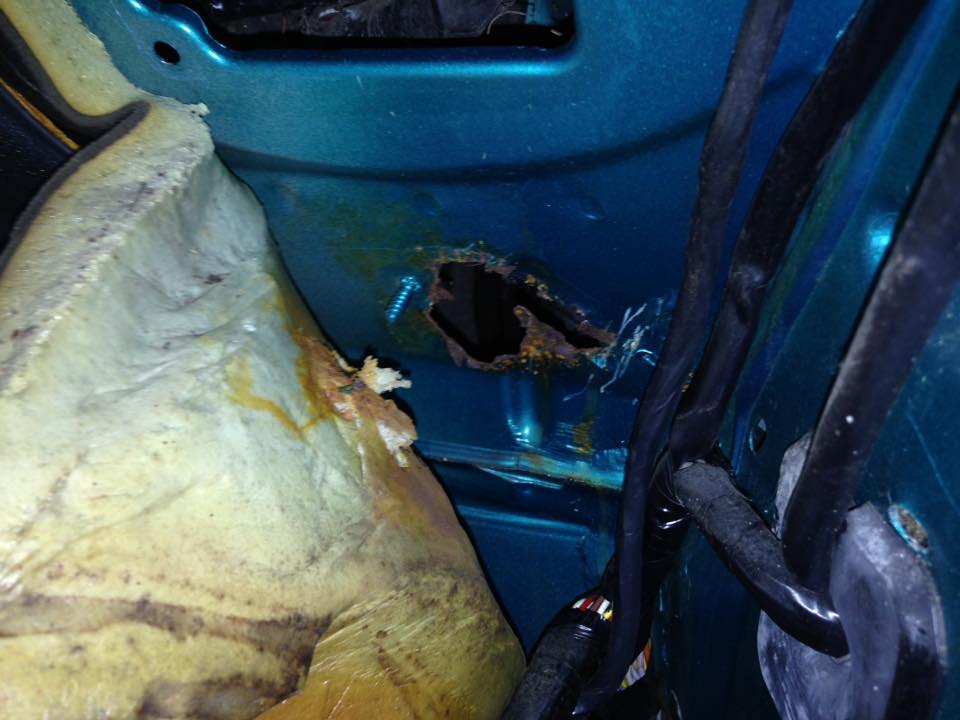

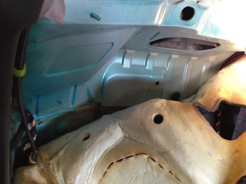

The next bit of rust is a complete bugger though... It's up in the front wheel arch in the firewall/bulkhead area, so really inaccessible. This now means it's a complete dash out job to get to it from the other side and also check to see if the same place on the other side has rusted. While the dash is out we're also going to do the heater matrix as we've not done it yet and seems silly not to while we've got everything in bits!

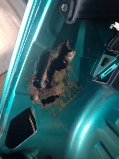

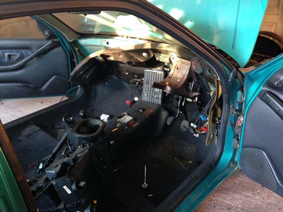

So the dash is out!!
The hole we saw from in the wheel arch has been well poked and it's a fair size, but the good news is it's the only one as the rest of the bulkhead is all solid!
I've been informed that the hole is going to be a pain to weld as it's on the seam so it'll be a good 5 hours of work to get it all ready to go back together. Then to check the other chassis leg and the sills...

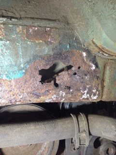

So ive got a little further now. The dash is back in and working and bulkhead welded and spent all day today rebuilding the back half of the sill. Had a friend come over and fab up the plates while i welded them in. However the deadline of this for pugfest is drawing closer and closer and with an esitimated 20 plus hours still to go on it ive pulled the plug on this year. I refuse to do a half arsed job on a car like this so it will see show season next year and ill keep going on this getting her properly done for next year. Its a shame to be honest bit i cant bodge something like this.
[Image: 3f7220cdd9782beb88dbabcab5782f8c.jpg][Image: 287cc2b4cb84a728a89afe5411a2b13a.jpg][Image: a335998c37f4d014f047e38427405902.jpg]
[Image: 0a7890809d70aa9b6f2262193df51b62.jpg][Image: 92b3f73ca897bead39fd8165c241f1b3.jpg][Image: a884dee556e39f586d5fd2172626f212.jpg][Image: 014835f180a3766d7a3906825db53fb0.jpg]
So the rust yu see on the new plate is just a very light surface rust than got taken off before these plates were welded in. All the plates got weld through primer on the back sode of them as well to protect from the inside as well.
