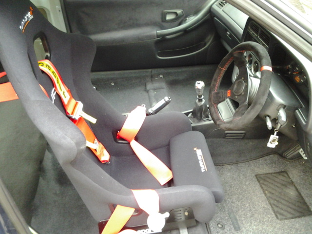

Haven't updated the build forma while and few things are happening so here it is.
I have now got omp subframes to replace my makeshift ones.
a corbeau fg seat, if not designed for a small childs ass. Oh well, only skinny passengers now.
replaced the near side ball joint, found the leak from my rear tyre, seems to be a leaky valve.
fixed the leak from the radiator and finally but not least ordered, recieved and begun the painting of ky new beautiful omp cage. Cant wait to get this badboy fitted.
Red is the choice colour, what do you reakon?
