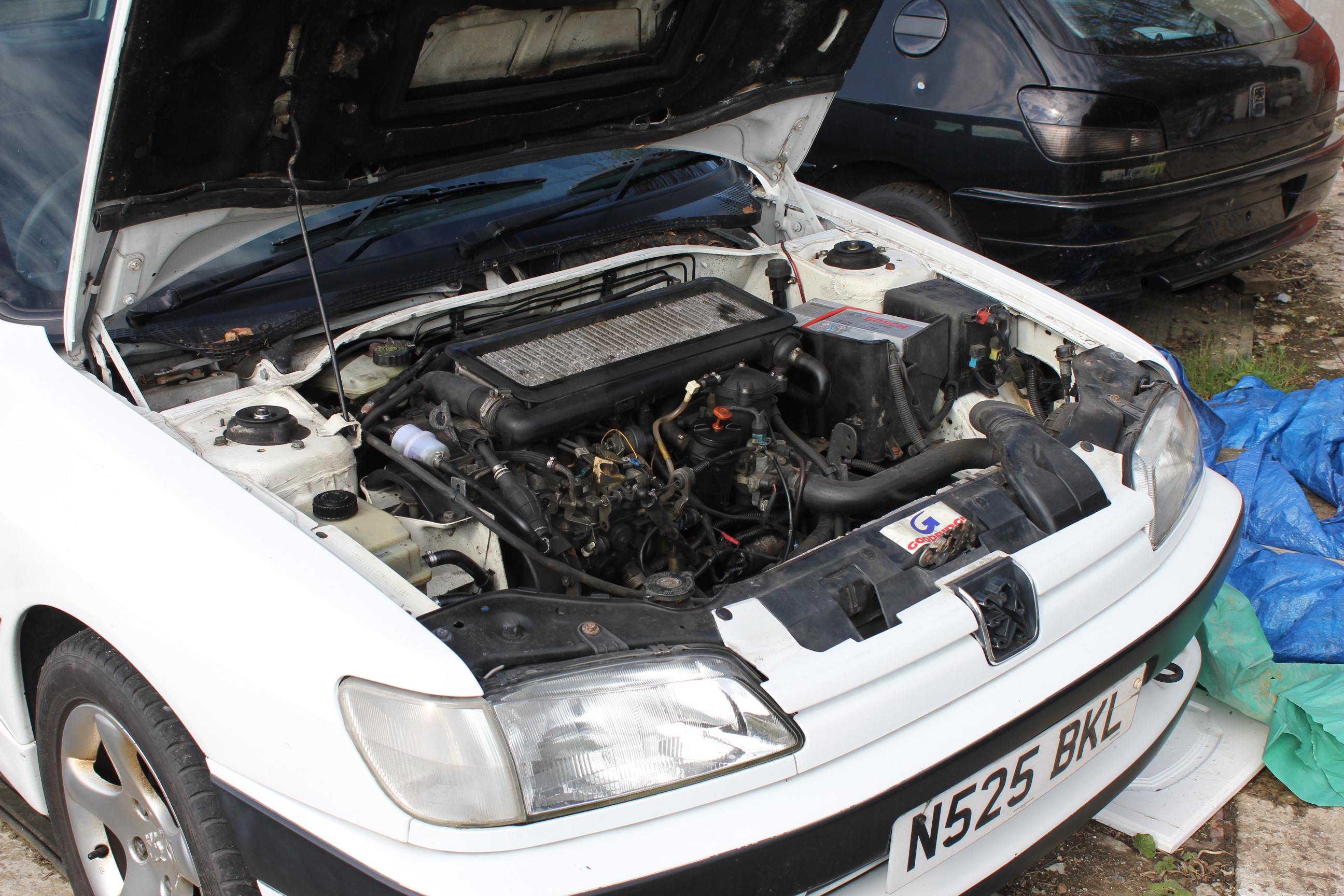

Just took some more photos, think it needs a good service to stop it running lumpy on startup.

Looking at the pump it seems to have been messed with in terms of wiring, can anyone tell me if it has been, i know the car has had an engine change in its history, so all sorts may have happened in that change.

doesn't look to bad..
Does it have 2 fuel filters tho?
I thought the fuel filter next to the top engine mount looked a bit out of place, but ive only had one dturbo before and i can't remember.
Fozzy Wrote:I thought the fuel filter next to the top engine mount looked a bit out of place, but ive only had one dturbo before and i can't remember.
Yeah it is out of place, 1 filter will probably be enough, just remove the extra one and join it through but check that there is actually a filter in the original housing and that the fuel is actaully passing through it first! lol

Just to confirm without actually going ad following fuel lines that the real fuel filter should be in the black cylinder to the right of the dipstick. If there is a filter in there too i bet my fuel is super clean haha
Fozzy Wrote:Just to confirm without actually going ad following fuel lines that the real fuel filter should be in the black cylinder to the right of the dipstick. If there is a filter in there too i bet my fuel is super clean haha
Yeah it is, its also a heat exchanger at the bottom, I say check as it might have been plumbed out and replaced with the in line one by someone who was having problems with air getting in as the housings are a PITA for it if they aren't sealed properly!
Team Orange Engine Bay
Now im intrigued to see if it has been removed off i go to have a look
Originally filter housing still has fuel in it, but what i have noticed is the grenade pump does go soft when left and has to be pumped to get it hard again (que the innuendoes) Is this normal, i really am clueless with this engine
Fozzy Wrote:Originally filter housing still has fuel in it, but what i have noticed is the grenade pump does go soft when left and has to be pumped to get it hard again (que the innuendoes) Is this normal, i really am clueless with this engine
It should stay hard (gigidy) the grenades have a one way valve in which could have become 2 way, that is a fairly common problem Smile

It probably had a Bosch on the original engine, so yeah it does look like the wiring has been messed with

No reason why that shouldn't work, its effectively the same thing but IIRC they are fairly cheap off pug anyway if you wanted a genuine one Smile
If it was Bosch previously or not shouldn't make any difference to changing it over, its a pretty simple process and you can't really get it wrong mate! Do you have the injector supply lines for the Bosch?
