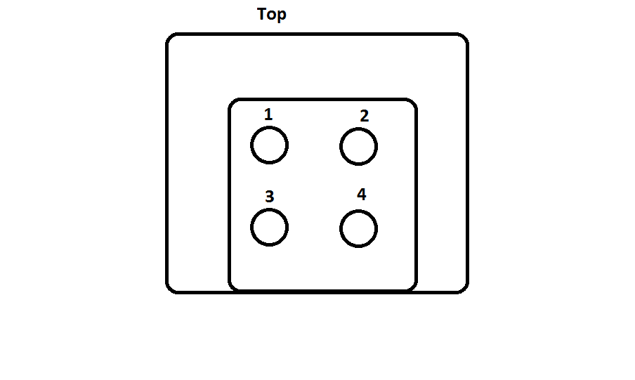

just making sure i got the order of the injectors correct on the pump?
Ben Jay Wrote:just making sure i got the order of the injectors correct on the pump?
Nope, not if you have done the Bosch like that, pretty sure its
1 3
2 4
or similar, pretty certain yours is wrong, the fuel lines only fit in one place unless you bend the hell out of them so its pretty hard to get wrong, can check at lunch though if you like?

Any one know if mark has the right order?
Ben Jay Wrote:Any one know if mark has the right order?
Going for lunch now so can check for you Smile
Team Orange Engine Bay
From here - http://www.theywhoshallnotbenamed/forum/...sch+firing
It should be ...
2 4
1 3
Big Grin
^^ lol
however, further down the same page ruan said its
1 2
4 3
and looking at it at lunch I figured it to be
2 3
1 4
so f*ck knows lmao
1 2
4 3
Is the order that the pump fires, not the cylinder that each DV fires to, no? :think: Thats the way I read it anyway lol
It doesn't matter what order the pump fires in, it just matter that it goes to the right cylinder
I know, thats my point Tongue
Dan! Wrote:1 2
4 3
What I looked at on my lunch was cylinder order 1 being the flywheel end but i didn't spend ages staring at it and it was over an hour ago now lol
Lol so much confusion here, peugeot have cylinder 1 being flywheel end.
The actual pump ports to cylinder numbers go:
2 4
1 3
but the firing order from the pump ports is:
2 1
3 4
But obviously the pump dosent fire cylinder 1, 2, 3 and 4 after each other, hence the cylinder numbers are different to firing order.
Dave Wrote:Lol so much confusion here, peugeot have cylinder 1 being flywheel end.
2 4
1 3
2 1
3 4
Thats that then, my head is in pieces today lmao I was close, the lines only fit one way anyway lol
[Image: IMAG1279.jpg]
That may be of some help to anyone stuck doing the conversion, I wish I had seem something like that 3 years ago.... haha
