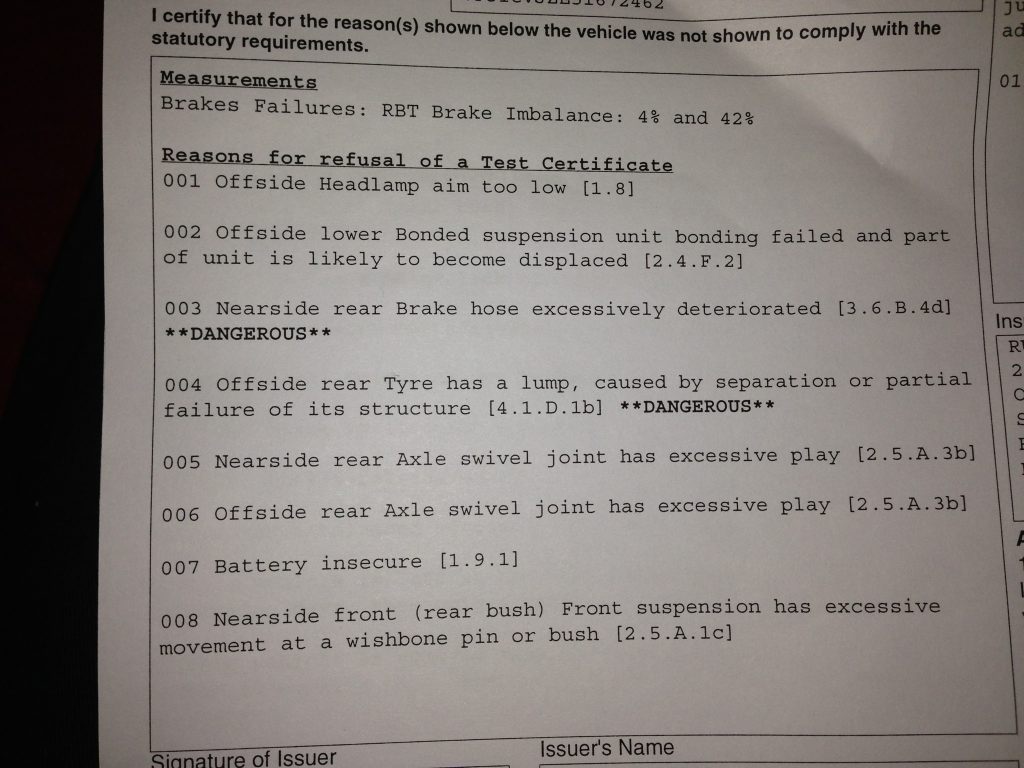

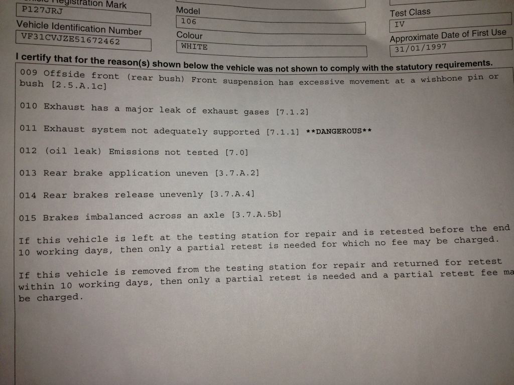

Put the 106 in for an mot today and got a nice list of 15 fails lol hoping you guys could shine some light on the less obvious ones
seems like it needs a new rear beam.
a tyre.
front wishbone
Brakes
Exhaust
Quite an impressive list lol
Most of the problems would be fixed with a brake overhaul and exhaust system fixes. Not as extensive as it appears Smile
005 006 rear beam!
Got a beam here for £60 Smile GTi one too Wink
I wonder if the rear axle swivel joints is meant to be the radius bearings? Anyway means the axle is no good

Whats a lower bonded suspension unit (no. 2)?
The rest are fairly obvious as above, replaced beam and brakes should sort most!
Yeah, not seen that before, what do they mean? All i can think of is the wishbone, but they mention that by name elsewhere, so assuming it's not that...
lower suspension bonded unit is the front wishbone rear bush.
It looks like its bonded into the car.
Looks like it needs a new owner Wink
Lol it was a cheap car so expected some work will ask about the bonded suspension part tomorrow and the beam issues

fairly simple tho. 3,5,6,13,14,15 all solved with a new beam
New wish bones &seal/hang the exhaust. Simples how do you need advice on that
I thought that.
new beam
new front wishbones.
secure and repair exhaust.
done

Lol I've done a few minor bits but its been sat for a while
i just wanted to know wtf the bonded unit was mainly Smile
All that write up for a rear beam? Jesus
The rear beam is a suspension assembly, not a single unit. If they wrote "rear beams f*cked" when they just meant it needed one new bush, i think you'd be pissed that you'd had to pay out for a whole beam, no? Wink
Haha. Good point. Ill go be quiet over here >>>
Looks like the list for my rallye after its first mot attempt lol
look under the 106...the rear wishbone bush (on the front) looks like its bonded into the car.. I guess thats what they mean
It is bonded, to the shell and the pin. Some bushes are not or are semi bonded, depending on the way they work.
Gotta love peugeot and there French ways. Yay 35th post. Gunna PM everyone now
they not bolted through the floor?!
(29-10-2013, 02:54 PM)Piggy Wrote: they not bolted through the floor?!
Think they are through the footwells
The bush is bonded to the casing, the casing is pressed into the mounting, the mounting is bolted to the car.
It's the bush that has fail, hence 'bonded bush'....
