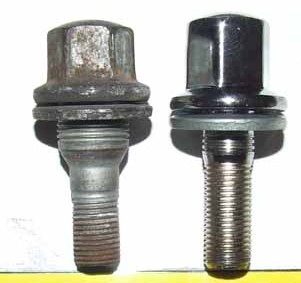

clones need the flat seated bolts the early type bolt will fit both cone 1 and 2 wheels.
left bolt is the newer bolt right bolt is the older bolt

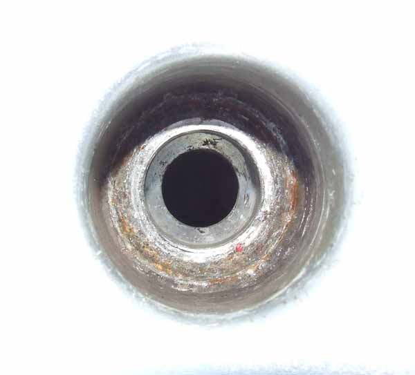

Older clone 1 pictures
Notice the no counter bore on bolt hole
Notice UK FRANCE cast marks
Notice shallower center bore

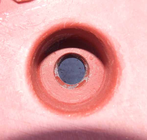

Newer clone 2 pictures
Notice the counter bore on bolt hole
Notice ITALY cast marks

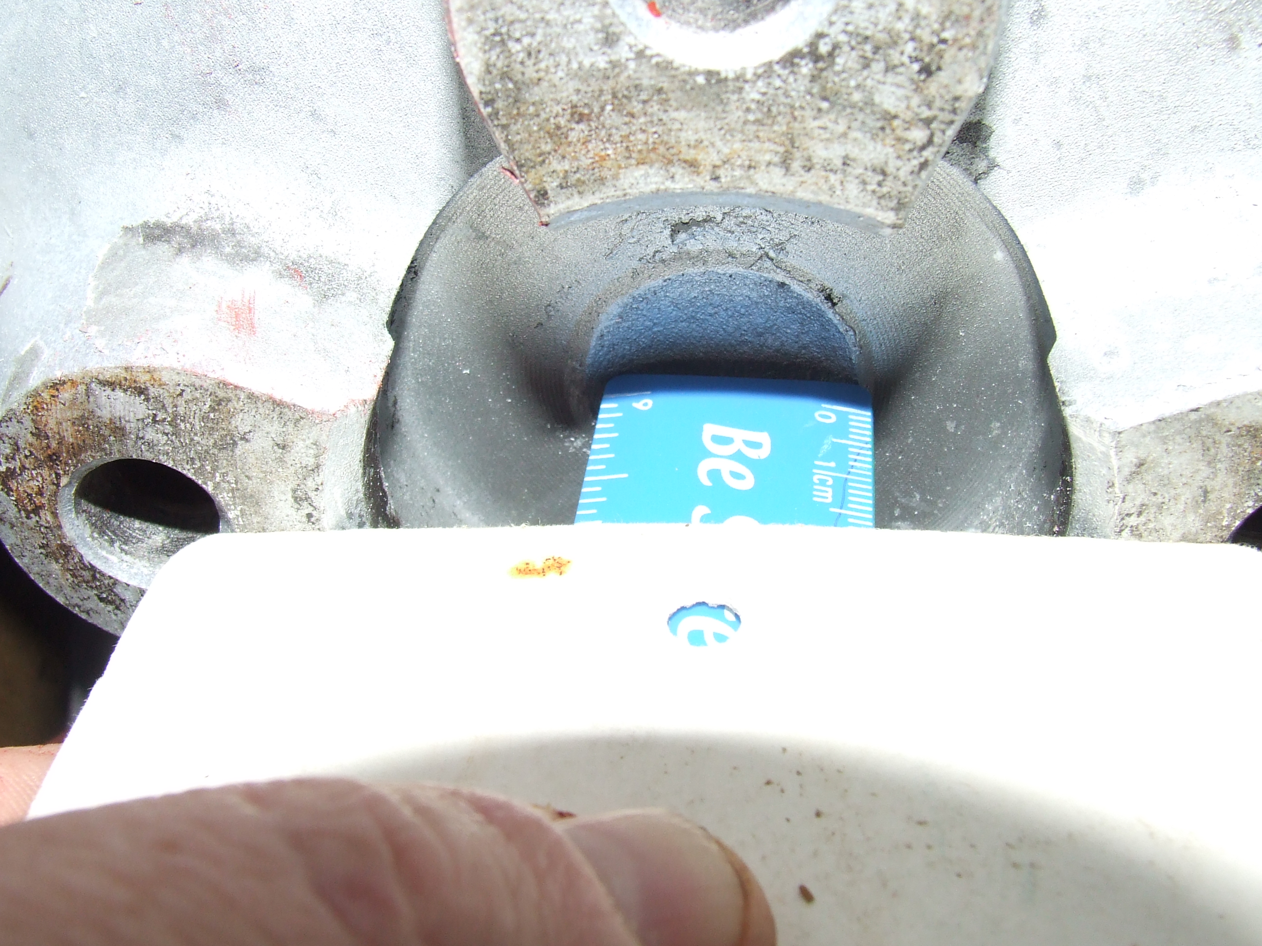

Notice deeper center bore

Pic 1: taper on top of bolt hole

Pic:2 taper in bolt hole and wider at the top [Image: hy6yry3e.jpg]
