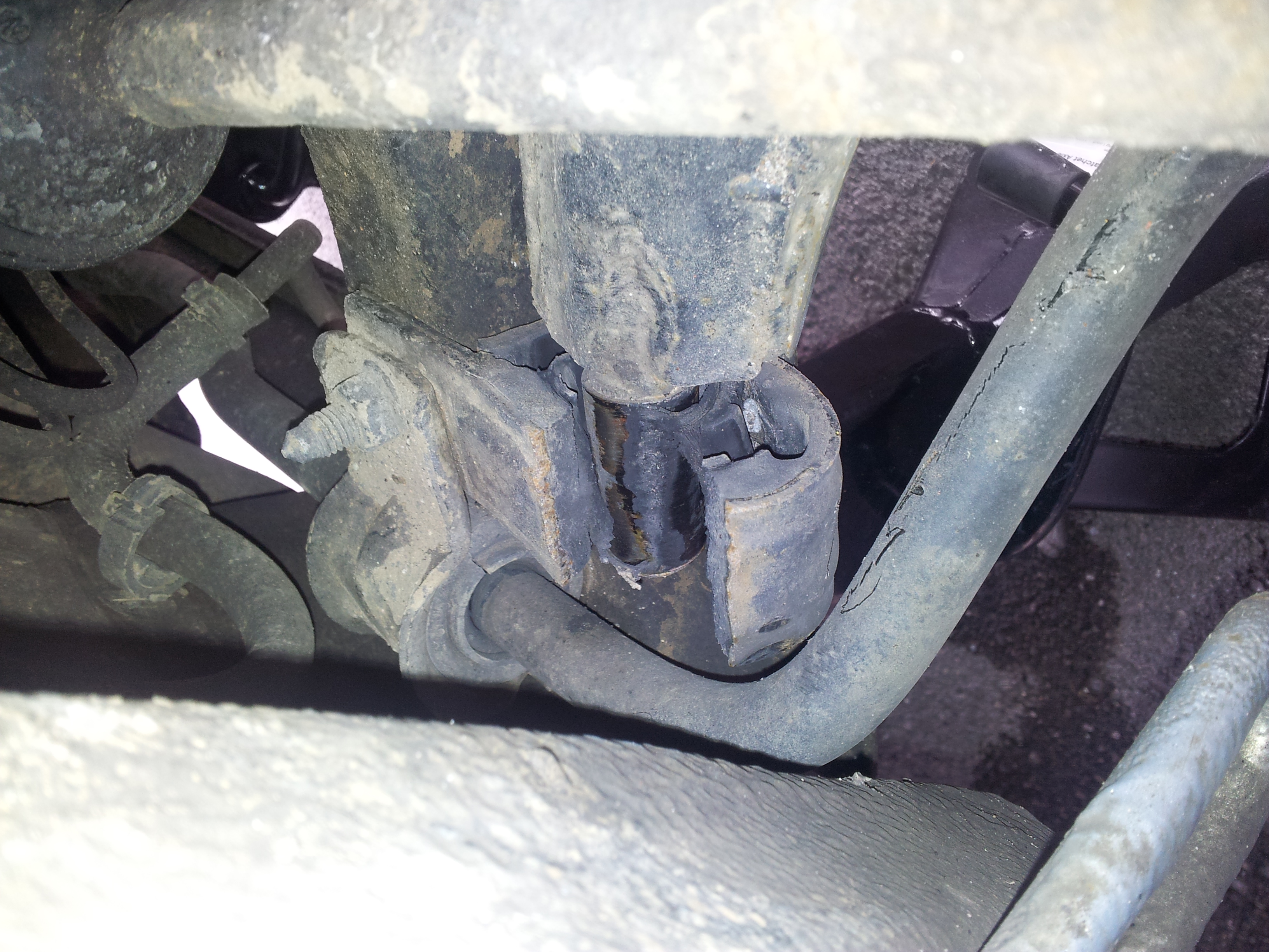

Think my P bushes are worn
Recently bought a new vehicle and the seller said there is a slight suspension knock...

Well that will be the knocking!
There due for new bushes I think.

uprate to what? its only my work bus lemford are decent arnt they?
Team Doesn't own a 306
i put on power flex bushes on n never had any trouble since were before i was changing them every couple of months
(01-05-2013, 05:22 PM)Danny2009 Wrote: uprate to what? its only my work bus lemford are decent arnt they?
I work for ECP and lemforder are just as good as powerflex only cheaper and you have a 2 year guarentee with them

apologies mate but I've had better luck with power flex compared to standard parts
Ill post a pic of mine up when my phone has charge in it
(01-05-2013, 06:15 PM)chippyba Wrote: apologies mate but I've had better luck with power flex compared to standard parts
How? OEM ones last a good ten years +, how long have you had your powerflex ones?
18 months no problems

partner/berlingo i see.... try and get the "later" design p bush
http://www.ebay.co.uk/itm/Citroen-Berlin...416ca6b03b
www.prestige-auto-care.co.uk
Yep, better option than the cheap shit 306 replacements most places have these days.
Cheers pal ill get 2 of them orded Smile

Suspension bushes in the shape of a P, go on the rear of the wishbone.

Lol thats nuts. Worst I've seen for a while.
I wouldn't bother with power flex, go standard, mele or roller bearing IMO.
It's my work bus so ill be getting half decent ones no power flex of myle ect just something it won't eat through in 100 miles!
