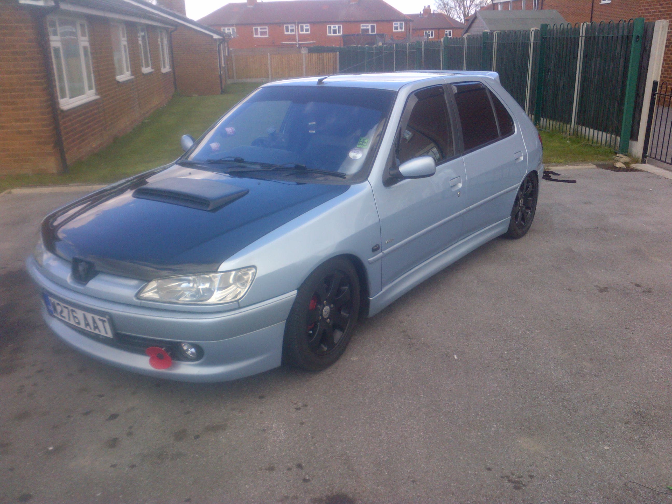

then here it is a few months after the fcs when the seller was selling it (didnt really like it at this point so i was looking for another derv) Smile

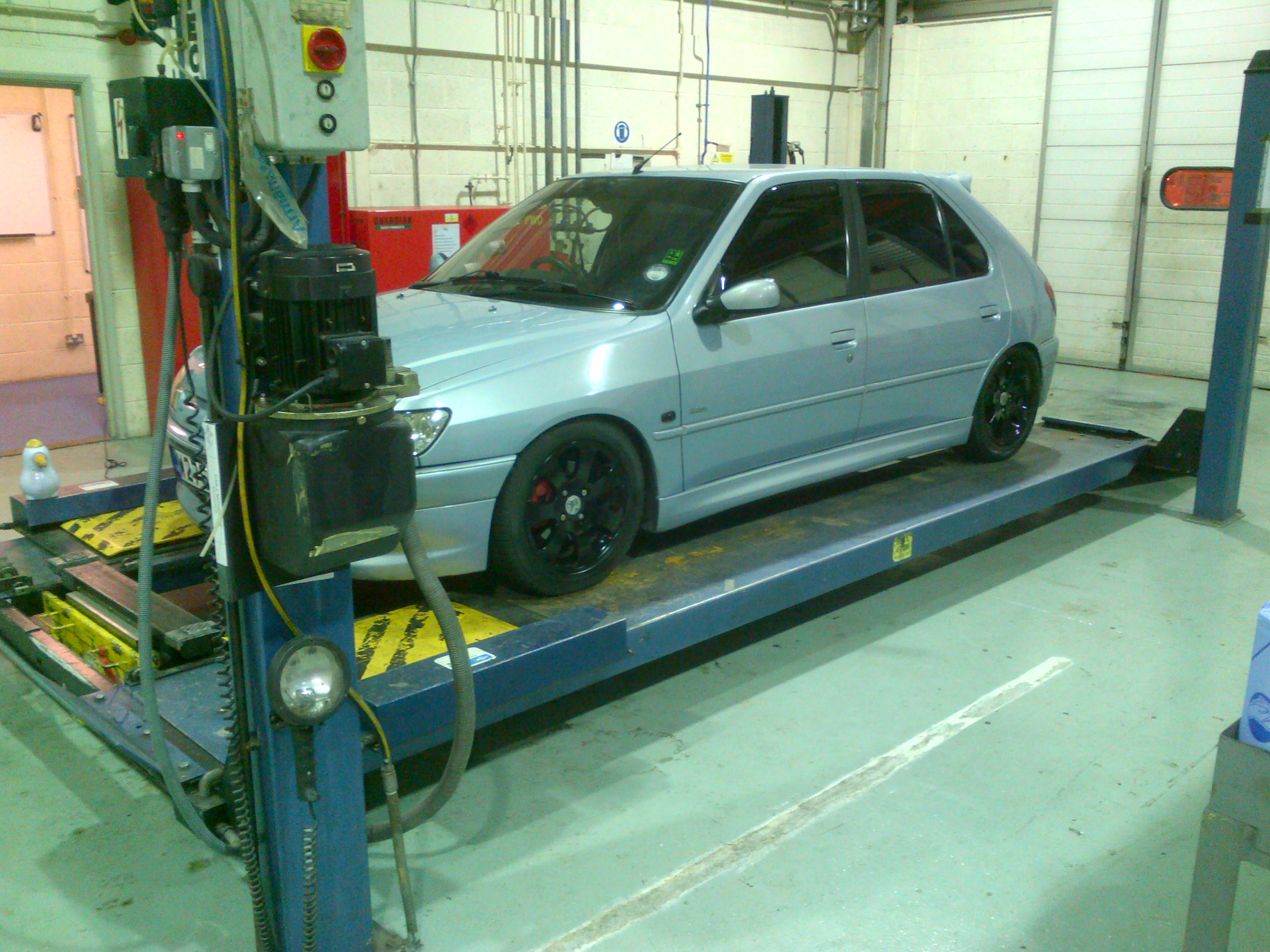

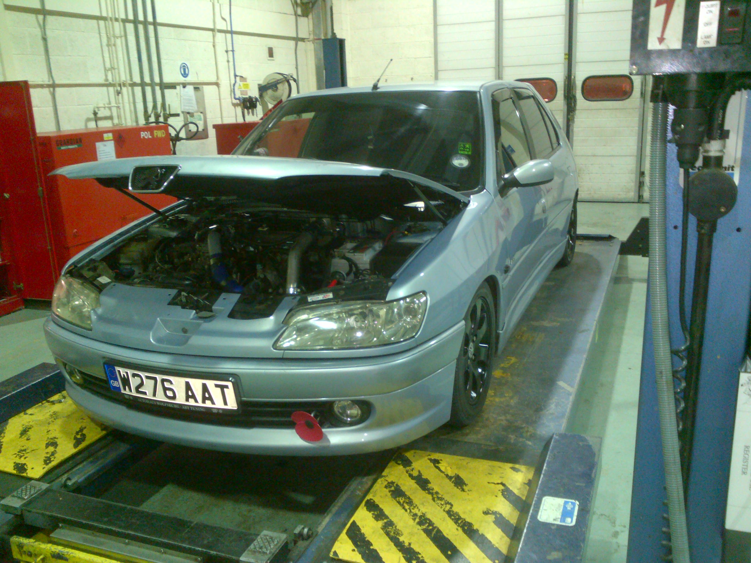

then about for weeks later it had come down in price so i thought just with the stuff i knew he had done the engine it was worth while so i picked her up like this...
since buying it i havent really done much too it apart from this small list:
- Good Clean
- new pump bracket
- new timing belt and water pump got done when the bracket got changed
- new glow plugs
- new alternator and belt
- all filters done
- gets an oil change every 2/3 weeks
- Bosch Battery
- Double din head unit fitted
- new pads and discs
- 307 alloys
Things that need doing are as followed:
- new heater/fan switch (this should be sorted wednesday)
- rear bumper has mine has a crack (does any one have one? )
- new bonnet mine has minor dents in Sad
- xantia manifold
- Fuel cut off solonoid (this will be done wednesday)
- Front Splitter
- Angel Headlights (orderedon there way)

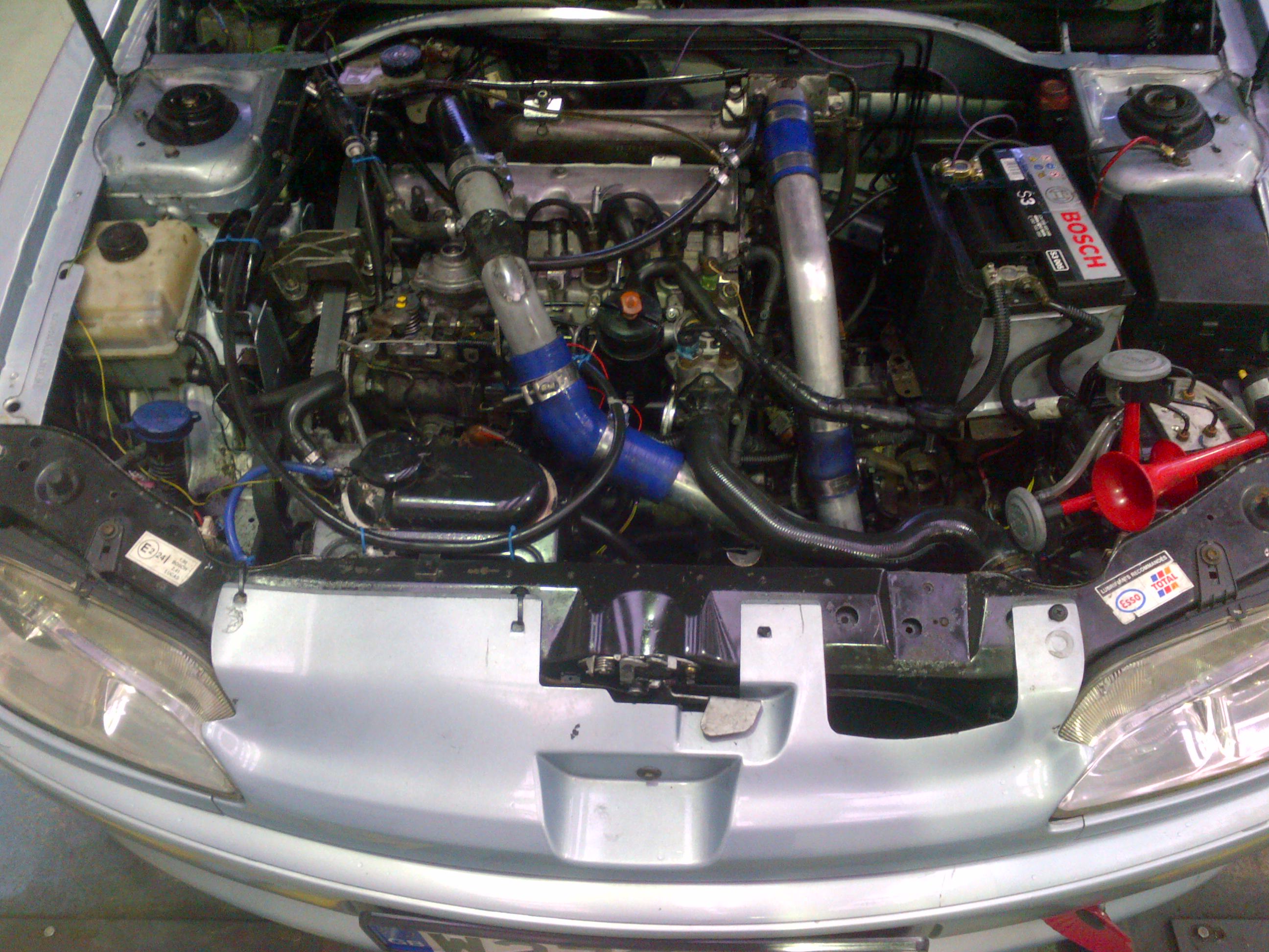

the engine:
- xud of course
- td04
- fmic
- bosch pump
- grinded lda pin
- gov mod
- 11mm ford transit head
- Straight Through stainless exhaust
- Hdi rear axle
- lowered all round not sure on height think 60 on front back obviously torsion bar not sure how much Smile
Boosting at a comfortable 28psi atm untill the new clutch comes mine isnt slipp just cba if it starts Smile

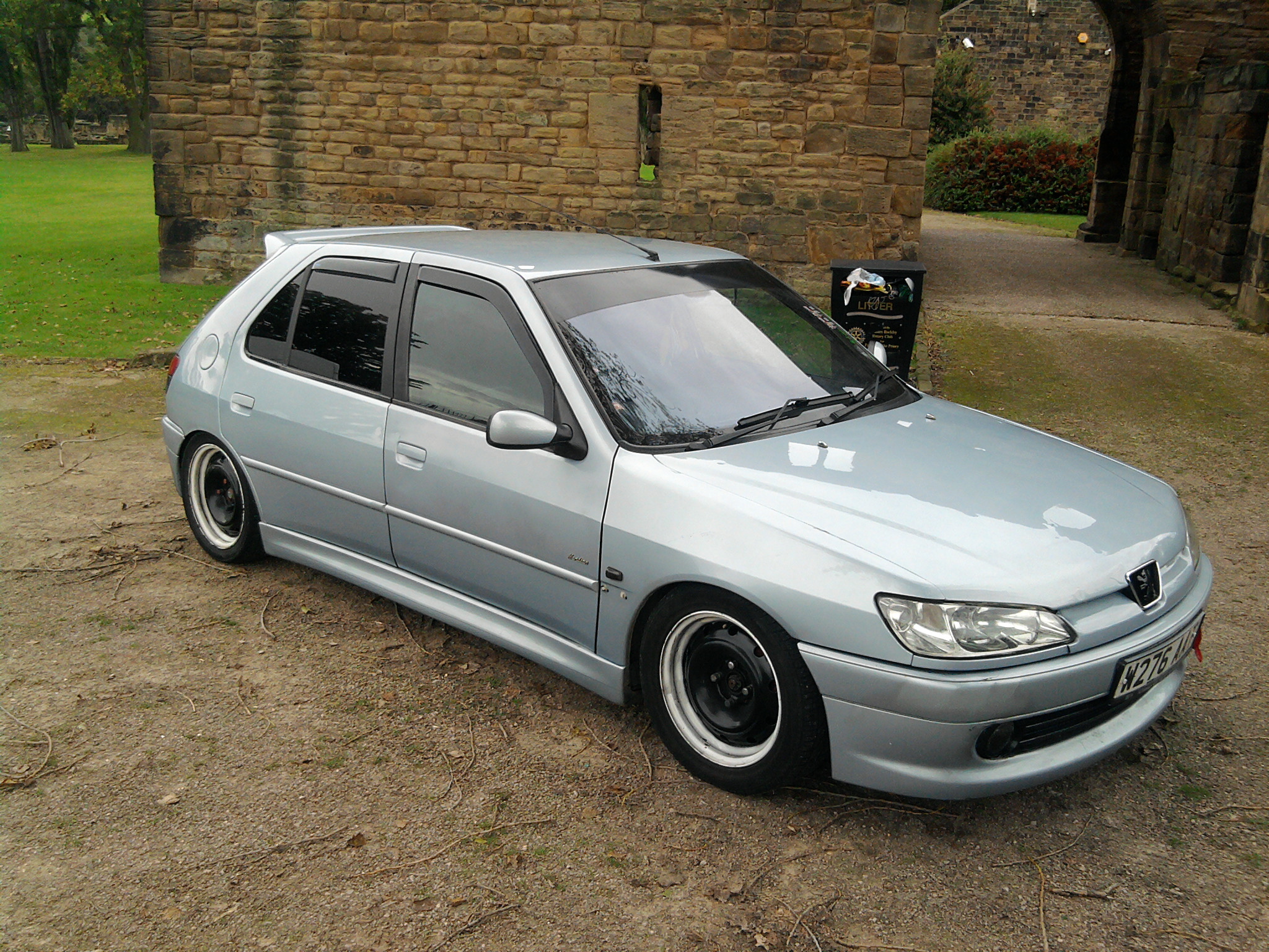

few pics of her now Smile
there probably a few things ive missed :/

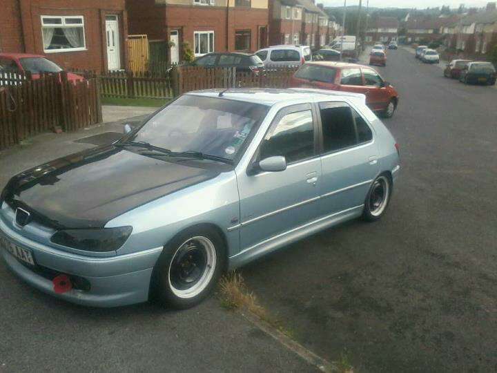

quick update car has a small hole in the fuel tank some how :/ but got a new tank getting fitted next week has it is only a tiny hole that only leaks after its about a quater full also got some new speakers the only reason being is passenger side broke so bought some of these http://www.halfords.com/webapp/wcs/store...yId_265870
and they were a direct fit so was a easy enough job Smile
new bonnet
(06-04-2013, 02:34 PM)AndyG Wrote: new bonnet

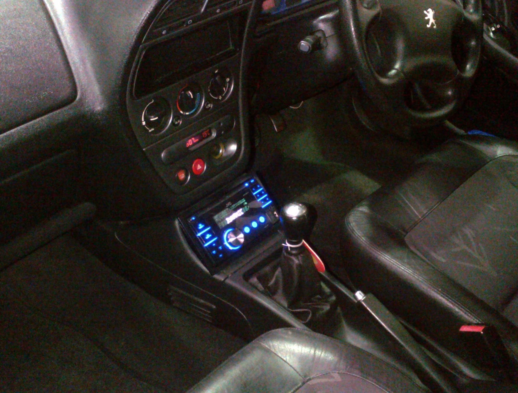

so been on a course all week come back to a sticking injector how i love have this car i don't know! any way got a pic of it with the new head on and double din head unit in Smile and guess what ill be doing tomorrow Big Grin
That looks owite. Bit distracting to look down there when changing tracks tho!!!
