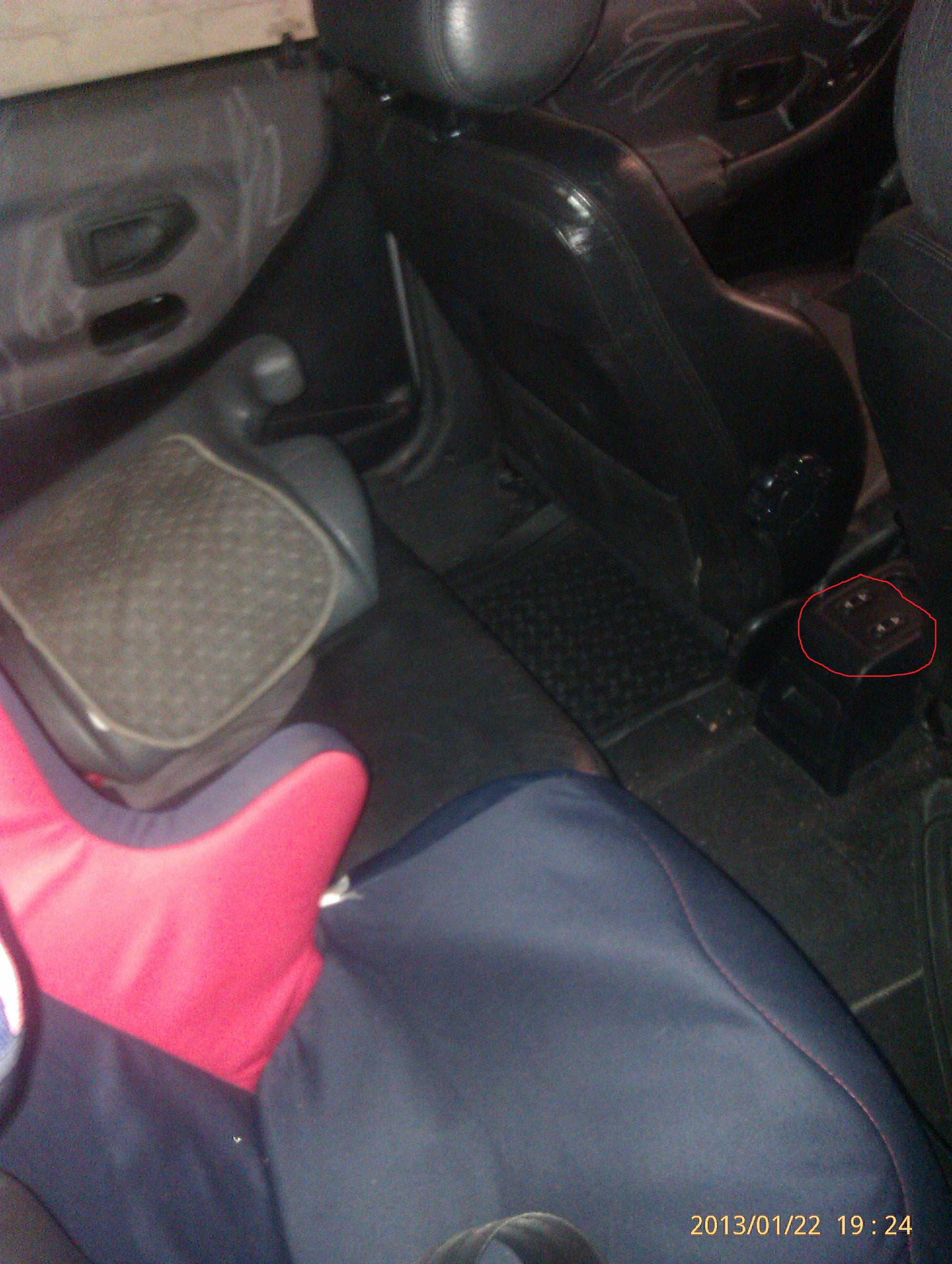

as for the switches, check under the rear of the centre console, Rear ashtray area the plugs shouid be there,
but idoubt the connectors will be there in the doors for the elec motor,
You will need the dash relay, Leccy window switches for rear console and mechanisms in the door all the wiring is already three as I've do this with my hdi :-)
Ill have a look in a bit how many wires are there leading into the door if the wiring for the motors is there ?
The electric window wiring will plug into the central locking loom already in the door you'll see it when you open the door, luckily the door I had were the same colour so all I did was add the relay add the switched and plug it in but it should be the same
Door card and mechanism
Mechanism plugs into loom already there for the central locking
