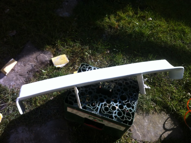

Cheers hovis , disc rotors now arrived , also done mould of rear maxi spoiler and laid up carbon fibre one for. Car , will add picture this week

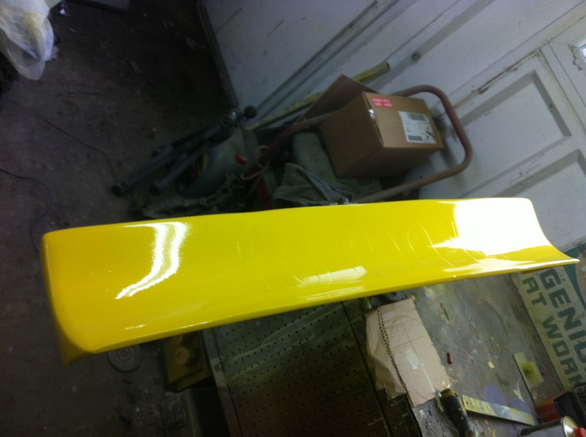

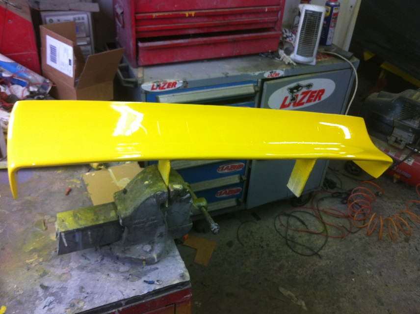

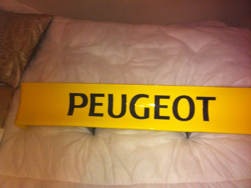

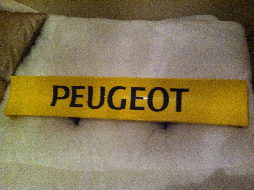

as promised , carbon fibre rear maxi spoiler ,now all painted after peugeot graphics were applied ,and now removed so can clear laquer so lettering will be pure carbon , hopefully get fitted this week

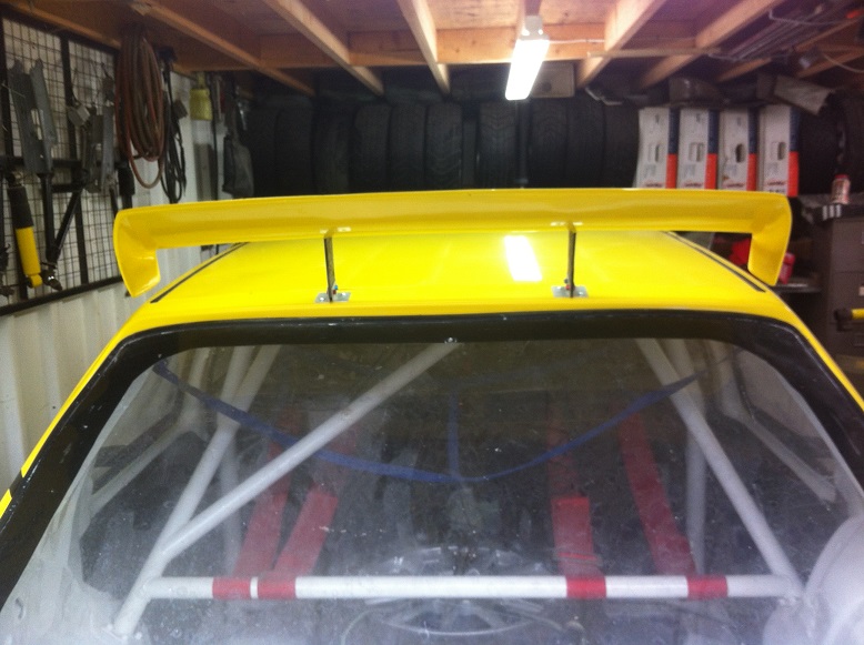

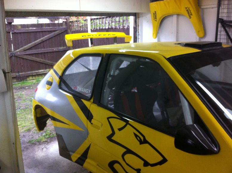

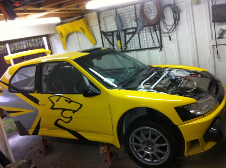

cheers chris , quick update as havent had time in a while , rear maxi spoiler now all fitted as shown in photos , front brakes all now fitted properly , and have had to take out seat , harness , extinguisher as all have to be in date for stage rallying , so will fit last thing as only get 5 yrs out of seats and harness , and 2yrs out of extinguisher before servicing , also having to fit steel doors as not allowed carbon /kevlar ones in rallying , will add more photos of progress shortly

Even with double door bars there banned , lightened steel doors as much as can but still nowhere near as light as the carbon doors , will more than likely be keeping the doors as all painted and graphics applied  for if I do sprints or track days , have moulds to   make others though

Sold seats and removed harness and extinguisher as all have to be in date for stage rallying , also removed carbon doors as have to be steel , have lightened steel doors and started fitting , just need painting and new graphics fitting ., rear axle parts all done now so just need picking up so can refit , will add picture shortly

    Finally back on car , as have been mad busy with work , fitted and painted drivers door , just need to apply graphics , and trial fitted rear beam to make sure width is right

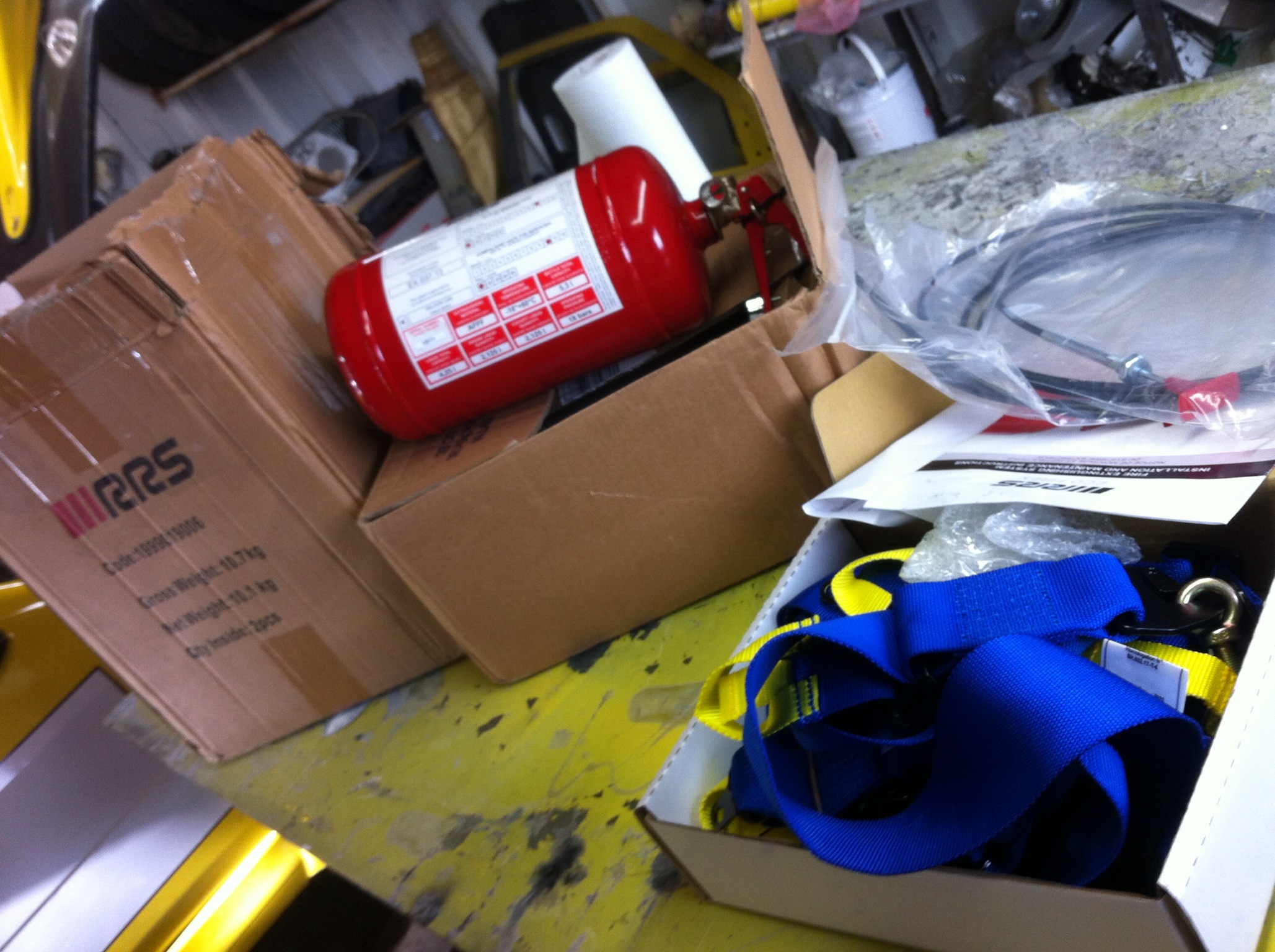

]     Been a while since I've posted , still doing bits on car here and there , been collecting bits for it , fitted electric power steering pump , and bought new in date fia extinguishers and harness and seats should be here this week

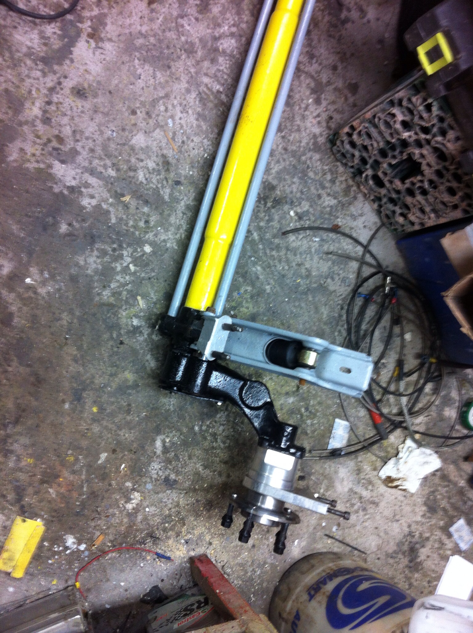

Been ages since last post , have been doing bits on car when can , it's got wheels on all 4 corners now as have rebuilt rear beam , spec of beam is  21mm torsion bars , 25mm Arb , custom radial mount caliper brackets , custom widened bearing housings which have larger bearing , custom drive flanges , 300mm rotors with bells and AP racing 2 pot  calipers , having trouble uploading pictures to site for some reason[attachment=32020
