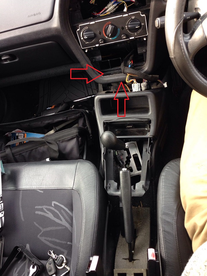

Ok, this has been bothering me for ages.. Intermittent speedo sensor. Losing speedo clock for 1-2mins during engine/gearbox warm up. Old vs. New.
All appears good now. Should have done this a long time ago, for something so simple.

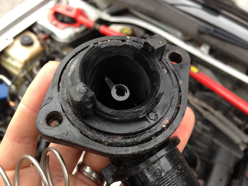

Yeah.. So, you know I changed the radiator over last year? Went for a short drive on Sunday and somewhere along the trip my bottom radiator hose came loose - Dumped all the coolant  (while driving I imagine).
Queue emergency stop at the roadside as I suddenly noticed my temperature gauge was off the chart and the red STOP warning was starting the light up. Fortunately I had someone nearby who was able to fetch my tools and bring them out to me - Basically the god-awful design of the cir-clip style bottom hose came loose and the pressure pushed the fitting out. Awful, crap design. Really wish I could use a jubilee clip. Car is filled back up with a mix of water/coolant temporarily until I know its solid but I don't -think- I've cooked anything. Seems alright.

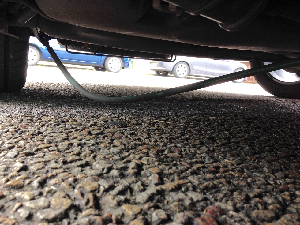

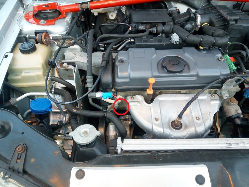

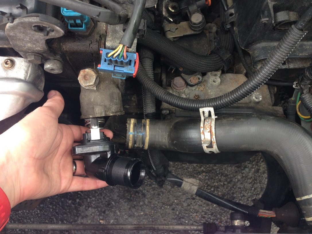

Oh wow, I've been taking it easy all week however today I needed to flush out the mostly water mix I put in the system at the roadside. Anyway, I think I've secured the bottom radiator hose again with the awful cir-clip thing. I really hope someone out there finds these pictures useful as I had a hard time finding anything remotely to do with the newer style (and bad) radiator design:
So.. Ready to put in new coolant, undo the bleed point on the engine block, took a little look through the hole - Uh Oh, more trouble:
Thermostat nuked itself inside the housing.  Rofl
However the inside seems to be superbly clean by the look of it!
I'll have to go out tomorrow to get a new thermostat, obviously so unfortunately the car will need to stay put. I also got some new spark plugs too - I'm using Iridium ones at the moment but I'm going to stick some regular NGK ones in just to see how it runs in comparison.
#41

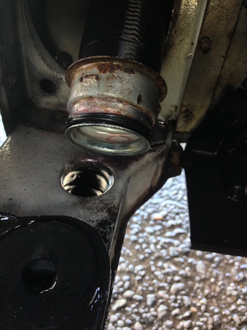

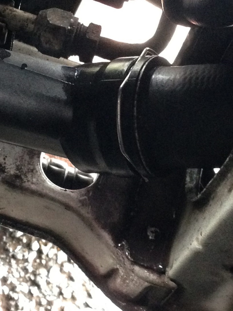

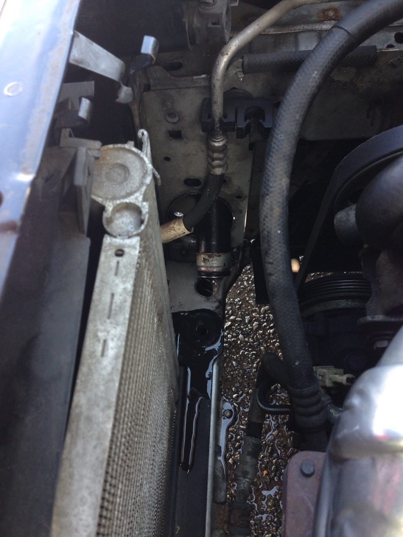

Right.. Down to ECP for a new Thermostat, let's have another go!

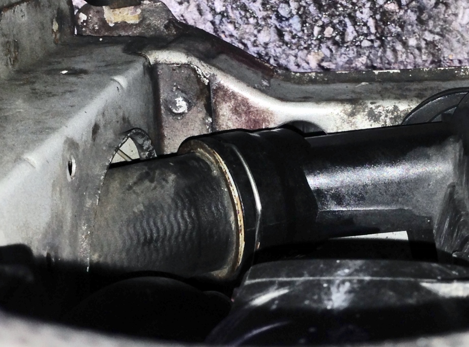

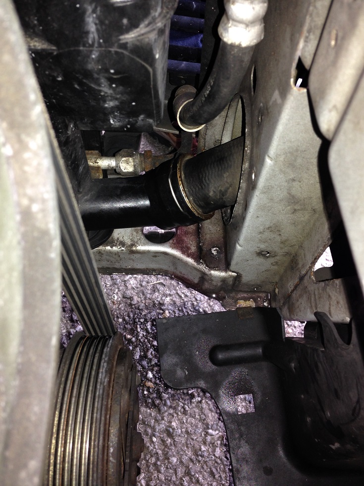

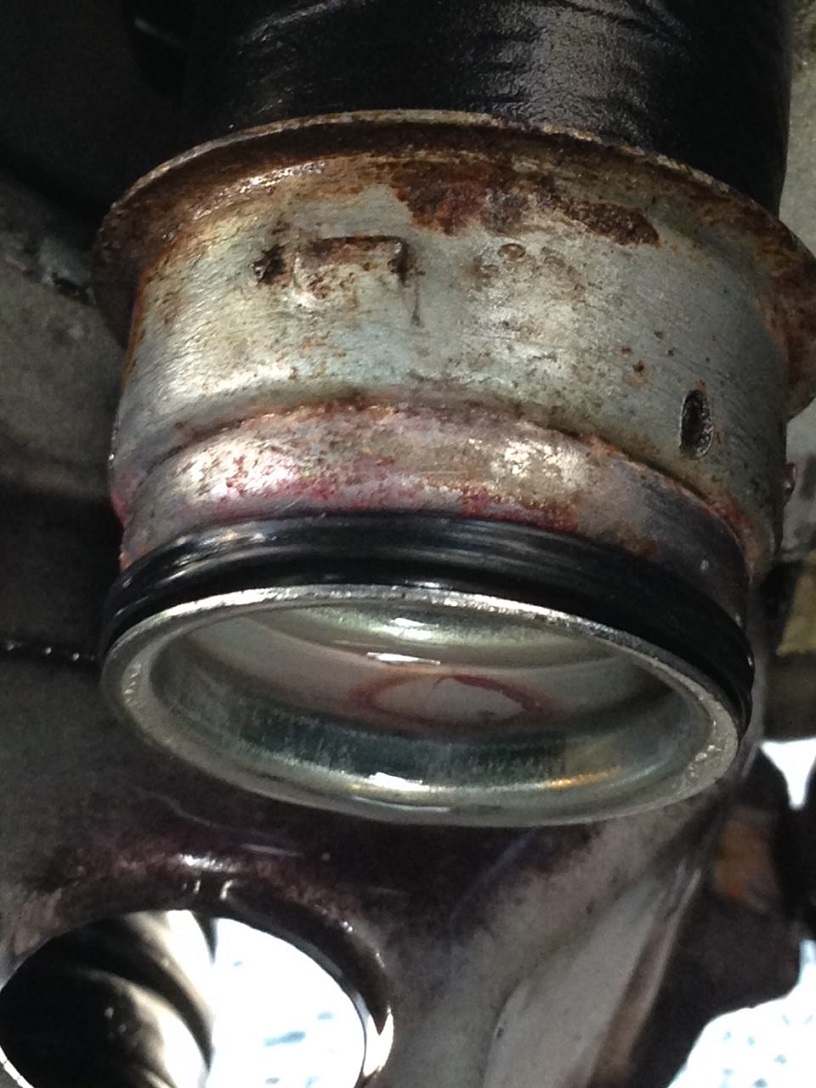

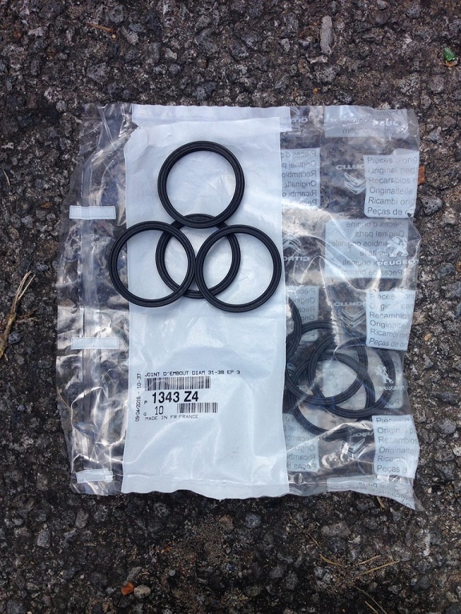

Basically, after thinking about it I didn't want to put new coolant in should the rubber O-ring on the bottom radiator hose be shot. Decided to do it properly a change the O-ring while the coolant was drained. Engine bat with radiator removed and lower hose visible on the far bottom left of the bay:
And some close up shots for you lucky folks who have one of these and aren't able to gain proper access..
You can clearly see the O-ring and notches on the nozzle where the metal cir-clip (coming later) sits to hold the hose in place.
The rubber O-rings can be purchased as a genuine item, unfortunately as a pack of ten, not expensive but just inconvenient. If you need one just drop me a private message.
The cir-clip that goes on the radiator to secure the hose in place.  Nospeak (This should come with your newly purchased radiator)
Nozzle cleaned with wire brush, new O-ring on, replace your radiator same as removing and then secure with cir-clip.
Self explanatory - New thermostat.
Final task of checking all your points of possible leaks before filling up and bleeding (Just shout if you need info on bleeding but I'm sure most know what they are doing!). I use a no-spill funnel which also acts as the header/expansion tank and helps with bleeding. It comes with a plunger to plug the hole when your'e finished so minimal spillage when your funnel still has fluid in it like below:

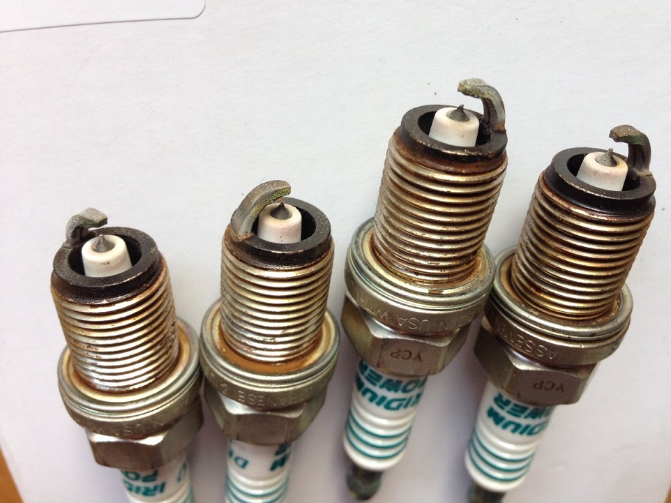

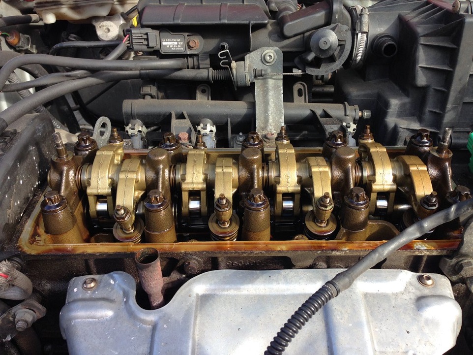

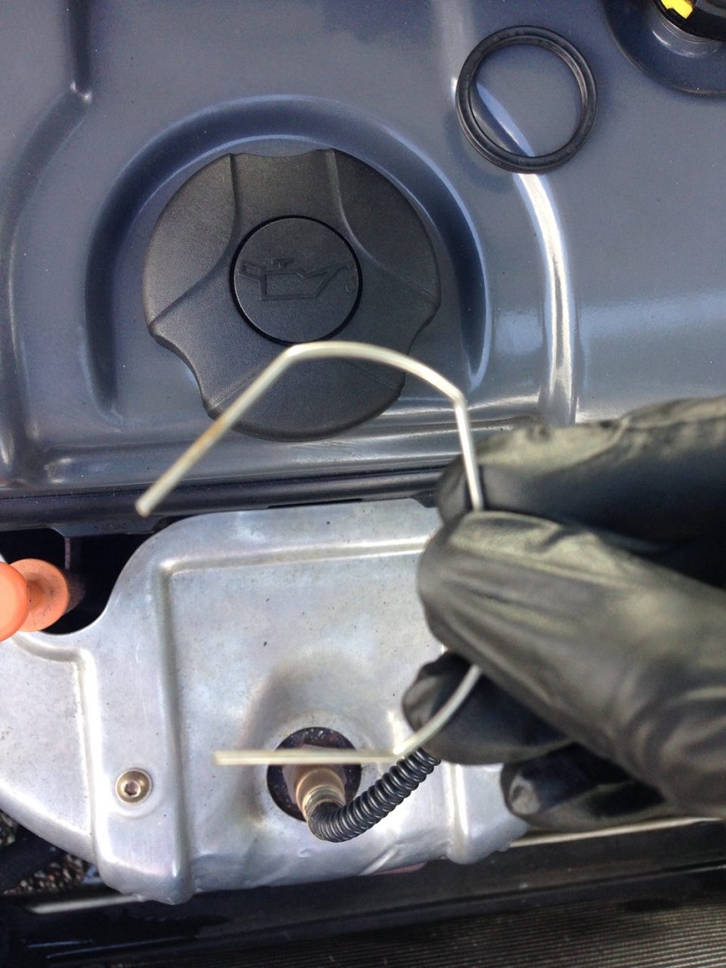

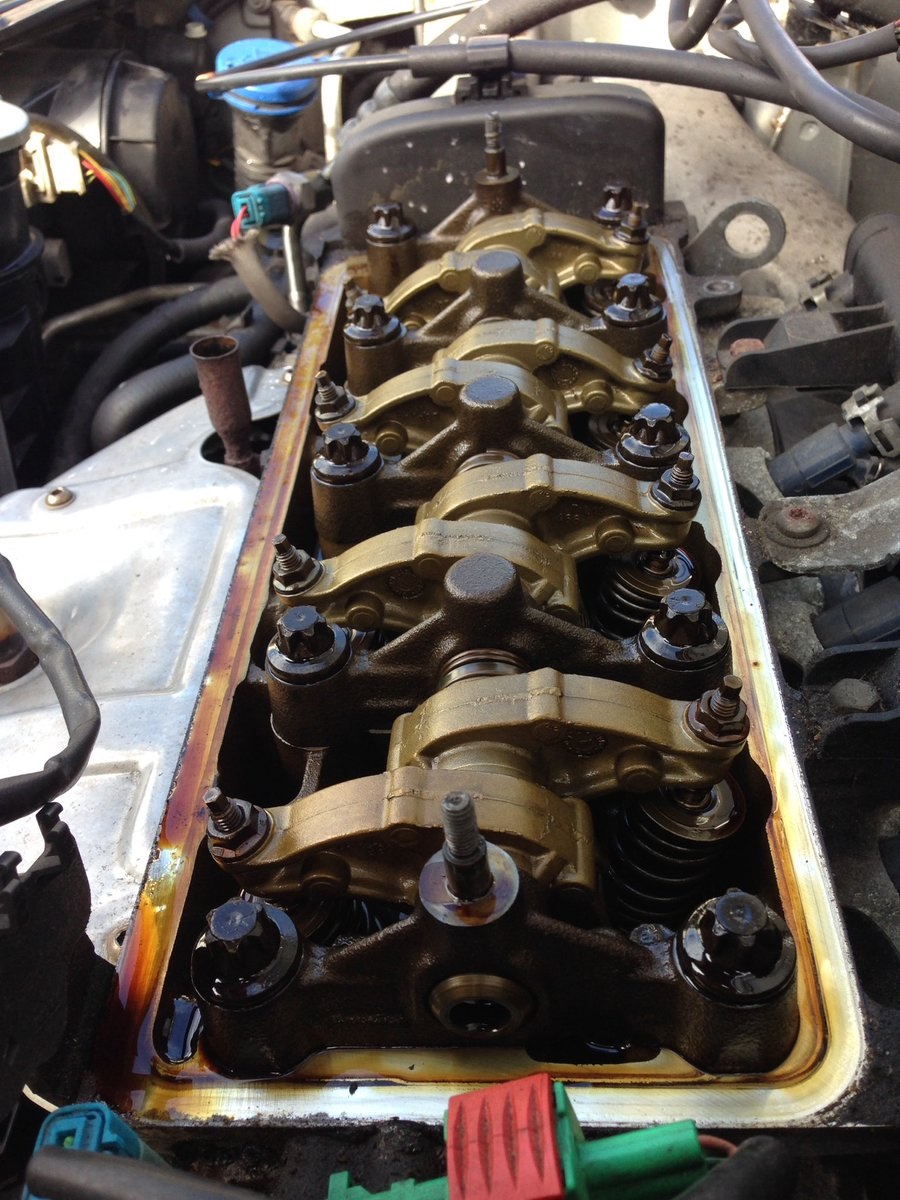

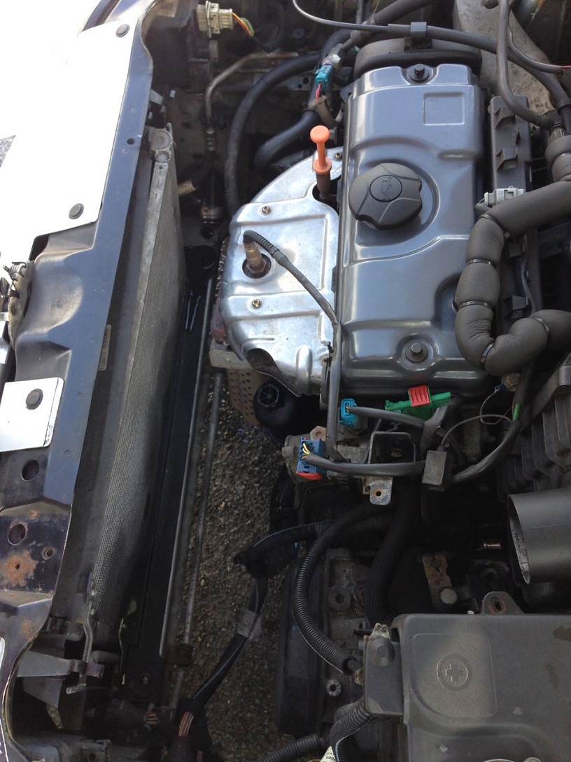

I've been having a noticeable tapping from the top end - I had a few small things on my list of things to do: Check the lifters, tappets etc for anything visual / obvious. Change the spark plugs, get an inspection scope down in the the cylinders for well.. why not, sh*ts and giggles so to speak.
More images that i hope will be useful for anyone else with a TU5JP engine.
Rocker cover off, coil pack and breather hose also removed:
The Denso IK20 Iridium plugs after about.. 20k miles. Technically they should last far longer but I was getting noises I didn't like so as a process of elimination I've stuck in standard copper NGK plugs. The clacking / tapping while cold seems to have been significantly reduced after going back to fresh coppers.
Also.. Here's something you don't see every day!
Starting from cylinder nearest to cambelt, going across:
1.

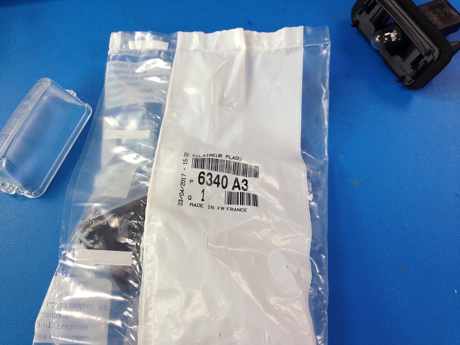

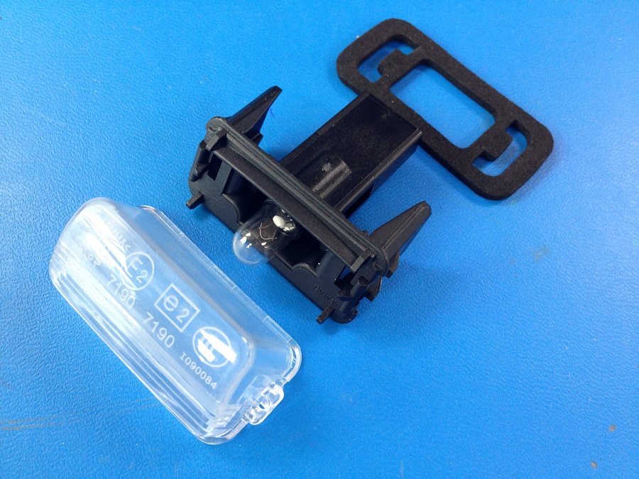

Couple of blown bulbs on the rear - One reverse light and also a number plate bulb. To be frank, I was a bit impatient in trying to work out how the number plate bulb housing came off, resulting in me snapping it straight off. Good ol' fifteen year old brittle plastic.
Found some replacements on flea-bay for £7 a pair, with bulbs included! Quite a steal I think. Part number 6340A3 and is supposedly compatible with both hatchback and estates. Nice fresh, unmarred plastic. You'll have to remove the plastic liner on your tailgate to access the wiring/clips but a very simple drop in replacement.

Top end of engine looks very clean Nex. In my limited experience (Mini's), I always found manually adjusted tappets quite rattly.
The bores seem to still have the cross-hatching on them!

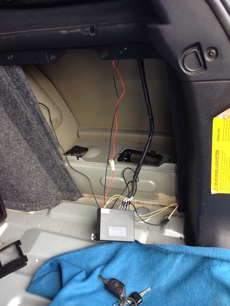

I was also recently trying to locate the Central Locking Module, I know on previous phases it's underneath the rear seat but not on this Phase 3! I tracked down the relay to somewhere behind the dash and eventually located it in the centre controls area, right at the very bottom - However it's hidden underneath a plastic panel and I cant seem to get my hands in there. I didn't have a huge amount of time so was not successful in getting in out on this occasion. I'll try again sometime when I can remove the dash properly.
For anyone who needs to know, the reversing sensor module is located near the tailgate, behind the plastic panel where your scissor jack and tyre iron is.
I originally had all the boot carpets up to see what the panels are like underneath (I'd like to sound proof a bit more) but ended up doing extra stuff like checking the arches/pillars for rust.

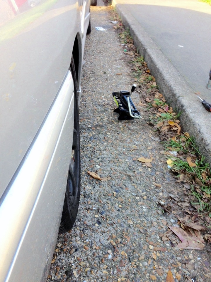

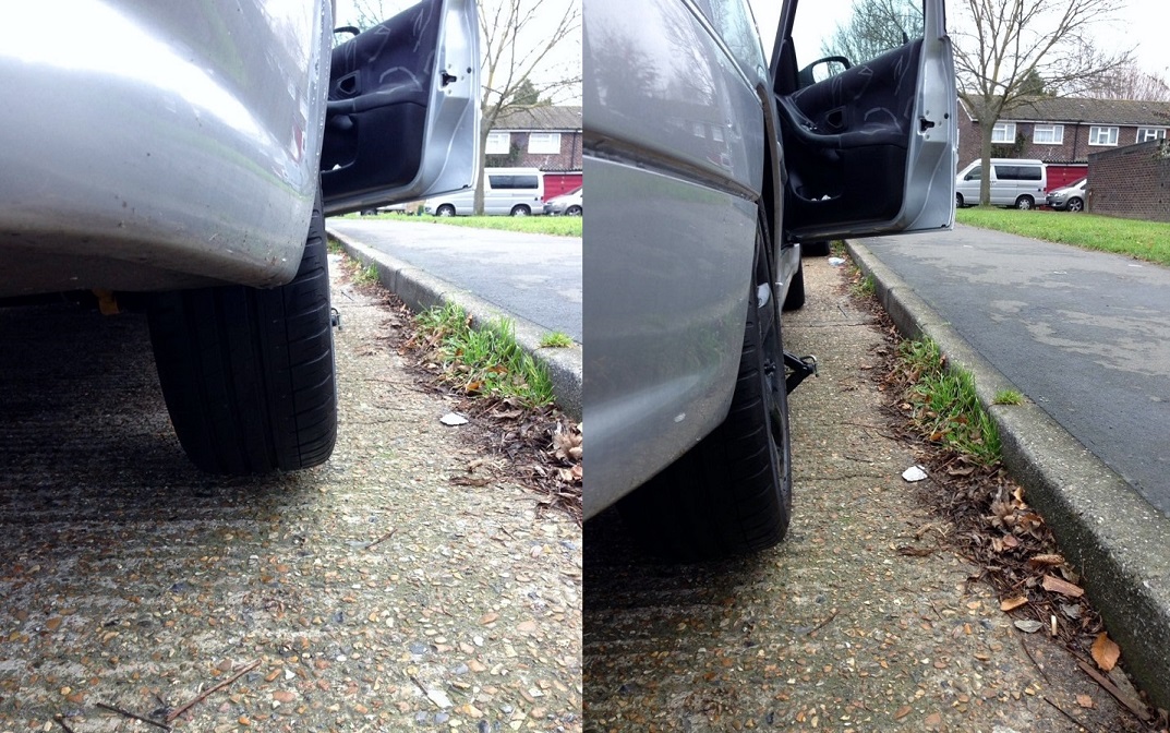

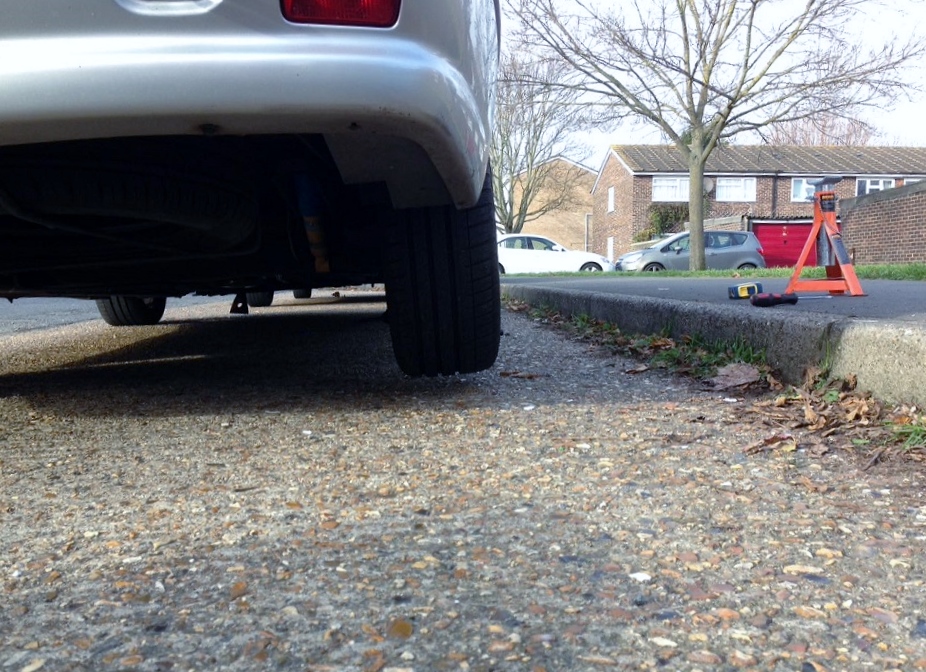

Just started getting a real loud creaking from the rear axle over the last couple of days when going over speed bumps, as little as >10-5mph - I do seem to have a bit of camber going on as well. Would anyone know whether this would be an issue with the rear beam needing replacement?  Doh  This is a 105k mileage car afterall.
Now I've had the car lowered since February 17, and I know I've had a wee bit of camber - If my wheels were dead straight, they'd be rubbing on the rear arches. Could the creaking be a result of the Bilstein shock bushes being harder in the cold weather?
#49
Looks like camber from dead bearings I'm afraid. Are the tyres scrubbed on their inner edges too?
#50
(02-12-2017, 08:12 PM)Mighty306 Wrote: Looks like camber from dead bearings I'm afraid. Are the tyres scrubbed on their inner edges too?
Thanks for the reply, luckily I have a week off at the moment so I'll get it inspected properly.
#51
Couple of better shots taken today, just wanted to double check before calling the garage and getting in. It handles fine but something definitely isn't right. I'll be taking it in during this week. I'm going under the impression that the bearings are shot but to be honest, if it needs a new axle, so be it. May as well go whole hog.
#52
Very tidy car, a credit to your work.
If you ever fit the most retarded lower radiator hose in the world again, a thin smear of Vaseline or lithium Grease on  the outside of the o ring will let it slip home nicely. The issue is that the o ring rolls over as you fit it so it is trying to push out. I had this happen on my rallye and it cooked the head after dumping my coolant. An expensive lesson.
The beam looks to be on its way out. I wouldn't just take it to Joe bloggs garage as they won't know Wtf to do. Get in touch with Jord or Stef who can do you an exchange axle and probably fit it for a fee. Will outlast the car then.

(04-12-2017, 08:14 PM)C2K Wrote: The beam looks to be on its way out. I wouldn't just take it to Joe bloggs garage as they won't know Wtf to do. Get in touch with Jord or Stef who can do you an exchange axle and probably fit it for a fee. Will outlast the car then.
I've had previous work such as the braided brakes and suspension fitting done by Pug1Off in Brackley. In my own personal experience I've had good dealings with them. Will be handing the car over tomorrow for them to inspect the condition of the current axle, whether it's worth changing just the bearings, or changing the whole thing outright. With 100k Miles on it, I'd rather just do a straight swap and get the whole thing replaced - Will await their diagnosis!

(15-12-2017, 08:25 PM)C2K Wrote: How did you get on?
Took a while before they were able to get it on a ramp for the work - Picked it up on Saturday and yeah.. All done.
Front axle bushings were changed as well, road comfort is much nicer now where potholes felt more like giant craters. I was hoping to ask for them to take a few pics for me but didn't get the chance. But on the other hand after spending a fair amount on having the refurbishment done, I had some nutter do a U-turn right in front of me less than a mile from home. Don't worry, no contact made.  TMI
