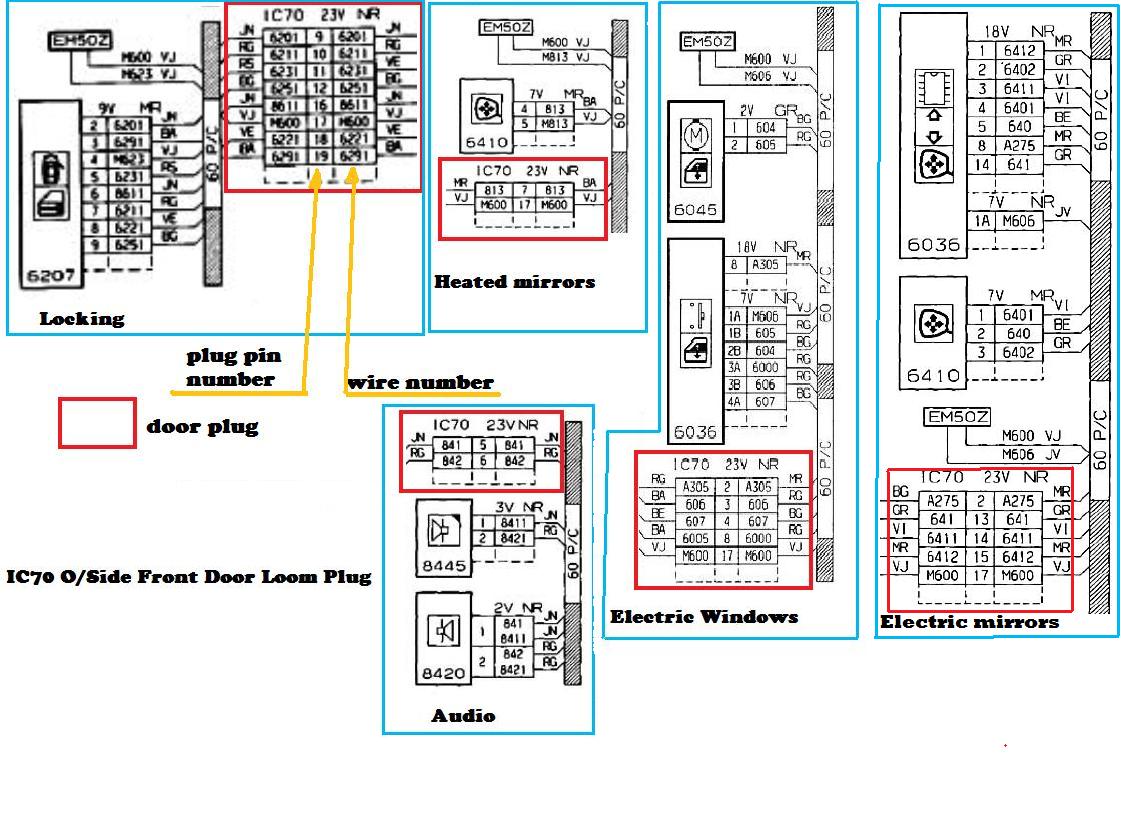

I've checked the continuity between the door plug and all the wires that are inside the driver's door skin that are going towards the door lock mechanism to identify that they are definitely pins 9, 10, 11, 12, 16, 17, 18 & 19 as per the table in the pic

that drawing is for a ph3 car with the locking box in the centre dash console under the clock temp display
ph2 locking box is under the rear bench seat and the wiring is very different to the ph3
