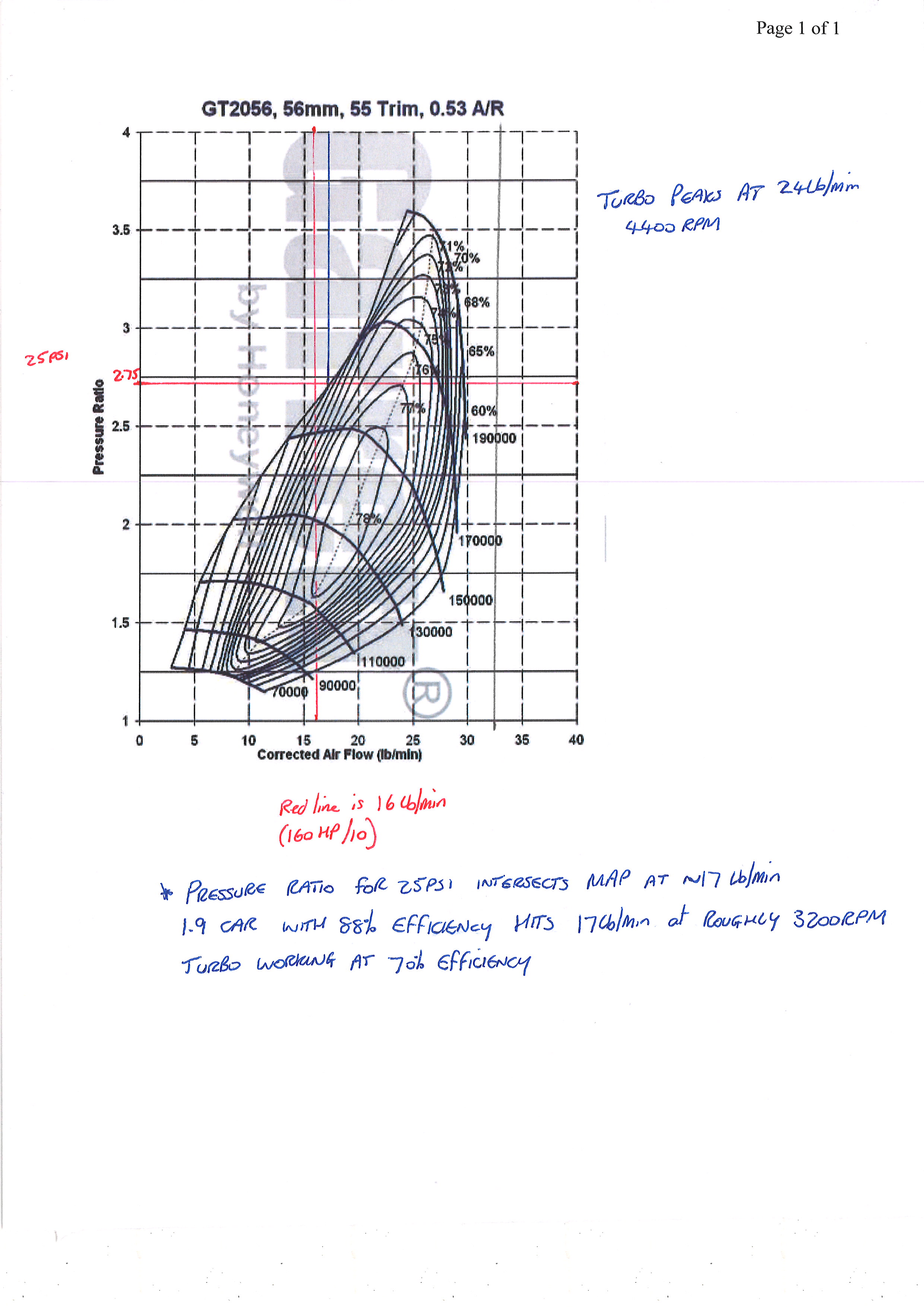

Just to hijack my own thread- got a map which says its for a GT2056 so I could practice looking at it.
With a target of 160hp, the turbo needs to be able to cope with 16lb/min which this turbo can.
Boost target would be 25psi, which has a pressure ratio of 2.7. Ive marked the 2.7 with the horizontal line and this intersects the map at 17lbs/min. Am I correct in reading that that top line goes round to 70/71% efficiency for the turbo?
Using a compressor map calculator, my 1.9 engine with an efficiency of 88% can hit 17lb/min around the 3200RPM mark which im thinking isn’t too bad? Or would you say that’s a bit late?
Last thing, the turbo peaks at 24lb/min which using the calculator, the engine hits at around 4400rpm. Which to me sounds good because I wouldn’t need to take the car past 4400rpm for peak power output, is that right? Or will this just result in too many gear changes because itl be too inefficient after 4400rpm?

What's your basis for 160HP = 16lb/min? I assume this is a petrol engine calculator which is spitting that number out - your AFR is going to be significantly leaner than they would suggest, something like 17.5:1 AFR will be about your limit for stopping excessive EGTs. I'd not say that an XUD9TE is hitting 88%VE @ 4000rpm - closer to probably 85%, maybe lower frankly! With those numbers and an optimistic 0.42BSFC - the numbers are 25.2psi boost and 19.6lb/min airflow for 160HP @ 4000rpm. That makes the compressor much better suited for the numbers you're suggesting. Smile
You're still running pretty close to the surge line in honesty, but I suspect the turbine won't drive it hard enough to actually produce that pressure, you might just cross into surge on transients but I suspect your BSFC is actually higher, so you'll need more airflow again, which isn't so bad as it'll keep you away from the surge line.
Your comments about the compressor not being suitable past ~4400rpm are quite right, however, the VE% is dropping significantly at that RPM, so you just end up going down the map for the same boost pressure, which keeps you away from the danger area of overspeeds. Also you're not attempting to burn fuel up there - this is normally where the ECU would start tapering boost pressure down to avoid compressor overspeeding.
HTH.
Thanks very much for the reply!
(25-08-2017, 10:46 AM)Ruan Wrote: What's your basis for 160HP = 16lb/min? I assume this is a petrol engine calculator which is spitting that number out - your AFR is going to be significantly leaner than they would suggest, something like 17.5:1 AFR will be about your limit for stopping excessive EGTs.
The basis was sadly just a page saying it was roughly 1lb/min for 10hp, didn't need to use any figures for AFR or BSFC in the whole calculation so il keep that in mind when calculating it in the future.
