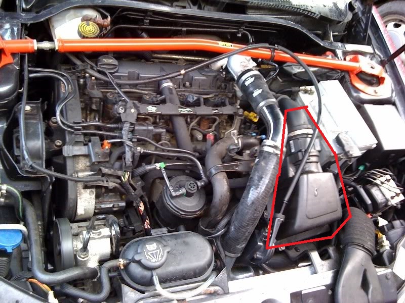

Also it doesn't have a maf sensor fitted!
Does anyone know how you go about fitting these? i.e where they plug in, where they need to be situated etc
Get a photo up of your engine bay
Guessing your intercooler pipes go right where the airbox used to be so it never got fitted back on.
Would be looking to rectify that pretty sharpish
MAF is connected just after the box
photo for reference that intercooler pipe work will work with the standard airbox (stolen from google)
(16-08-2017, 10:27 AM)mr_fish Wrote: Get a photo up of your engine bay
My intercooler is a twin pass, so where yours has the one pipe going across to the back of the bay, mine has two, one of which passes directly over the empty air intake pipe!
I have a k&n cone that came with the car and various pipes/clamps, so i'm going to have a go at squeezing it in tonight.
I shall take a photo, hopefully a before and after success shot!
Okay, so some good and bad news!
Bad news, I couldn't make the parts I have work, so i'm going to have to come up with a different solution.
Good news, I found the MAF in a box of bits! So happy, just need to try and squeeze it all in.
Would anyone have any tips on piping to use for the job? It ideally needs to be flexible so I can run it under the intercooler pipework.
What about reinforced silicone tube- http://m.ebay.com/itm/290617583418?_mwBanner=1
Or Polylock stainless- https://www.ebay.co.uk/i/252161026223?ch...5910065768
Thanks Uberderv, that looks exactly what I need!
Should I connect the maf directly after the cone, or do cone, bit of pipe, maf, bit of pipe to inlet?
I'd definitely put a flexible section between the MAF and inlet to reduce vibrations. Where do you plan on attaching the cone?
Well, i need to route the flexible pipe under the intercooler pipework and position the cone at the front of the engine bay just after the radiator.
There really isn't another place for it.....
I shall take a picture of my engine bay tomorrow and try and post it here.

(18-08-2017, 06:18 AM)Poodle Wrote: Making great progress with this. Sounds like the previous owner was a bit of a liability lol, good job you like a challenge!
As above for the filter, leaves so much room. Don't buy a relocation kit though, buy some welding earth wire (35mm2), a battery box and some terminals, it'll be half the price.
Haha! Thanks mate! Every time I go to do something on it, another thing rears it's ugly head!
I like the idea of relocating the battery, my lack of electrical experience makes me slightly apprehensive though.
I've had a look at some posts on here from people who've done it but i'm none the wiser.
Any chance you can give me some pointers and a bit more detail about how to go about it please?
It's quite straight forward mate. Get y'sen a good sturdy battery box and bolt it down in the boot, reinforce if necessary as you don't want it going airborne in a crash. Buy some thick welding cable, roughly measure out and add maybe 1/1.5m on it because all those twists and turns soon use it up.
Route the cable through the car making sure it's not going to chafe on anything. Purchase a box which you can terminate the cable in, I think they are called a shunt box, this is where you can connect to the original cable without the danger of shorting it.
 Now stick your battery in the new box, secure it down. Remove the original box from under the bonnet making any brackets required to hold the ECU etc..... secure the shunt box and connect the original positive/new cable inside it. Connect the earth to a point on the chassis. Now from your left over cable make an earth lead and attach it to a good point close to the new battery location. Connect the earth up,  connect the positive and away you go Smile
 Fitting some sort of fuse or breaker close to the battery on the positive might be wise too. Hope that helps a bit.
