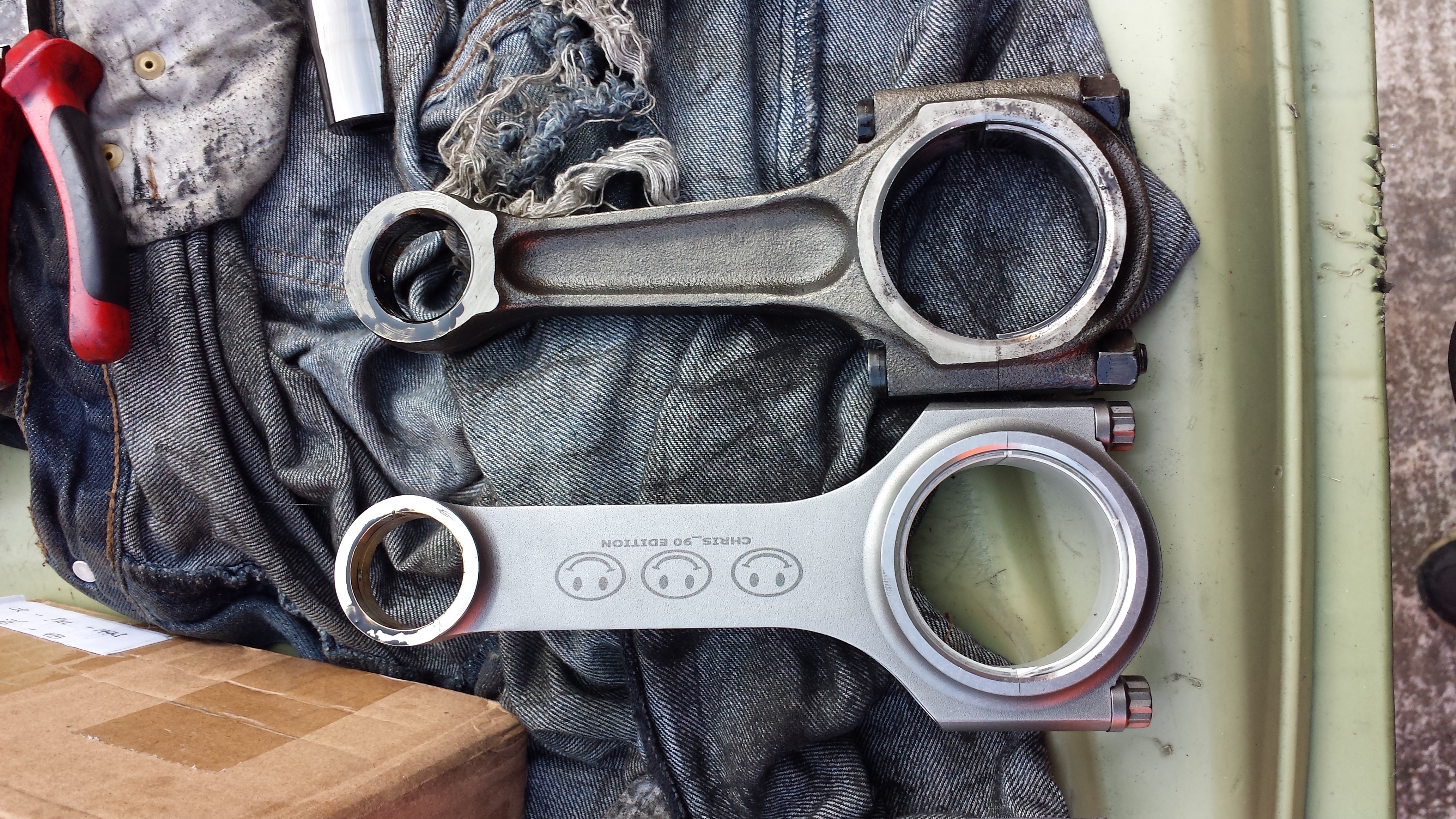

those rods are awesome! shame nobody will ever see them really

Well had an hour and half on just attempting to remove sump bolts, really regretting not taking the engine out now caused my self a hell of Alot of work! So I've now gotta pull the alternator/pas pump bracket off to get the sump off by time I'm done I could proably lift the engine out!

Chris, did you have a set of these rods a few years back and sell them? If so, I think they're in my 205.
#66
Yer I did and yer there in your 205 I remember selling them to james.

A little update, stripped the cylinder head ready for a skim and pressure test. Also manged to pull the bits off the engine needed to get the sump off and pulled off the oil pump and got the first piston/ rod out.
#70
Manged to fit all 4 rods, dropped the head off to be skimmed and pressure tested. All come back good so this morning I rebuilt the head.
