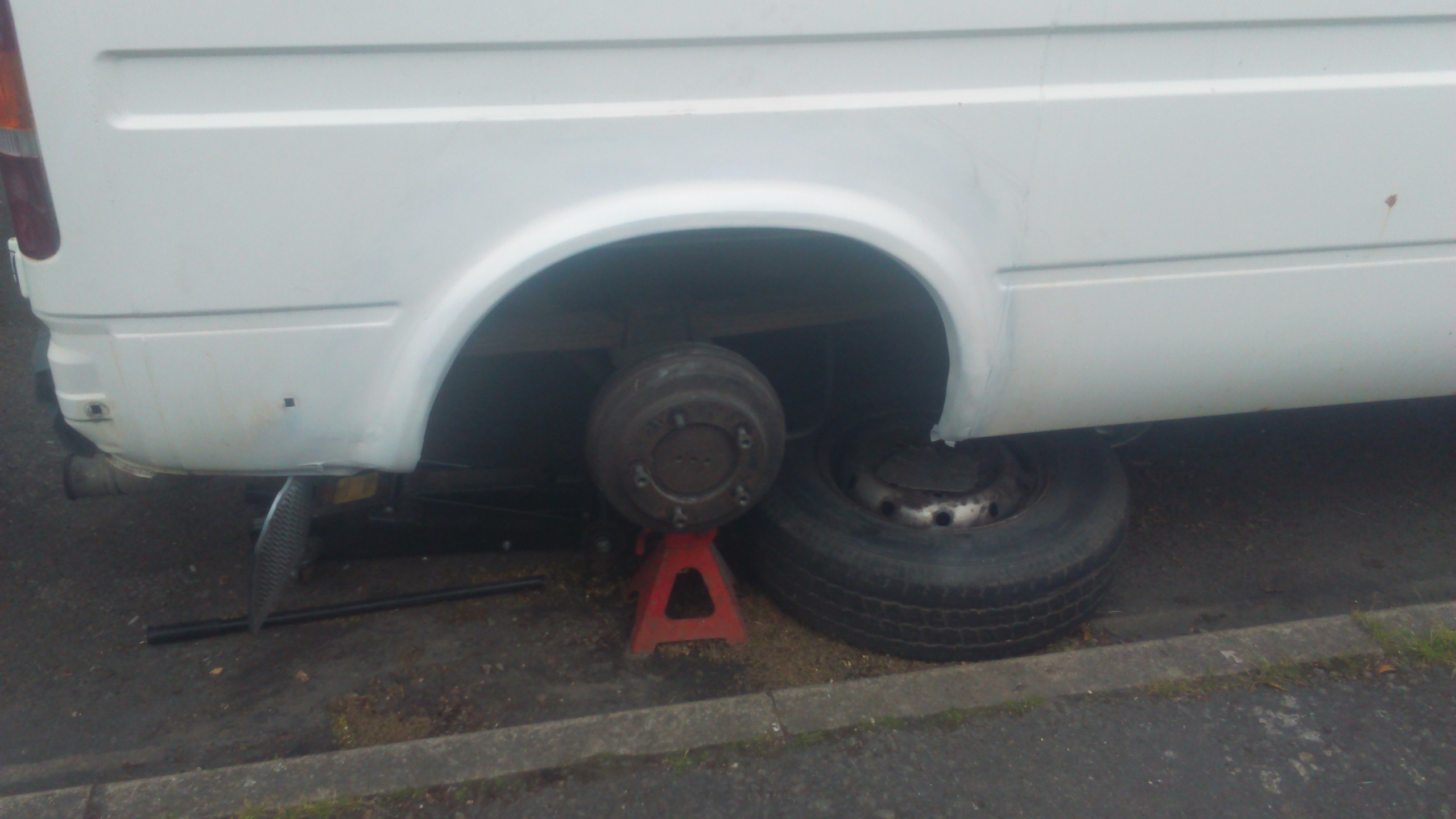

You know I love Transits, and mechanical injection.  And boost
Mk5 Transit, 68K, one owner electricians van. £150.
I intend to own this van for as long as I need a van.

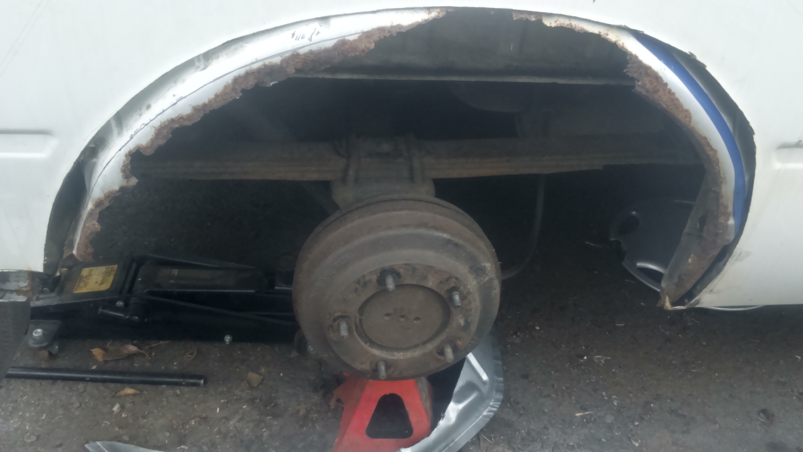

Thought I'd make a start on the back arch on the same side as it doesn't look as bad as the others.
[Image: post-19867-0-24068600-1488815801.jpg]
[Image: post-19867-0-74997700-1488815843.jpg]

Rear arch repair panels turned up today. Have a three day weekend as well.
