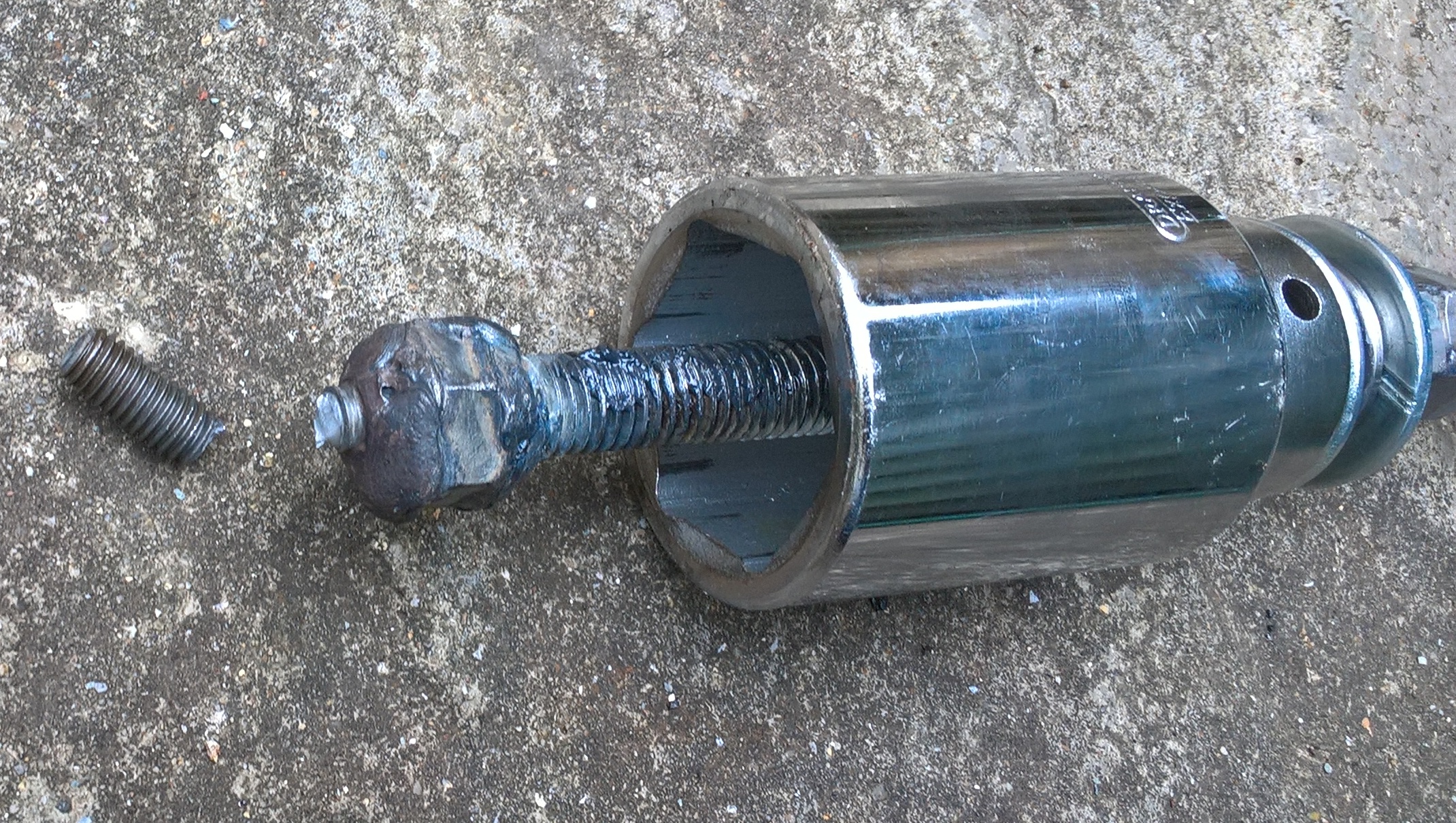

Unsurprisingly, the torsion bars on my knackered rear beam are refusing to give up easily.  Have now broken two home-made pullers made of a high tensile (10.9 grade) M8 bolt welded to some M12 threaded bar.  The M8 bolt ended up snapping.  Am surprised that my messy welding held out!
I was thinking about applying some heat to help free them.  Good idea or not as I assume the torsion bars have been very specifically heat treated in manufacture?  If it's OK I only have a plumbers torch - would that put enough heat in to it?
Cheers.

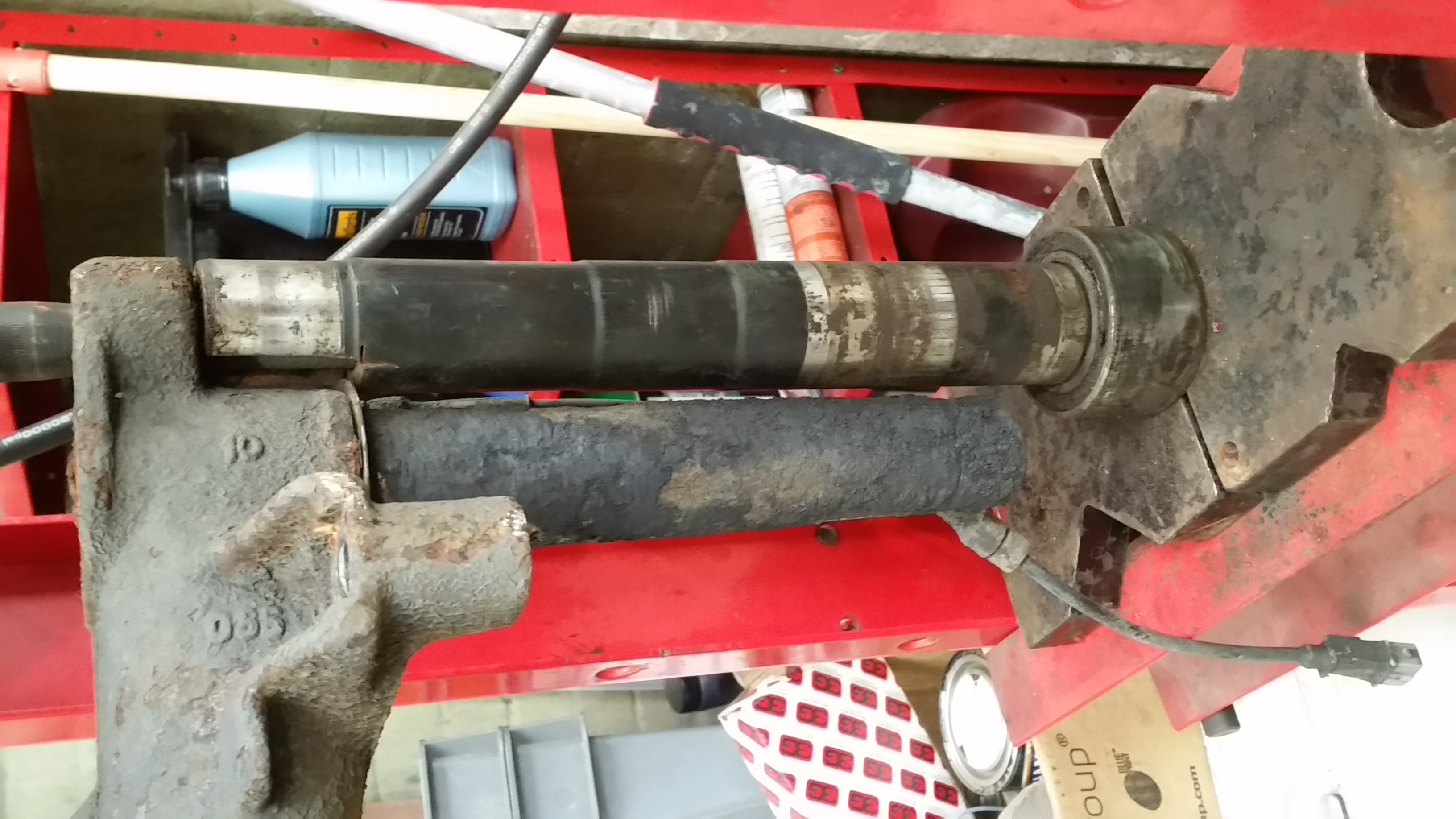

I borrowed a 20 ton press in a lorry maintenance unit. That did the trick!
