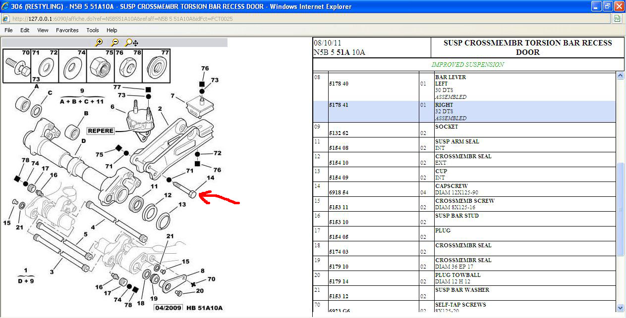

Hey guys.  I recently replaced the beam mounts on one of my cars without dropping the beam fully from the car.  When I was knocking out the bolts that hold the beam, crossmember & front mount together I think I damaged the threads on one of them.  When re-tightening didn't get anywhere near torque spec n it was just spinning.  Cursed a lot n then went looking for an M12 x 1.25 x 90mm threaded bolt online.  No luck & even called some specialist suppliers of fixings.  Thought, OK, Peugeot it is.  They told me they don't supply them any more.  They can supply the deep M12 x 1.25 nuts though .....at £10 a pop Confused .
It's this one ....
Finally bought some 10.9 M12 x 1.5 bolts & deep locking nuts (fine rather than extra fine thread & not zinc plated as no one seemed to be able to supply them).  Have 2 questions ....
1) Was my local dealer lying to me?
2) Should I have any concern the bolts aren't original spec?  (Apparently the finer the thread the less likely it is to self-loosen & I can see why you wouldn't want those to self-loosen!!!).  I used some thread lock on them to be safe
Thanks guys.
1- probably.
2- wouldn't concern me if they are still high tensile and nylocs.

1 - Cynic or realist?!!
2 - Thanks, your opinion is much valued & reassuring.  Yes, used 10.9 bolts (vs 8.8 originals) & nyloc nuts BUT even though used standard depth (type P nuts) these are not as deep as the originals.  Hence why added threadlock on top of self-locking.  Did check that the combo I used were more than capable of taking the required torque spec.
