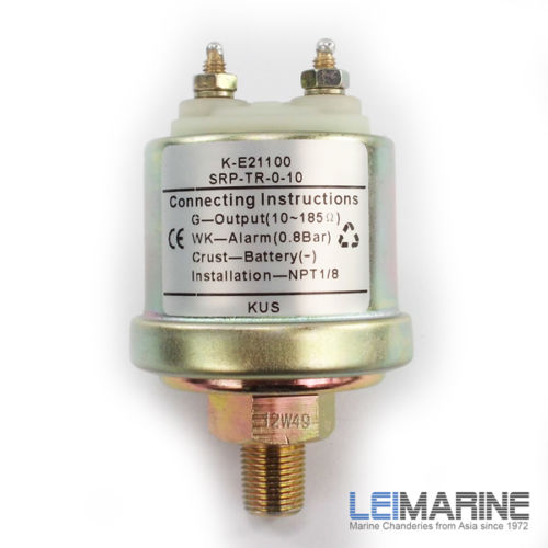

LMAO at the Chinese translation CRUST - Battery negative
crust = ground

you wont read it with a 10 bar sensor thats for sure
most caps vent at 1 bar

I just used a generic pic as example. however, thank you for your feedback. most helpful.

(07-04-2017, 01:21 PM)cully Wrote: you wont read it with a 10 bar sensor thats for sure
label in pic reads 10-185 ohms

KUS pressure transmitter / oil pressure gauge
  • Type: SRP-TR-0-10.
  • Pressure range: 0-10bar
  • Thread: NPT 1/8 "
  • Rated voltage: 6-24Volt
  • Resistance range: 10-184 Ohm
  • Free, ie the encoder requires a ground connection, ground is not dissipated via the housing
  • Dimensions without connection: approx. 60mm x 46mm (length x width)

I do agree with cully, its like those little pressure gauges on the leccy compressors you get from the AA.. goes up to 30-psi with divisions every 20, useless for trying to get 35psi./.
now a 0-3bar one would be a good shout, possibly even a 0-2bar one.. if you can find one

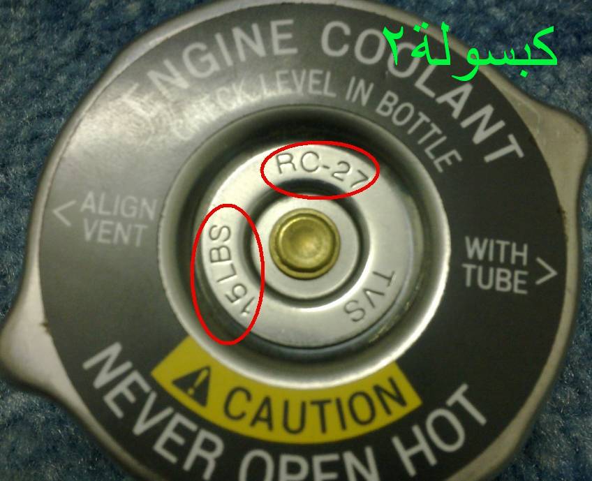

Interesting pic Magenta - I was always under the impression that older cars ran at 12-15 psi under normal driving conditions - as I posted on your other thread .
naah, peugeot have run the td engines and bigger petrols at 1.4 since early 80's.
bmw have run them at 2 bar for years.
