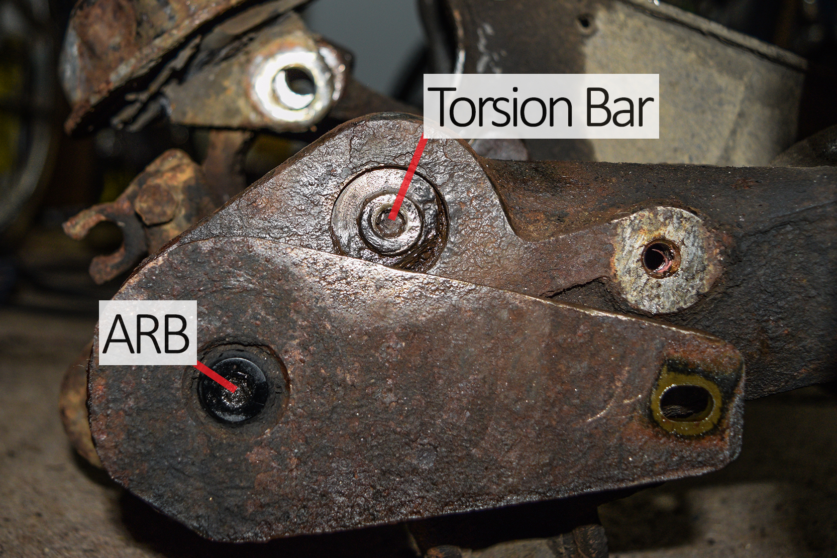

Because I haven't got the beam on the car I'm struggling to remove the bolt here as it catches on the arm
And I don't know how to remove the ARB plates to get the beam apart.

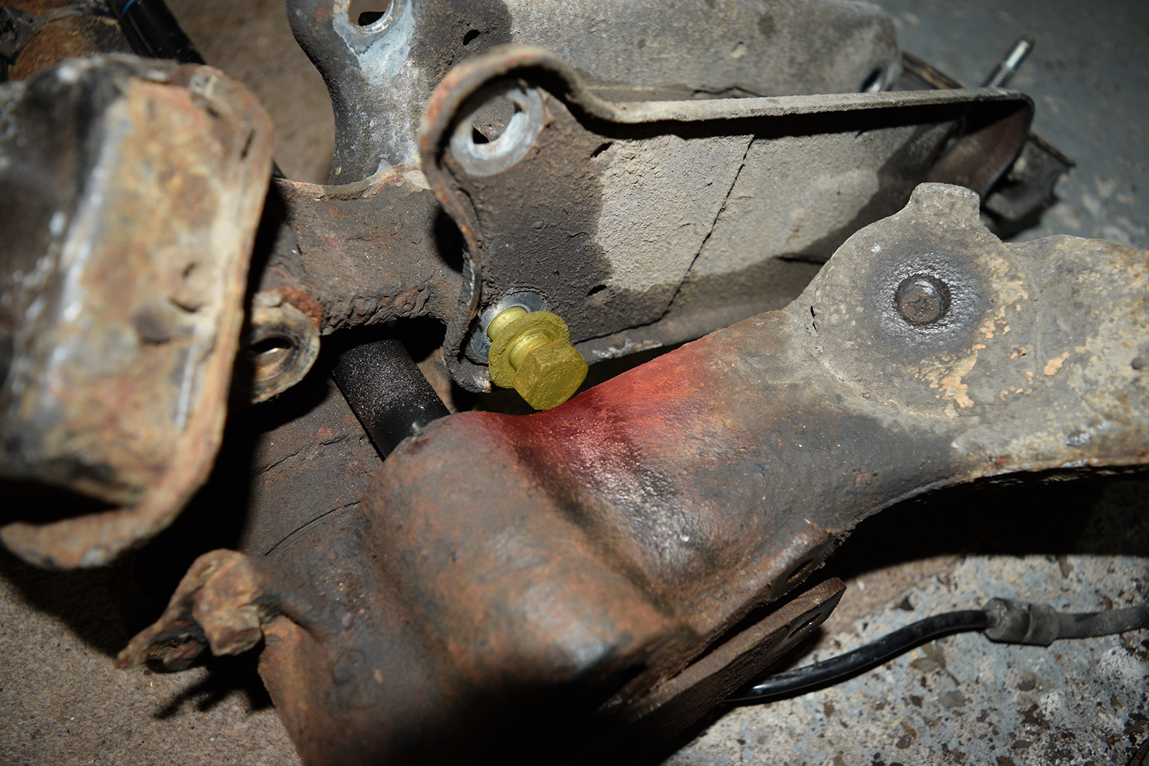

to remove the arb you need to wind out the plastic plug on the right hand side, wind in an m12x1.5 bolt which will push the end plate off the arb, grab hold of the other end and pull the arb out, leave the left side lever on the roll bar.
the plastic plugs are often very stubborn so you'll end up destroying them, cheap enough to get new though from a dealer.

plug needs to come out as you'll be winding a bolt in there.
it MUST be the correct thread.

I looked at your guide again and it makes sense so I'm pulling the ARB through one plate and leaving the plate on the other end, that's okay I can get the plastic cap out it'll be a pig but its still possible ahah
M12 is the size/width?
1.5 is the thread size right?

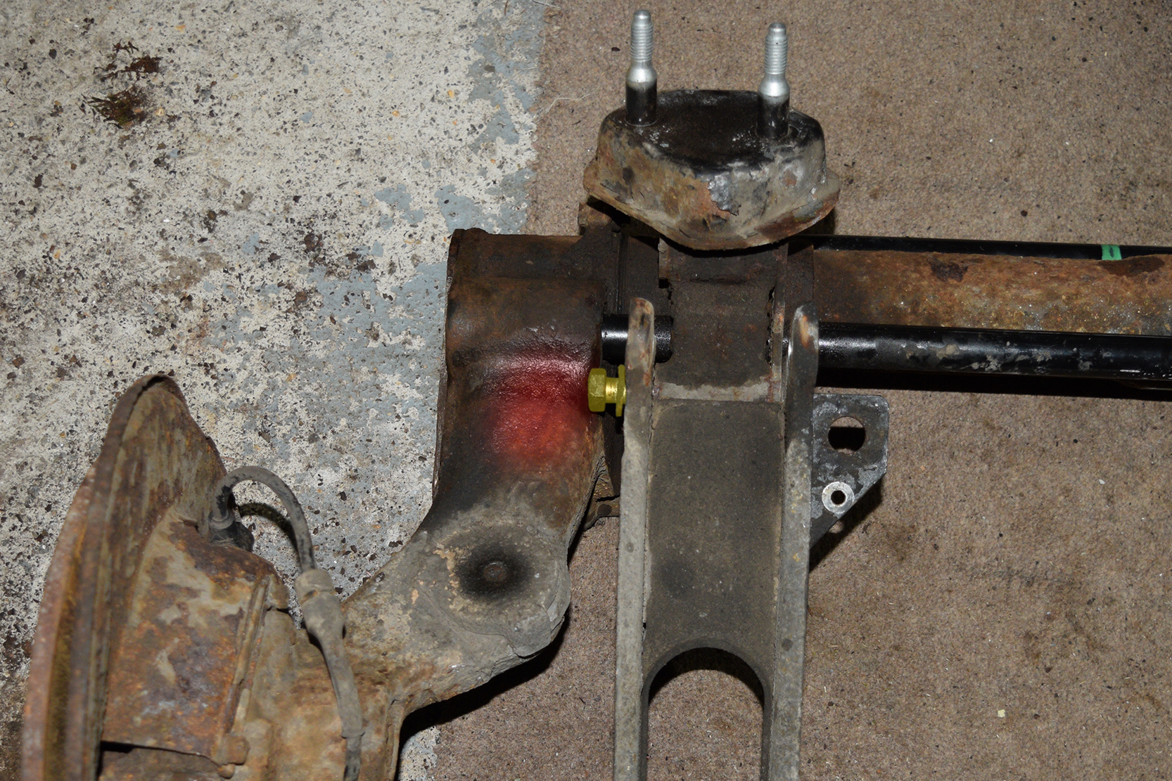

As others have said it is certainly worth changing all the seals and washers etc when taking the beam apart if the bearing etc are all ok. Only issue you will find it that buying from peugeot you''ll have to buy them in bags and that can be 4s/5s or sometime 10s. I do have a few seals etc so if you do want any give me a shout.
I tend to use either an xud head bolt or front brake carrier bolt to get the anti roll bar plates off. That bolt you're struggling to get out can usually be bit of a pain especially when the beam has been lowered.

I've bought a bolt (M12x1.5 as said above) to wind it out I don't think the beams been lowered, although I couldn't tell you as it's the only beam I've seen so have no point of reference ahah

The beam is sorta stuck on the left hand side, the ARB plate/ Beam seem to have rusted themselves together but I got it rotated a bit so it'll come out with brute force and a good whack. On the side of the beam with the plate I've pulled off the ARB splines are clean and the inside of the trailing arm seems in pretty good condition so the seal did it's job although suicidally ahha.
