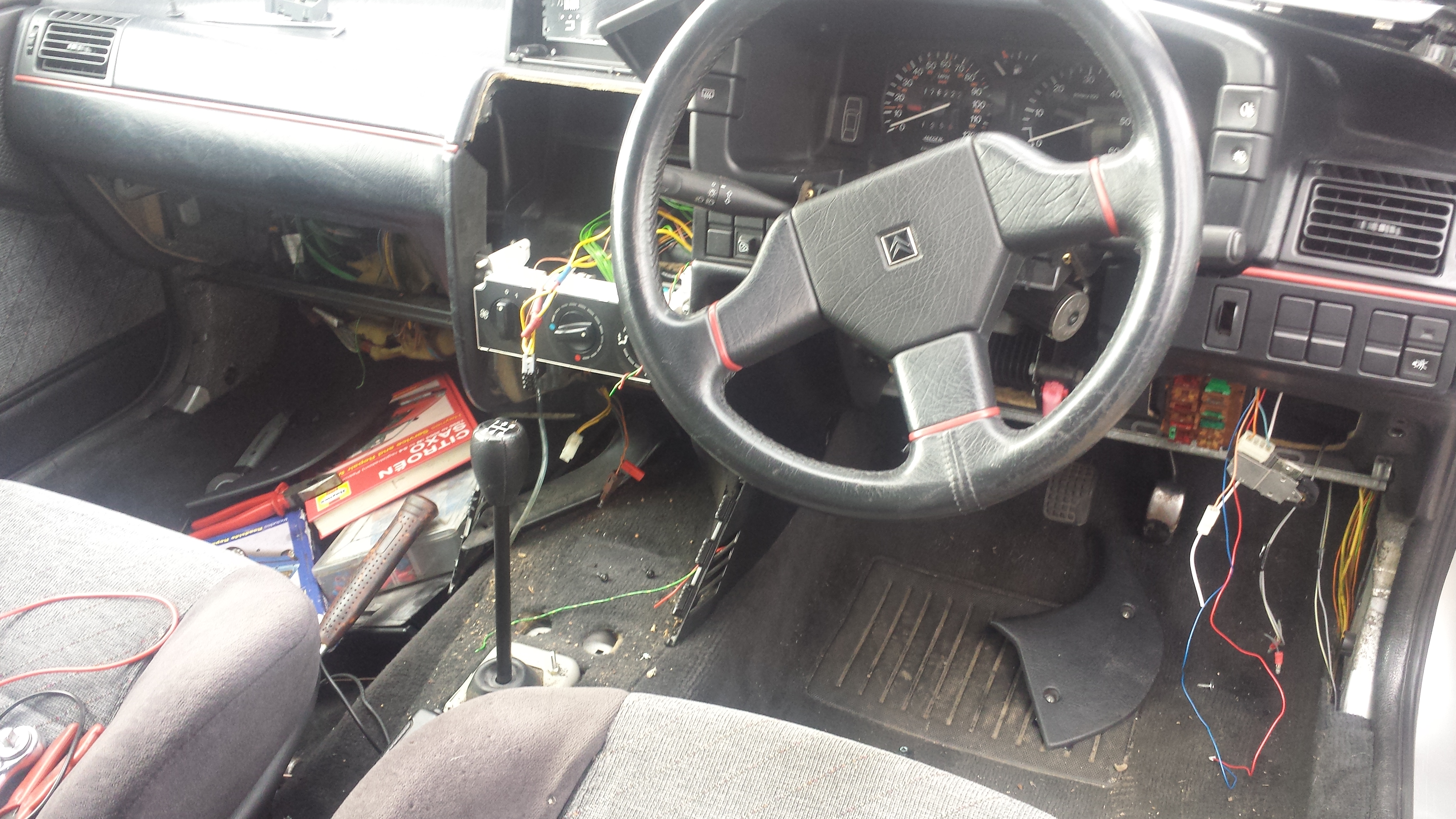

I've been doing some work on it today, looking at the central locking, I found some after market wiring but no control box, so I looked for the central locking module but it was missing, wipped the one off my saxo fitted that and it was just clicking but not doing the locking so I chased the wires back abit to find they had been cut to attach to the after market wiring, so reconnected them and hey presto working central locking Big Grin so I just need to find a control module for it (so I can put the saxo one back) and that's one job off the list.
I have ordered a ir remote and matching receiver so hopefully I can get it working by remote. Also ordered a brand new genuine towing eye cover.

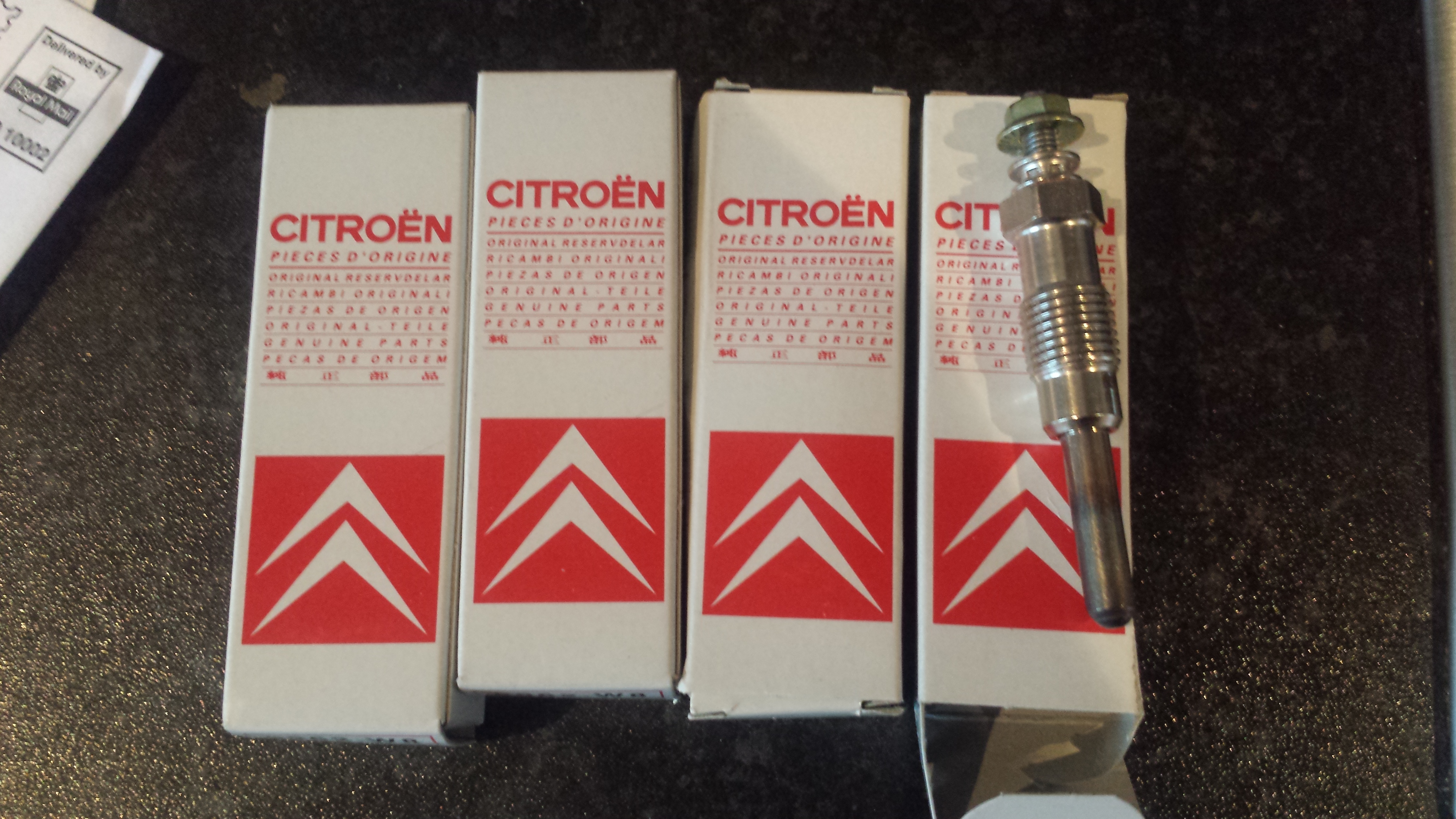

Genuine Peugeot glow plugs

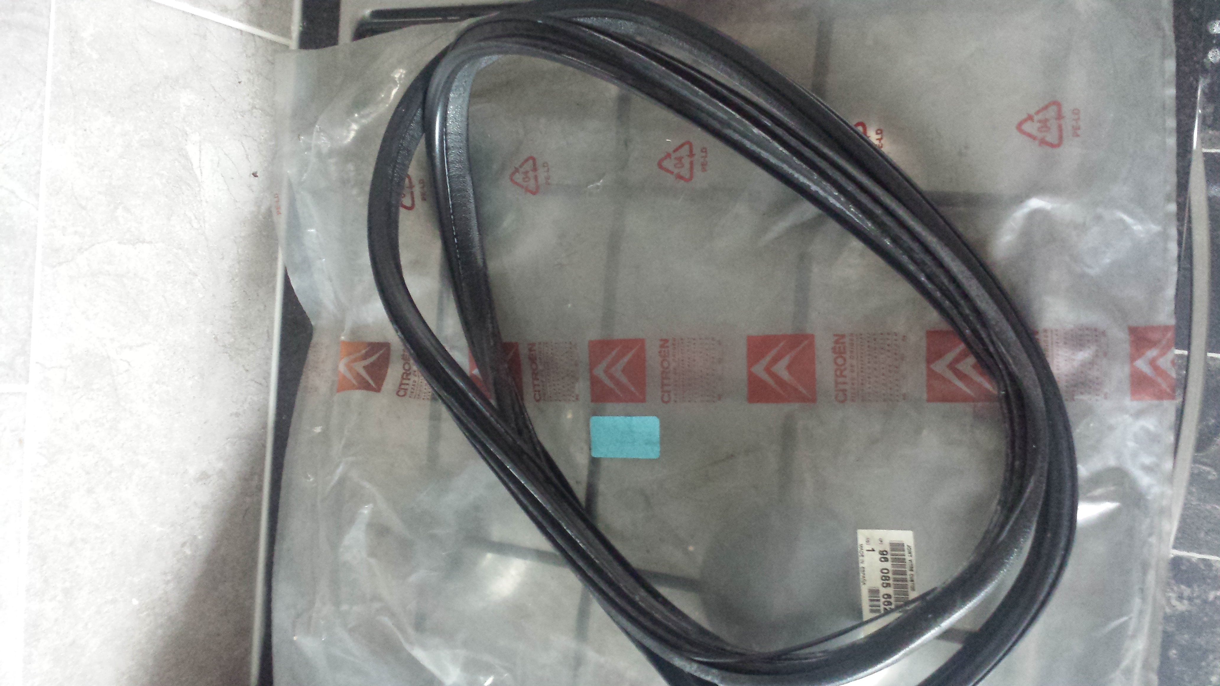

1 genuine rear window seal (need to find another)
Today my central locking module turned up so I fitted that and refitted the hand brake cover/plastics.

So new genuine glow plugs a rear window seal, I need to find another rear window seal if any one knows were I can get one from? I fitted the rear window seal and tested it make sure it was water tight now and it is (drivers side) tested passanger side with hose pipe and it's leaking a small amount.
The new remote central locking ir receiver and remote turned up fitted the receiver and went to try it and the battery's are flat in the remote so gonna have to get some from the shop some time soon.

Also fitted the new glow plugs and a new thermostat. The fuel pump arrived back from darren I've filled it full with diesel and it's sat in the car waiting to be fitted.

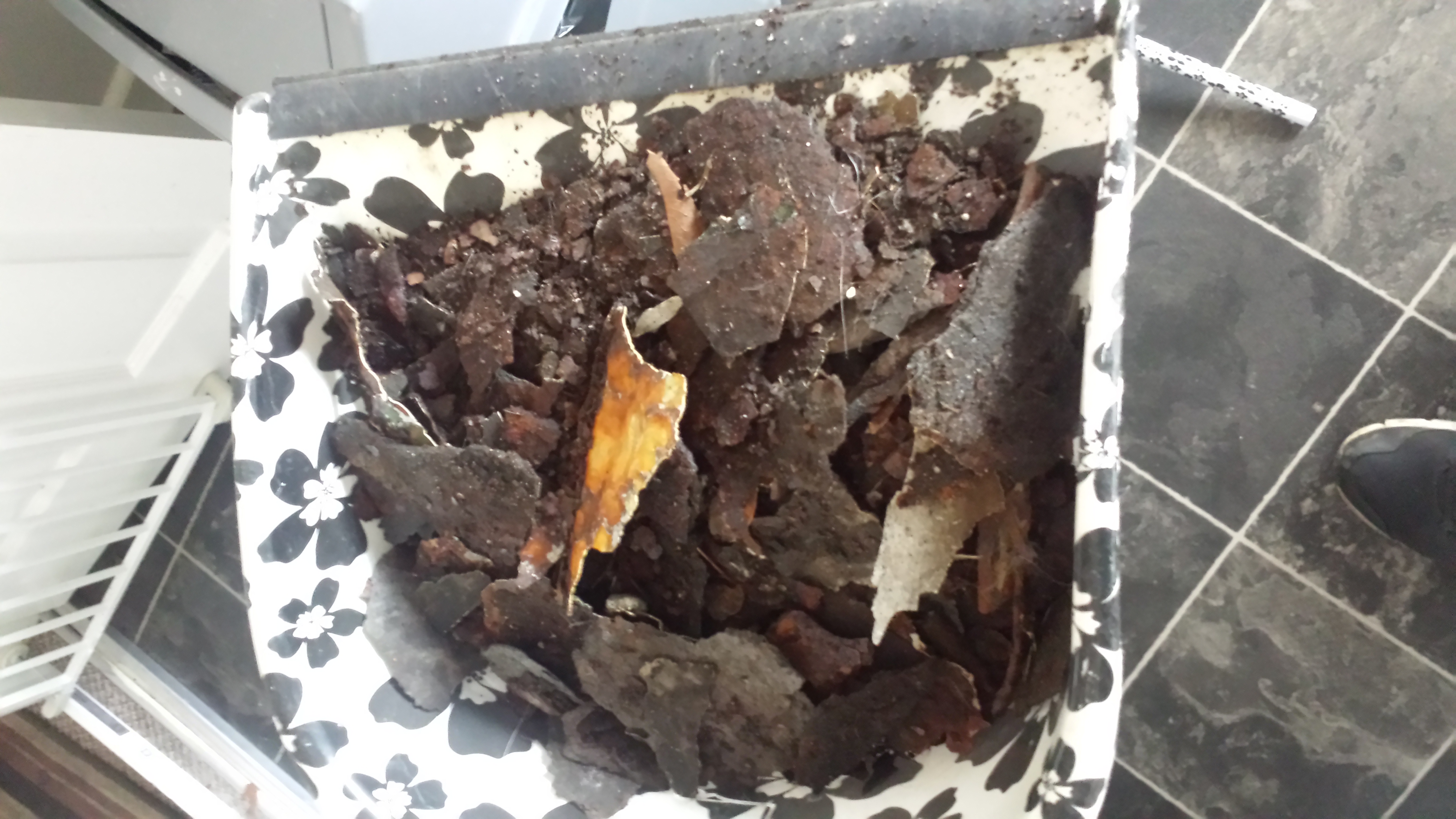

Then I attempted to get the passanger sill cover back on now there all soild again.

Spent several hours trying to remove this, what an utter ball ache! Not doing one of them again with an engine in the way, but got there in the end, fitted the soild gear linkages to I'm amazed at the difference nice and soild now, just waiting for my quick shift to arrive and I'll get that on.
