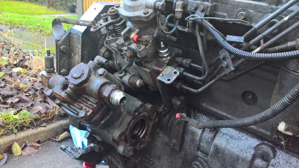

I removed the red security thingamy on the max fuel screw, removed a bracket from the air compressor and then moved the bosch VE rear bracket, removed the hydraulic pump and FITTED THE 12V STOP SOLENOID!!!

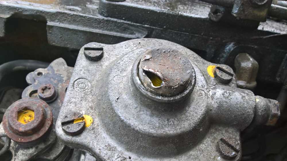

I then attacked the LDA and got the security cover off that. Sadly the actual screws put up alot more of a fight than the security cover did and I can't budge them so gonna blast them with plus gas and leave them for a while.
I also removed most of the oil filler tube (need a 1 1/4" core plug to blank it properly) as it's gotta go so I can fit my engine mounts. I'm gonna buy a rocker cover with an oil filler in it. I also cleaned off some dirt to uncover the rear dipstick hole so I can use that when I flip the sump. I need to get an 18mm spanner as my 17mm is just too small to go over the air compressor bolts or the bolts on the drive shaft and 19mm is huge. I'm a little worried that they are actually gonna be 11/16ths but there's only one way to find out LOL.
I often use a small pair of vicegrips aswell as screwdriver on a socket on those lda bolts... Swiftly replaced with m6 bolts lol

(14-12-2016, 12:07 AM)Piggy Wrote: I often use a small pair of vicegrips aswell as screwdriver on a socket on those lda bolts... Swiftly replaced with m6 bolts lol
I was using a big adjustable on the square shaft of the driver and the screwdriver was just trying to climb out of the groove.
Going to try a screwdriver bit in a ratchet.

Yeah the flat blade always does I've found...maybe the bosch gurus have a better way... But I've always used a fixed head 3/8 with a flat blade socket on it, then a set of small vicegrips on the head of the machine screw itself (not the socket or screwdriver) and apply force on both.
Ive seen people use little impact wrenches (smack with a hammer) but I'd be worried about breaking the housing
Yeah Piggy that's my worry too, don't want to strip the thread out the ally (assuming steel screws into ally have fused with dissimilar metal corrosion) or worse crack the whole top of the pump. Gonna give Plus Gas a chance and the ratchet. I like the idea of helping the head with the grips though.
Hammer and pin punch to crack them?

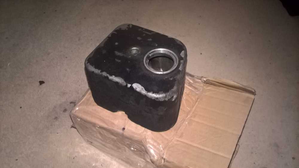

More bits have come in the post, now got an oil filler as the standard Daf45 location will be blocked by the engine mounts I plan to use. Also have the appropriate core plug to block the original oil filler.

So hard to get a sense of scale from that photo!
Could be like anything from 1 inch to 1 foot, great skills!
(03-01-2017, 12:15 PM)tigerstyle Wrote: So hard to get a sense of scale from that photo!
I suppose it is LOL. It's a rocker cover to replace one of my 6, the base is about A6 size by about 3" high.
Ahhhh I thought it was the core plug
(a very weird looking one!)
I like the cryptic photography! Keep us guessing Smile
