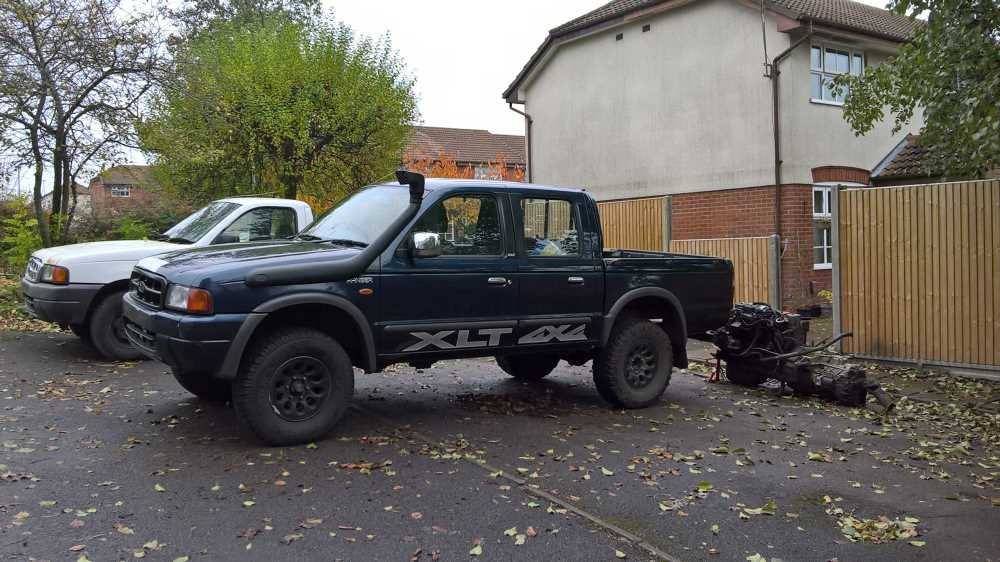

29-10-2016, 08:53 PM
looking great DUM DUM, Are you changing the tyres?

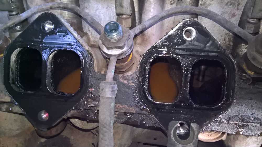

Well I've definitely popped the head gasket.
Heaters went cold, looked down and the temp was at the top of the gauge, wasn't going to stop on the inside lane of the A41 which at that point has little to no grass verge on the inside of a blind corner in dark and thick fog. Coasted off at the next junction was under half a mile. Let her cool, topped up the coolant and started it, it was rough as hell and the exhaust had started pouring white smoke. Defo head gasket, if you start it with the rad cap off all the coolant is instantly pushed out the top of the rad. Just a question now of if the HG caused the coolant block symptoms or if the coolant block caused the overheat which popped the head gasket.

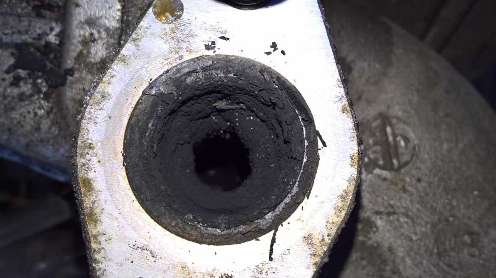

Started taking my truck apart and found quite how clogged my EGR system was Also found out that I have definitely cracked my head. Yup, that's coolant in the inlet to cylinder 2! And while it was apart I decided I'd clean out the inlet manifold. I used Mr Muscle oven cleaner, it does a nice job and the foam expands to fill the inside of the manifold. One can did the manifold twice but I wish I'd bought 2 cans to fill it 4 times. I'm finishing taking the head off this morning as I had to pop out for a new socket for the injectors last night. Just need the injectors out the way and I can undo the 18, 12 sided head bolts.

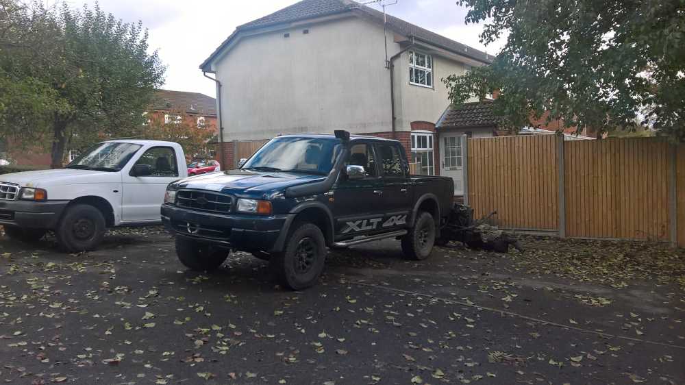

Well another 4 hours on the truck today and she's back together and running!!!!!
(sort of) It's leaking diesel from one of the injector lines at the pump, I hope it's cylinder 1 or 2 as getting to the other lines is a pain in the arse. I assume this is the reason for the slight rough running. It's also smoking slightly once it started warming up a little, I assume it was burning off any coolant left in the exhaust. I didn't let it get up to temp, I shut it off after noticing the diesel leak but it has moved under it's own power, even if it was only far enough to turn it round.

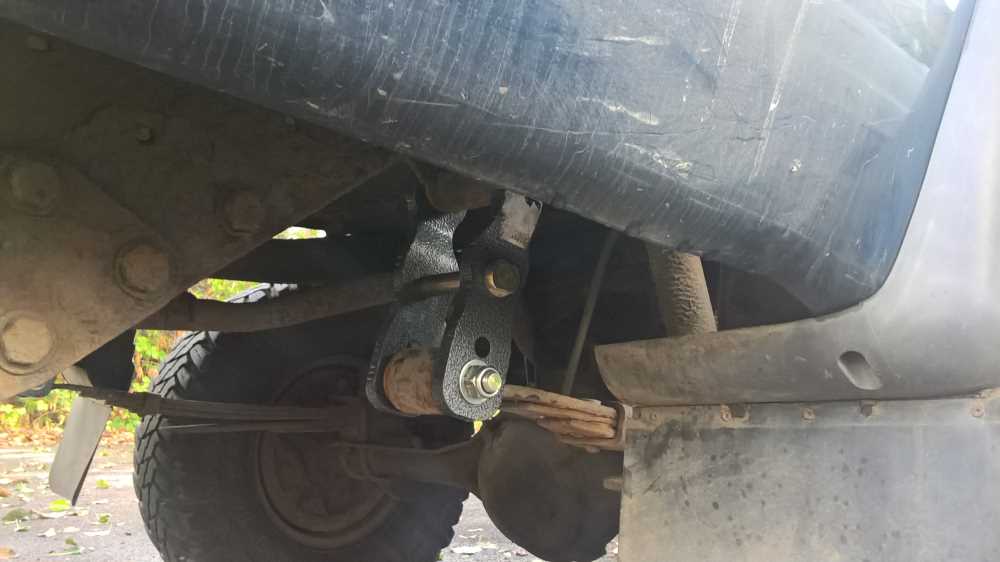

I got a glow plug stuck in the old head, couldn't afford a full set so I have a single bosch duraterm on cylinder 2. I will change them all at some point. Whipped the spare wheel off, it's barely legal and gets in the way offroading but it's gone in the pile for the drift truck. Fitted my longer rear shackles (bottom right) which was good as whoever had previously fitted new shackles with P bushes has an entirely different opinion of what tight is to me, the only reasons the nuts didn't come off was the amount of muck and corrosion in the threads. New ones are on and sufficiently tight. And here is the truck on 31" tyres (standard works out at 28") with 50mm of lift at the rear and 60mm lift at the front. Body lift and 32" tyres when I can afford it. And a side shot. Side steps are coming off tomorrow or tuesday
