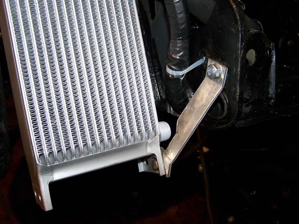

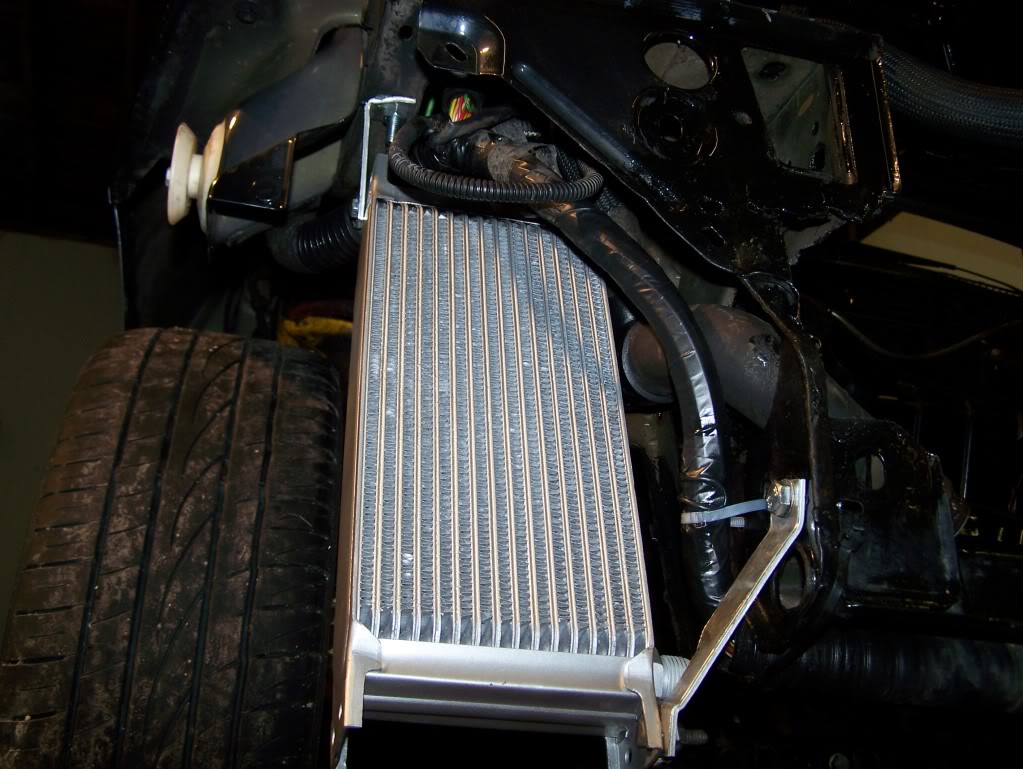

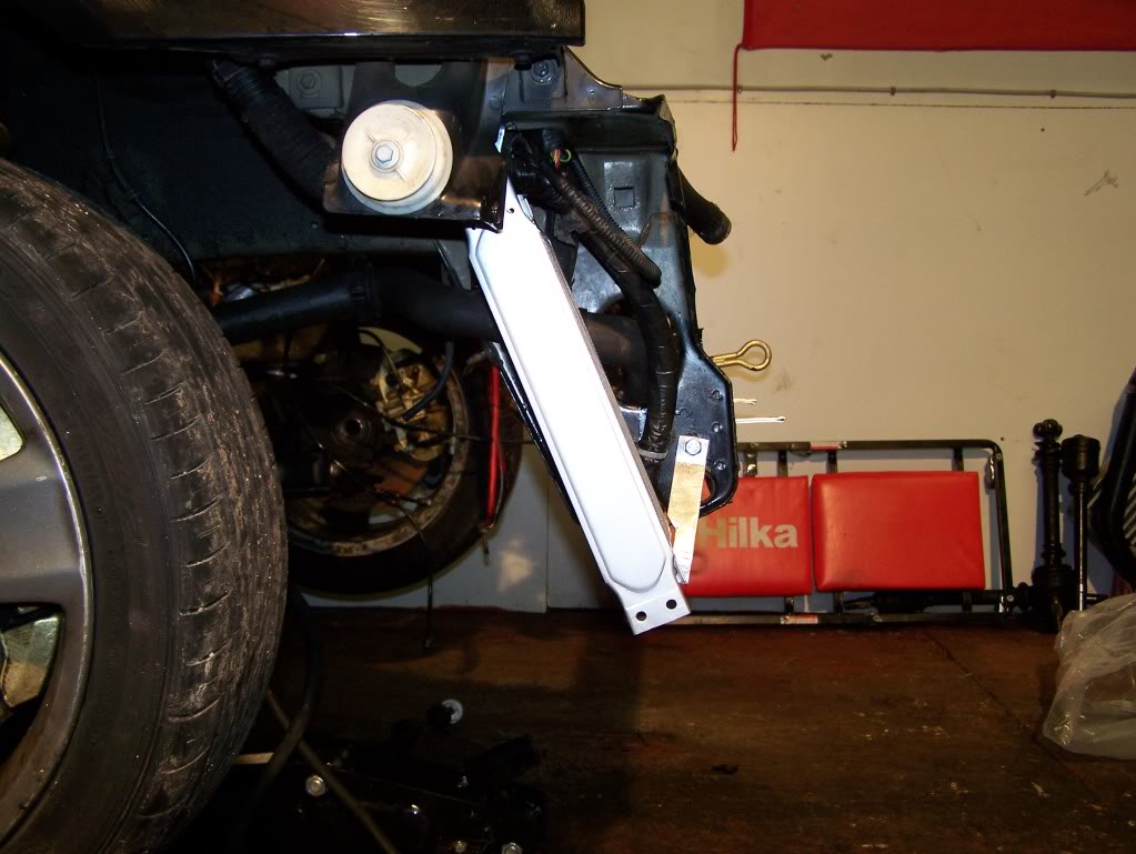

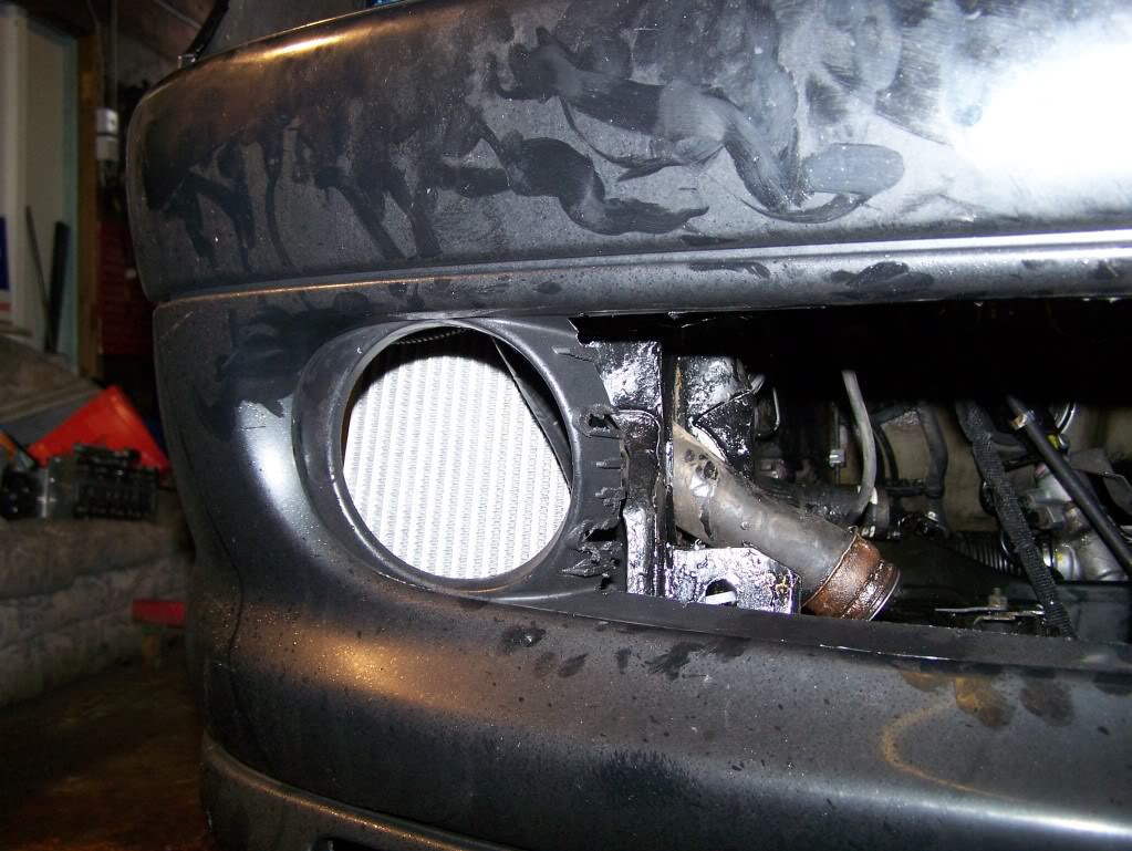

I'd use a mocal oil cooler behind one of the fog lights (with the fog light removed).
Possibly something like this.
